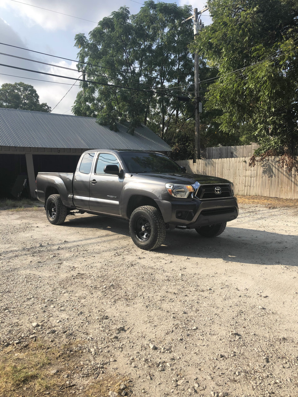

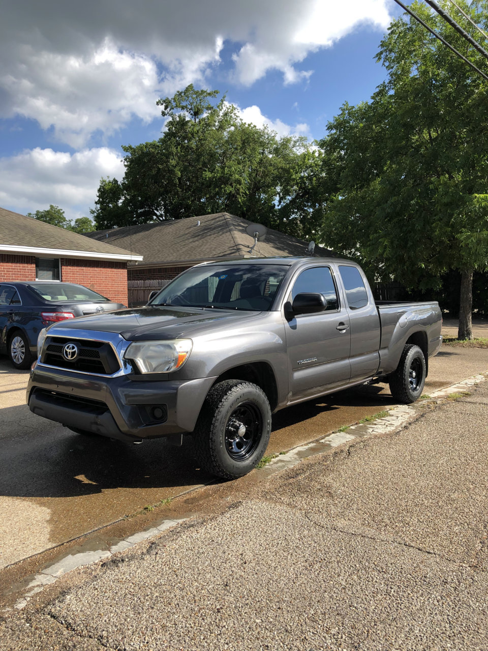

    The old tires (first picture) were 215/75/15 General Grabber AT2's.

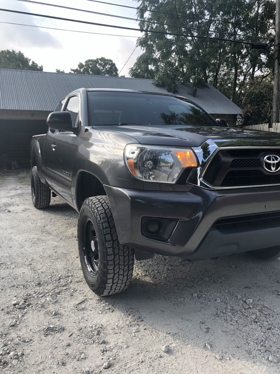

    The new tires are 235/75/15 Cooper Discoverer AT3's.
    I could have gone slightly larger on the tires, but i'm very happy with the look of the truck.
    Let me know what you think.
    ^without the lift on the old tires.
    ^After the lift with the new tires
    ^after the lift with the new tires
