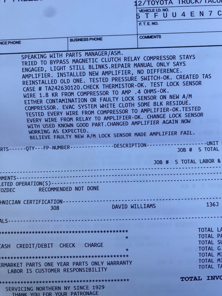

    update : you can read mechanics findings. All is working once again.
    Dm93 likes this.

    Shame the dealer techs don't even know how the system works and what does/doesn't cause the flashing light.
    If they would have an oscilloscope and know how to use it they could have figured out the lock sensor was bad in a few minutes instead of hours of swaptronics and poking with a meter.
