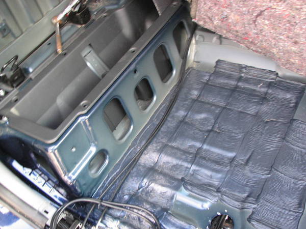

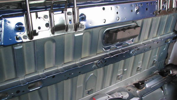

    That's not true. The vent is accessible by removing the rear wall upholstery. No tools required, just pull all the plastic pieces covering the baby seat anchors and then give a good yank.
    You don't need to do anything with the headliner. Although if you want access to it from outside the cabin, you will need to get between the box and the cab somehow.
    One of the main culprits in my mind is the storage bins. There isn't much insulation or baffling there. Just for grins pull the storage bins out once and go for a ride - it will be much louder. At a minimum, you could stuff some carpet padding in there - although the Raamat/ensolite treatment would probably yield superior results.

    Monkeyboy, Thanks for the photos and explanation regarding obtaining access to the Tacoma AC rear cabin vent. I fully agree removing the rear storage bin plastic parts would increase the noise inside the cabin. It is difficult to understand any airflow effect thru or in the rear storage bins or console could create the acoustics I'm experiencing. The airflow noise seems to come more from the upper part of the cabin near the rear shoulder belt openings or tops of the doors. The sliding window does not seem to be a factor. There is a difference between road noise and the apparent intruding airflow (wind) noise that my truck exhibits. Thanks again for the post and photos. I trust your Tacoma has not exhibited this annoying characteristic.

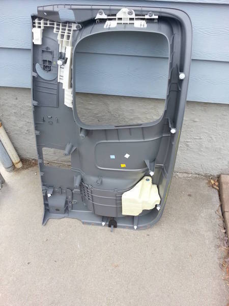

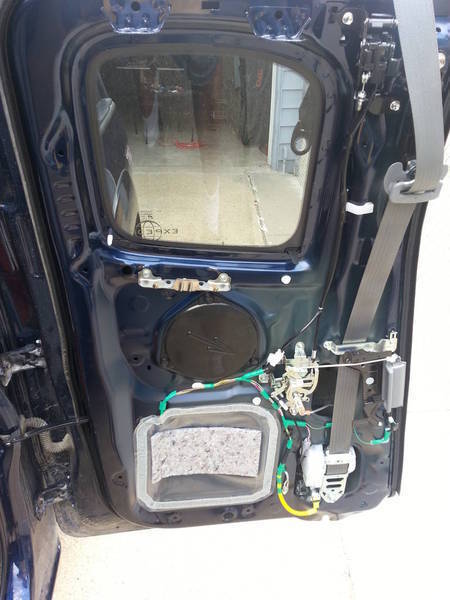

    Well, I spent the better part of my early twenties attending every concert within 300 miles, so my hearing is pretty well shot anyway. That said, I did find the AC louder than the DC I used to own.
    But yeah, the noise sounded a lot like wind noise - my pet theory is that it was caused by turbulence between the box and the cab. I dunno. Noise is a funny thing, though - consider a horn; the noise comes from one place (the opening), but is caused by vibrations from somewhere else entirely (the mouthpiece). Point I'm trying to make is that these things can be tough to nail down, and you should start with insulating or damping the easy spots and then go from there.
    That worked really well for me and was a huge improvement. I ultimately did use Raamat and ensolite on pretty much all surfaces, but the back wall and doors gave by far the biggest improvements.
    There are guides to removing the rear door panels if you google. It's not hard at all. You'll need a size 25 (or bigger, I forget offhand) torx drive, a phillips head drive and a 14mm socket/wrench. There are 3-4 bolts and screws that need to be removed and then the door panel pulls off, same as the back wall.
    The hardest part is putting it back on because the slide for the seatbelt is a bit fiddly.
    Here is the backside of the panel :
    Here is the door :
