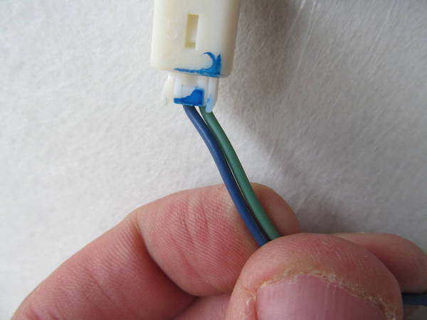

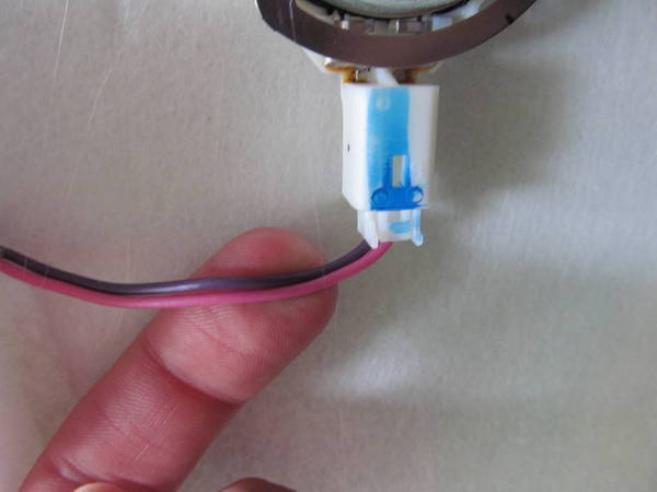

    There have been a few questions about these speakers and how difficult they might be to replace.
    This weekend I dropped the headliner to install a Thule rack and a couple of NMO antenna mounts.
    Here is what I learned in regards to the speakers :
    This is what they look like.
    Passenger side wires :
    Driver side wires :

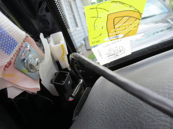

    Both of them come through the black connector in the drivers A pillar :
    That is probably the easiest point to cut them off and reroute them to the back - unless you pull the head unit itself.
