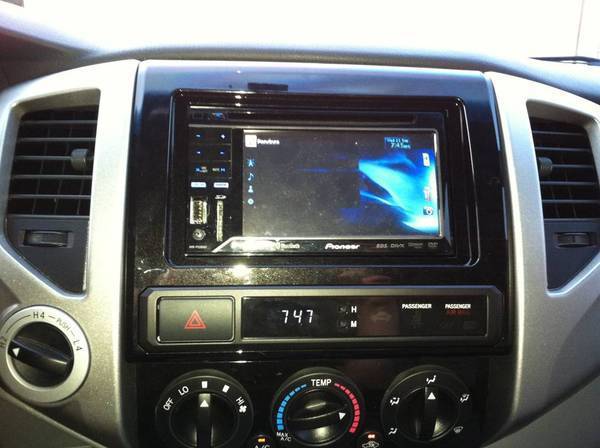

    i have the pioneer avh-3300bt i believe we sold it at my shop for $339..the kit is a metra part# 95-8235chg kit looks great and matches the charcoal gloss color same as the a/c panel!
    and the harness is a 70-1762(non-jbl) $26 or tyto-01 (with jbl)$95
    and steering interface is metra part# aswc-1 $65
    the new version is avh-x3500bhs that we sell for $339
    edit: sorry for the finger prints all on the dash forgot to wipe it down beforethe picture..
    edit 2: it made the factory speakers twice as loud!

    and yeah the volume was aweful! i drove straight home from the dealer ship the day i bought it and changed it!

    Glad to hear that the change in the head unit helped out with the volume. That install kit looks great! It matches perfectly. I was actually looking into getting the avh-x3500bhs for my truck.
