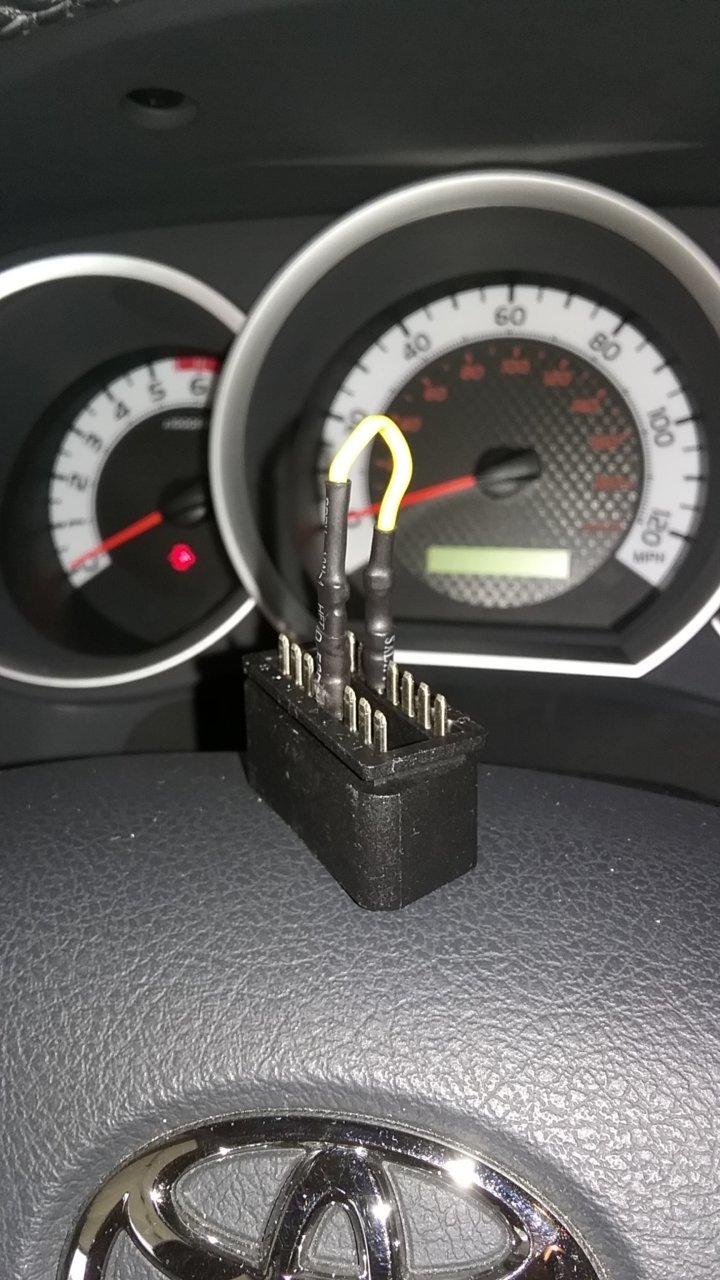

    This little contraption makes the temp check mode a snap.
    Ricardo13x and Alexely999 like this.
