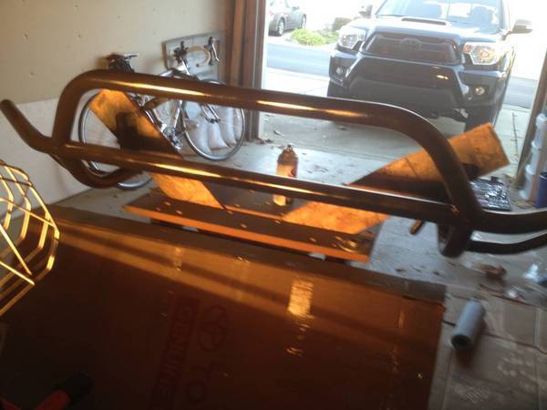

    The bar itself, as shipped, is presentable enough that if one wanted a silver-chrome finish, the bar would do fine as it is, outside of the fact that steel rusts. This is bare steel, so obviously you want to coat the steel with a rust inhibitor of your choice. The welds seem fine enough and the overall quality appears high.
    I just used two coats of Rustoleum primer, two coats of black enamel rustoleum, followed by two coats of rustoleum clearcoat.
    After primer:
    I might want to repaint it later on. I was first thinking about color-matching it to the truck and might do so later on. Black suits me fine and goes with the predator step bars I already installed. I wasn't too anal about application, given all of this. Regardless, the bar is going to be abused by bugs, dirt, and whatever, so I wasn't too picky about doing the absolute finest paint job ever. Simple rattle-cans were sufficient. Nothing fancy. It did the job good enough.

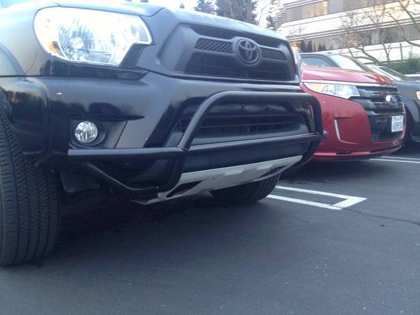

    The end result was pretty nice. I like it. I already got a compliment from a guy in my condo complex who owns a Dakota. He said he had not seen one of these bards before and asked where I got it from.
    I was detailing the truck, as well, so excuse the rags. I also just got the Michelen M/S 2 tires, along with the TRD exhuast and Weathertech liners, and 50% window tint on the front.
    Anyways, the bar adds a nice touch. I like it. Hopefully, it holds up well over time.

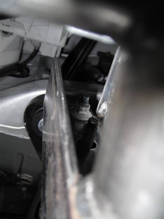

    It attaches to a plate on the front ends of the frame.
    Each side has three bolts pointing forward,
    The light bar slips over two of the three and uses existing nuts to secure it.
    Torque value is 42 ft/lbs.

    Only Pic I had.
    Believe it's looking up from below the front bumper, along the Avid Lightbar Attachment Angle Iron.
    One of the three Nuts & Bolts is visible.
    Bolts will be obvious as it will only fit in one position and only slide onto 4 bolts
    Best to take off Grill to access from above as well as below, for threading on the nuts and tightening.
    Tough to get a 2' Torque Wrench in there, but you can.
    Also helps to have an extra pair of hand to hold it up while you position it on the bolts.
    It's and easy install, good luck
