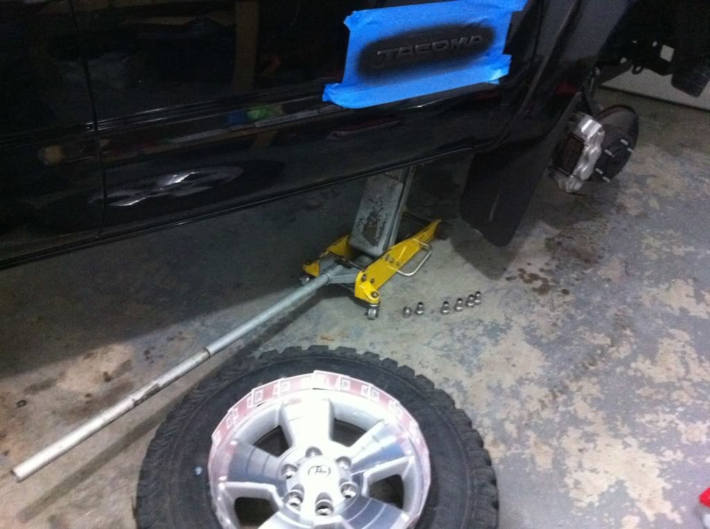

    Getting the tires swapped over...don't have any pictures directly after the install on this day.

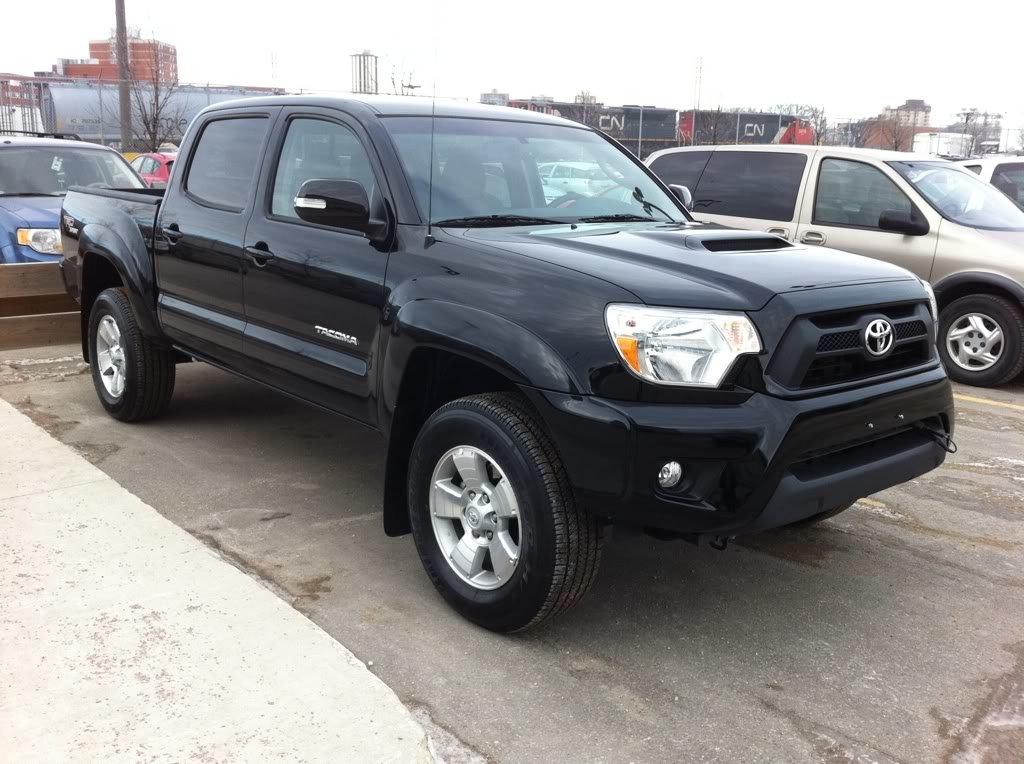

    A random picture next to another Tacoma before the Plasti-dip

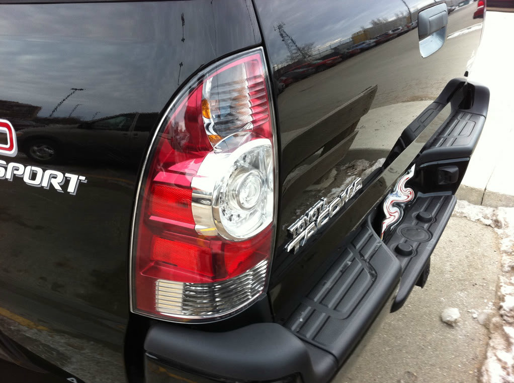

    ^ im digging the tail lights. did you just tape it off and use night shades?
  7. Dec 14, 2011 at 11:32 PM
    SoCalTacos
    SoCalTacos Turd runner
    Nov 5, 2011
    #66543
    3,716
    socal
    2017 4Runner TRD Pro
    Led head/dtr lights.
    Tinted with clear sections cut out.

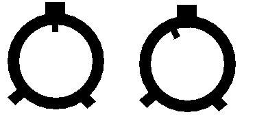

    The install would be the same...the piece that needs to be cut is at the rear of the housing...either the alignment disc, the plastic housing or the threads...I haven't decided what I want to do yet...kindof busy with Christmas stuff and don't have time to fool around with it atm.
    Look at page 8 here:
    http://www.theretrofitsource.com/pdf/trs_tech/Morimoto_Mini_D2S_Retrofit.pdf
    You can see the adapter plate with the 3 tabs...it has a channel on it that lines up with the threads...the channel is at 0' and should be somewhere between 340-345' position as the light outputs are slanted upwards to the drivers side and taper off down to the passenger side...I may just make a new adapter plate with the channel in the proper position when I get a chance to line it up.
  17. Dec 22, 2011 at 4:19 PM
    #17
    Commanderwiggin
    Commanderwiggin [OP] Well-Known Member
    Nov 21, 2011
    #67438
    356
    Calgary
    12 Tacoma D/C 4x4 TRD Sport 6MT Supercharged
    This is kindof the idea...adapter plate on left is what comes with it...the one on the right is probably what it should be...obviously going to have to line it up before knowing exactly.
