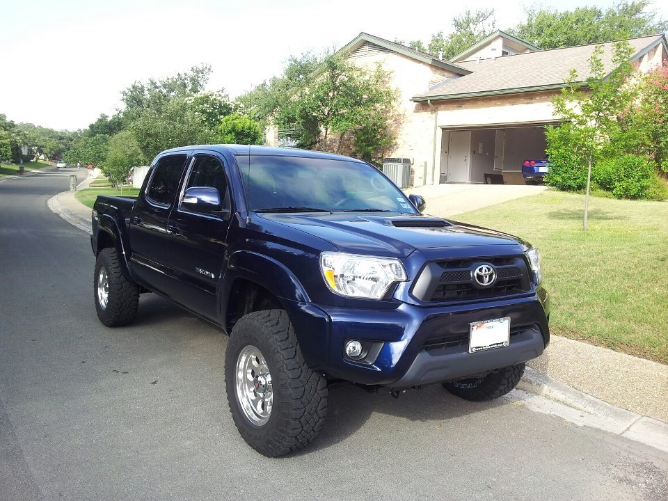

    I have the same truck, same package and I also have a nice handling car:
    First I went down to 16" wheels and went up 1 size in new quality tires..and noticed a huge improvement in handling.
    I then put the 5100s and noticed a huge improvement in the ride. Not spongey anymore. Very smooth, but slightly firm over bumps. You can set the 5100s at stock height (I lifted my front 1.75) to level it out. The 5100s are much thicker than the stock Bilsteins. You can clearly tell it is a premium shock. The stock shocks look like toys compared to the 5100s.
    Do either one of those or both and you will be very happy.

    Gonna do the same for my truck, did 1.75 completely level out your truck or are you a bit nose high?

    It came out perfectly level.

    265/75/16. Everyone asks me that. They look huge, right? I have 16x8.5 wheels, so I think that extra half inch width makes a big difference.

    I would have thought they were bigger than that. It looks like you have a full lift kit rather than just leveling the front end. I guess the wheels help make the tires stand out more. It is not just the width but the offset that helps make it pop.
