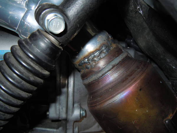

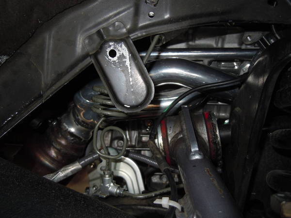

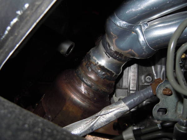

    Im back with pics and an update of these headers.. after install we took the truck for a drive and didnt feel much of an improvement but after about 20-30 miles of driving around it got better and better.. The ECU was re-booted so I think it was that relearning everything and now that I got some miles on the headers, I do feel a little more pep in the low to mid range which is great for all the hills around where I live.
    Im still super pissed about the fitment quality of these headers. They plain sucked ass to install! On the drivers side especially.
    Does anyone know if having pressure or force on the pipes/flanges is bad and will cause damage? bc I had to force the y-pipe up and over to line up with the headers. and wondered if that pressure on the pipe will cause welds to crack over time.. I hope it will be fine.. Its not a ton of force, but just a little. I geuss time will tell.:)
    Well off to the pics! My welds arent perty bc I wasnt worried about looks just that I had good welds that are strong and will hold and not leak. :)

    Oh! and they give you bolts to use when installing, But you cant use them on the uppers bc the EGR tube is in the way, I had to use the studs and nuts for the top 3.
    Its like they didnt test these headers on a 2012 or something, they just built them and said oh well. The only good thing about the headers are the build quality and the flange holes all line up. luckily

    The good things is that you were able to overcome the problems.
    I can clearly see the gap that you had to fill in. The real test now, will be how wll it holds up over time.

    Yeah i hope it holds up. The gap on that side of the pipe isnt bad at all. The other side had a huge gap.
