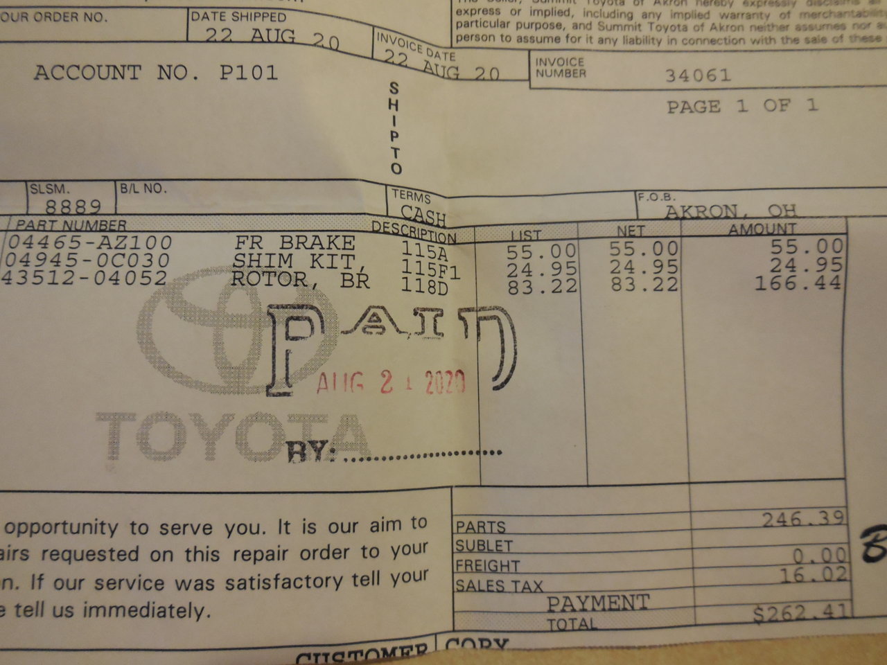

    =========I put factory parts on . My braking before change absolutely sucked .. My old pads were ceramic / aftermarket . on new install , i was able to return the shim kit part, ( the original ones cleaned up nicely ) saving an extra 25 buks . go to my post titled chitty brakes for the whole story . my braking is fantastic now !!
