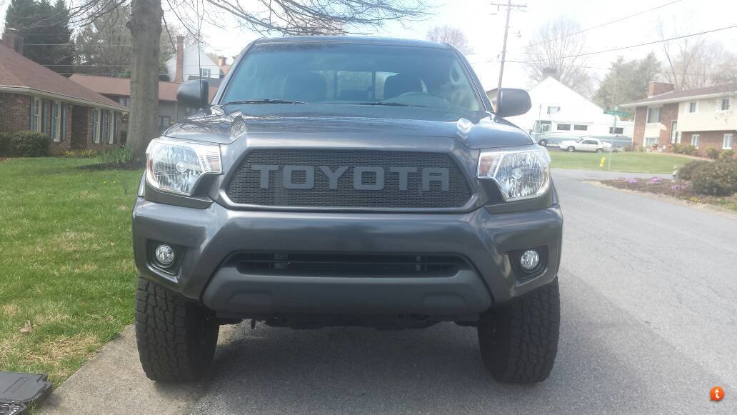

    5100 @ 0” w/ 2.5” Eibach spring, 1.5" Icon Progressive 3 leaf + 1” block, Procomp Wheels, Grill Thin Lip (Custom Car Grills Mod), Access Tonneau Cover, Pop & Lock Tailgate Electronic Lock PL8521
    Looks really good!! :thumbsup:

    Some stuff...

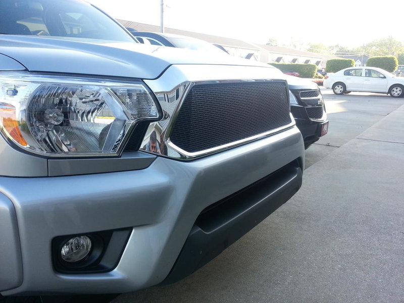

    Thanks, Chris! I went ahead and painted the radiator black while I was at it. :thumbsup:

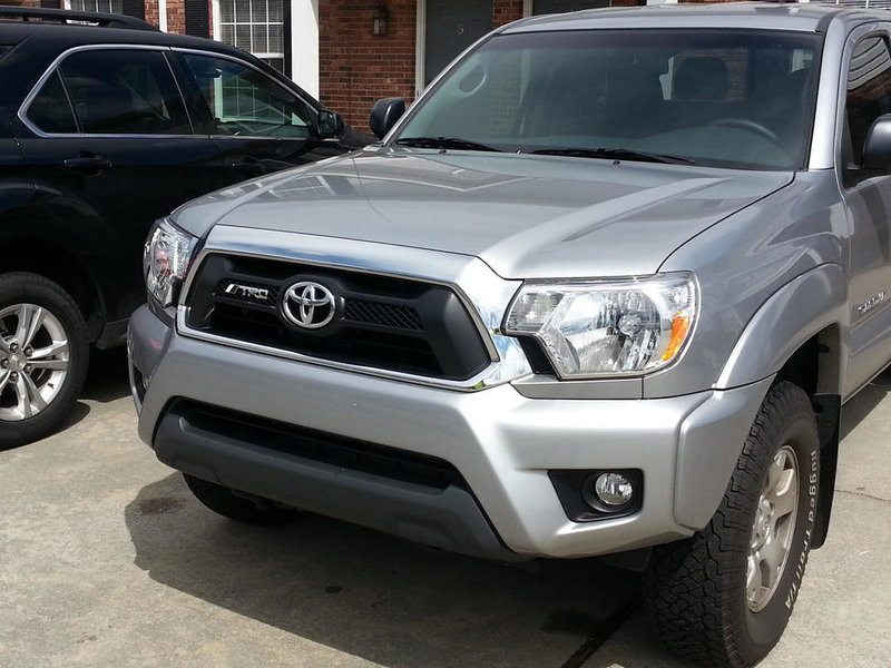

    Tailgate Antitheft, Locking storage bins, sliders, caltrend seat covers, seat warmers, bike racks, tonneau cover
    After much thought, I might hold off on this setup. I feel up in Minnesota this will just act like a massive bug net during the wet months. Still will look at pics tho!

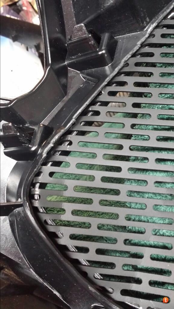

    I kinda improvised a little on mine...
    I couldn't get the mesh to line up right by only sandwiching the top border between the surround and the grille. Sooo I sandwiched the sides too. The mesh has to be bent back forward around the side edges to get it to work. Some of the paint got scratched off on the back but from the front you can't even tell.
    I am now in the waiting stage for the goop to dry. If you have access to any type of syringe it make applying the goop 10x easier. The goop is too thick to pull through a needle but if you fill the syringe up from the top, then the hole at the bottom is just big enough to squeeze a steady stream of goop through and apply more accurately.

    Nice job. I think I had some trouble fitting it along the edges also. Good idea with the syringe. Looks good!

    Thanks. I was a little worried when I started bending the mesh, but I think it turned out pretty good. I'll post more pictures after I get it finished and get the letters on.

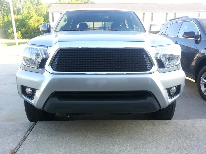

    Great write up! Just got my grill yesterday. Going to take the lights off and do the bhlm and paint my chrome grill and do the insert this weekend. I've been bouncing a few emblems around as well. I do like that old school one. If it was painted TRD colors would look pretty good I think.
