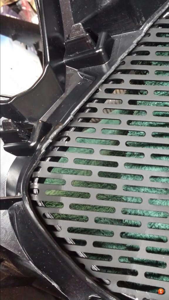

    I'm in the middle of it and having a hell of a time where the mesh transitions from sandwiched to laying on top on the sides.
  5. May 19, 2014 at 11:15 AM
    #85
    Dons.of.Dons
    Dons.of.Dons Well-Known Member
    Oct 14, 2013
    #114453
    47
    Trey
    Tennessee
    2014 SR5 DCLB MGM
    Thats where I had trouble. I ended up bending the mesh on the sides and sandwiching it all the way around
    Just be careful not to scratch the paint on the side that shows. It takes trial and error to get the bend exactly right.

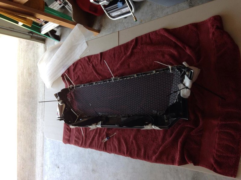

    While the glue was drying I put some weight on the center of the grill. I also screwed it down to fix the gaps that I had in the corners. Turned out pretty good. I'll post some pics when I get a chance.

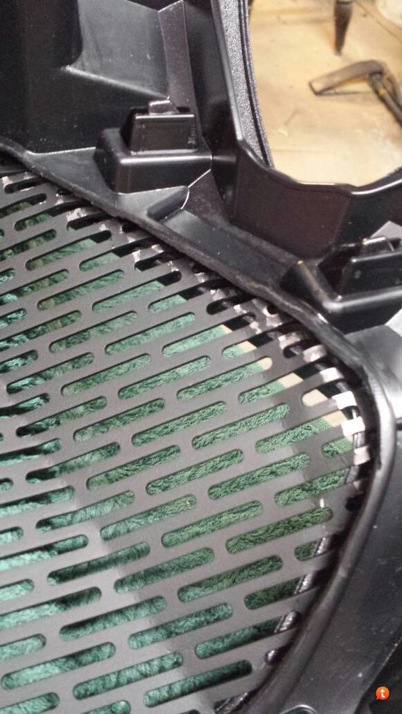

    It's kind of surprising how much plastic you end up having to cut out. I was trying to be all precise and not cut any extra at first. Then I realized it didn't matter. I ended up cutting out extra and bending the grill in. Made life a lot easier.

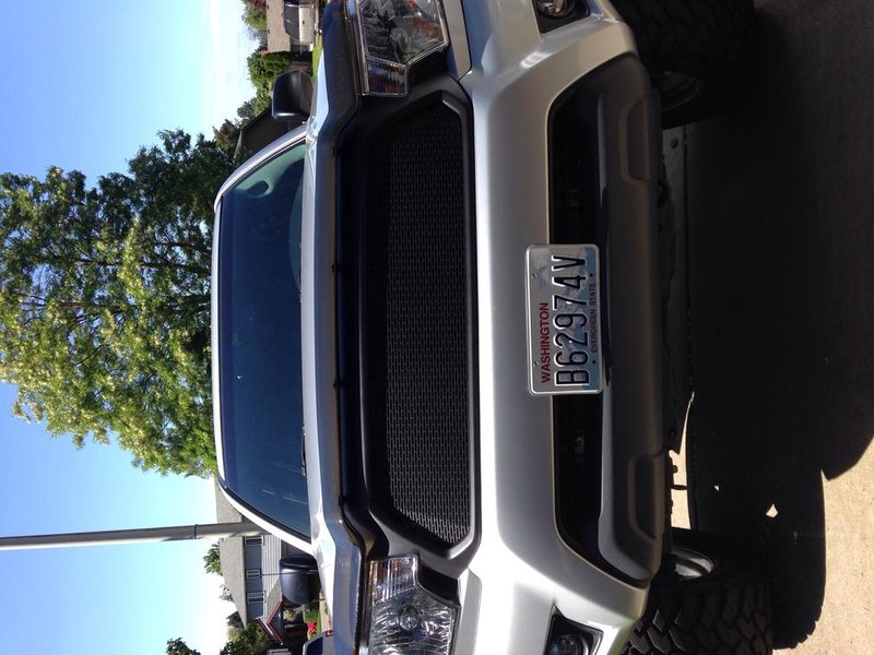

    All done. Turned out pretty good. Couple spots I noticed but other than that it looks real good. Dropped my raptor toyota letters off at the powder coating place today. I'll have them back next week.
