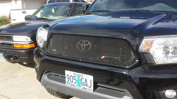

    Also made a bracket that holds the Toyota emblem. It breaks up the emptiness.
