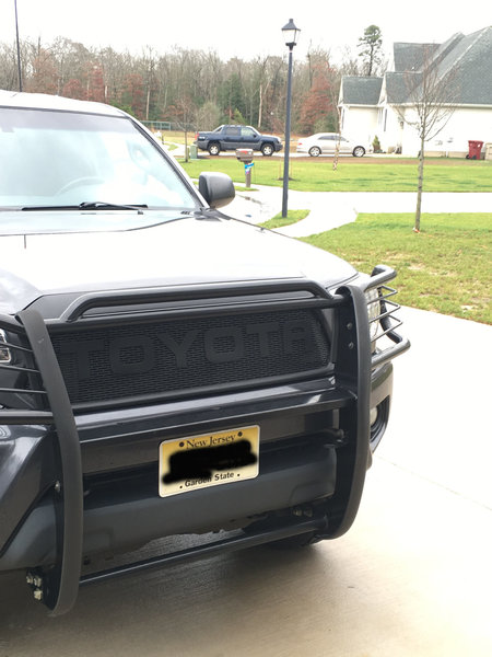

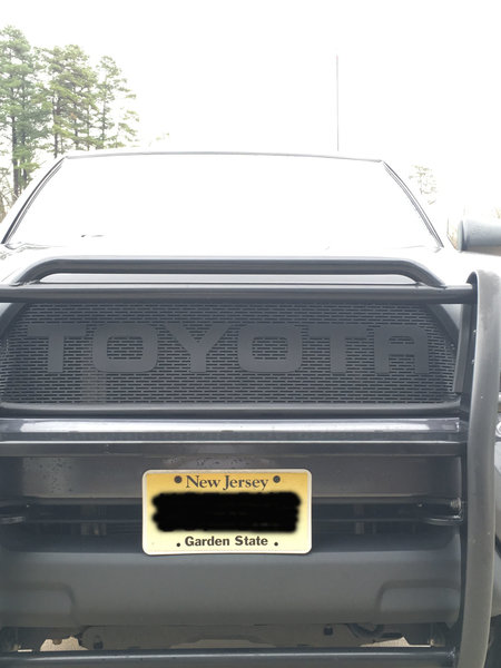

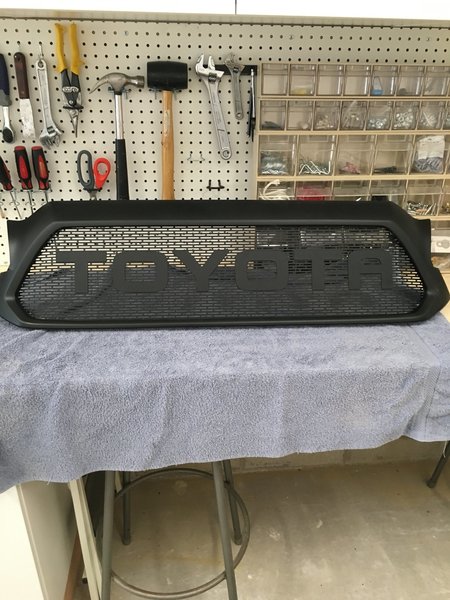

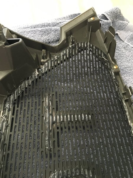

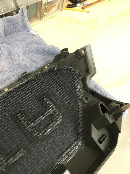

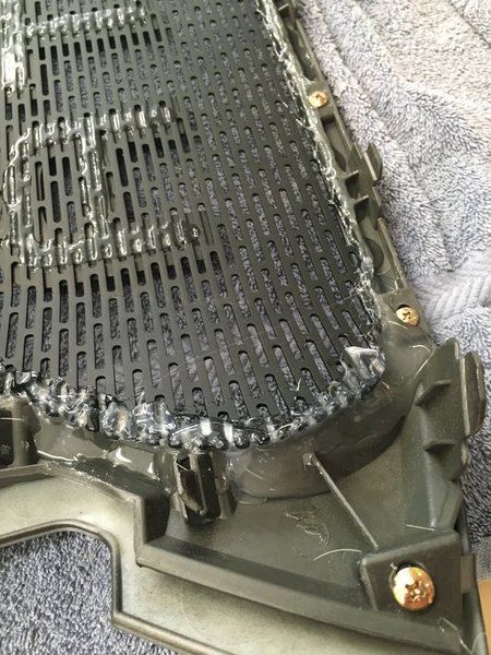

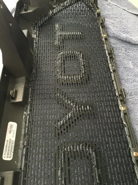

    Just did mine as well.
    Quick thanks to Matt of customcargirlls.com, excellent customer service and a great product.
    Also thanks to OP, his additional pics and info on page 1 assisted with the installation!

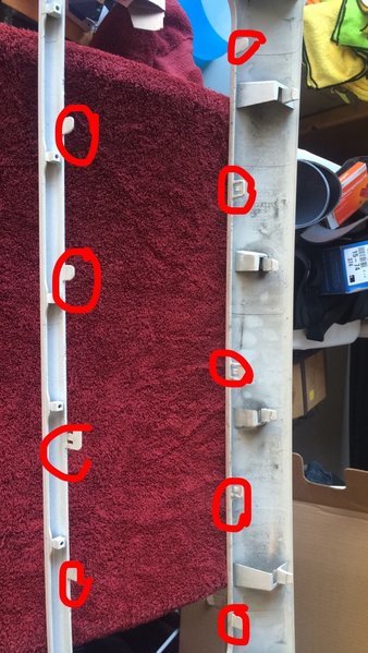

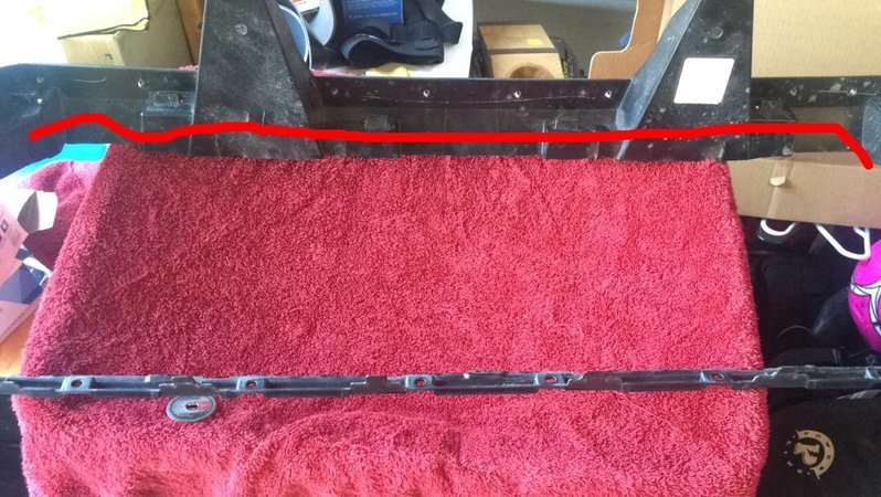

    Ok 2 questions on this because it would make more sense to me after taking a break and now having some bourbon to clear my head.
    The spots on the white painted portion, are this supposed to be cut/trimmed off?
    Another is on the black plastic will I need to cut way up into the top portion to make the mesh fit? I'm just not following with what's in the video and pics in this thread... I keep reading you'll need to cut more than you think, but want to make sure I'm not butchering something that is needed.

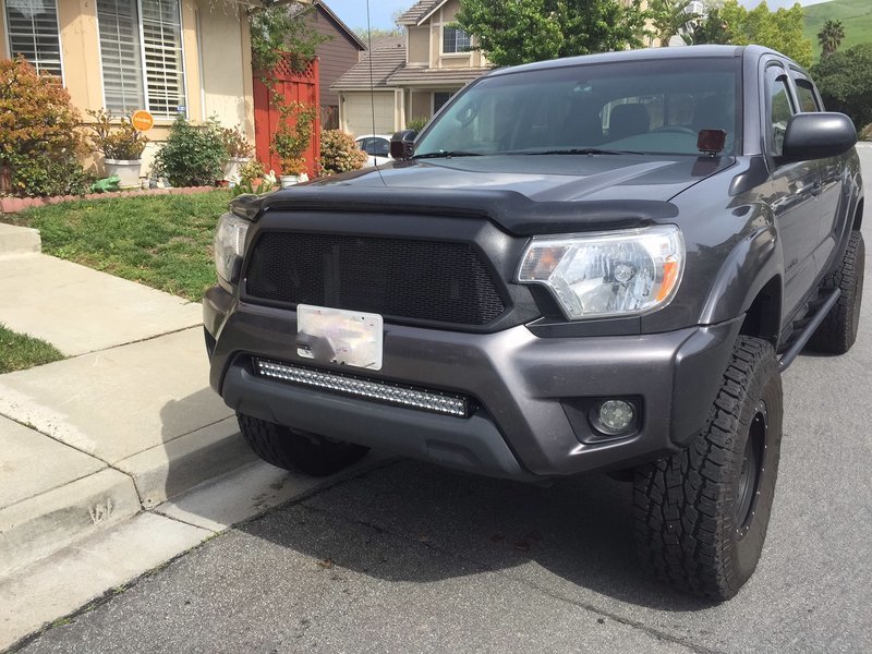

    I am in the middle of doing this right now.
    Yes, those tabs need to be cut out.
    As far as what you need to cut out of the black inner plastic, just follow the shape outlined in with the silver sharpee in the video and cut away any more plastic as needed when you test fit.
    www.customcargrills.com/Toyota-Truck-Grills.asp

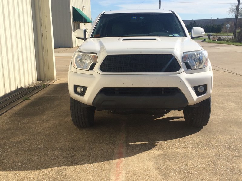

    Rushed through it a little and was using some extra JB Weld epoxy I had but came out decent. I'll probably re-do it at some point since the bottom portion isn't completely flush. For now, its fine.

    Well once I figured out that I didn't have a "custom car grill" branded grill it made life much easier because I didn't care how it fit and I just cut it all up to go in properly.
