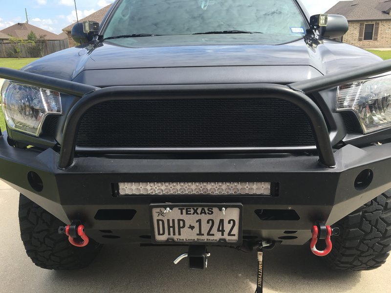

    Just saw this thread, I did mine about 2 weeks ago following the CCG's you tube video. I think I did mine wrong... So you glue the mesh to the grill surround and then put the cut out plastic over? I did the opposite and put the surround on the plastic then glued the mesh which made the bottom part not flush at all.

    yeah I messed up I didn't sandwich the grill..:annoyed:after I cut the inner plastic I joined the outshell and the plastic I cut then glued the mesh last.. From the you tube video on CCG's website that's what it looked like.

    If it makes you feel any better I couldn't get mine to fit correctly like the ccg video shows so I did what you did.
    If I remember correctly, you're supposed to put the bottom mesh between the two halves and the top half rests on the back then you goop it. Mine wouldn't fit in there right so I gooped it to the back of both halves.
    Numerous people have seen it and never noticed it. I've had it at car shows and people would say they like my grill. I even had the chrome outer surround professionally painted and the painter said he thought it looks good.
    Basically, you are going to be the only person who will notice it.
    Post a picture
    Jamart5[QUOTED] likes this.

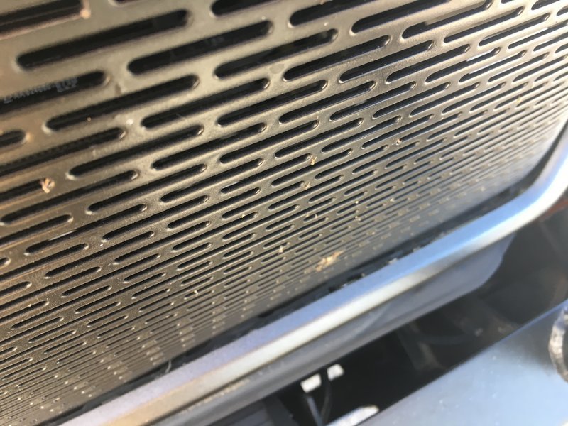

    This is the one I have on my phone, there is a gap between the mesh and black plastic. Still looks good though.
    jamiec likes this.

    Mine has some gap at the same spot. Its been a while, but I kinda remember it not being possible to get it perfectly flush on mine. You really have to look at it to see it.

    Ok, yeah the gap is all in the bottom. Like you said you can't tell unless you get up close.

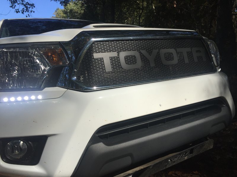

    IMG_3248.jpg Did mine a few weeks ago. Love it!
    moondeath[OP] and Jamart5 like this.
