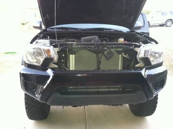

    here is my truck with the grill removed. some people choose to remove the bumper but i figured the grill and lights were going to be my best bet.

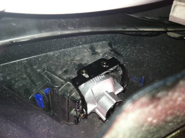

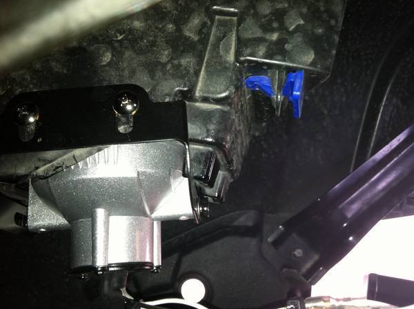

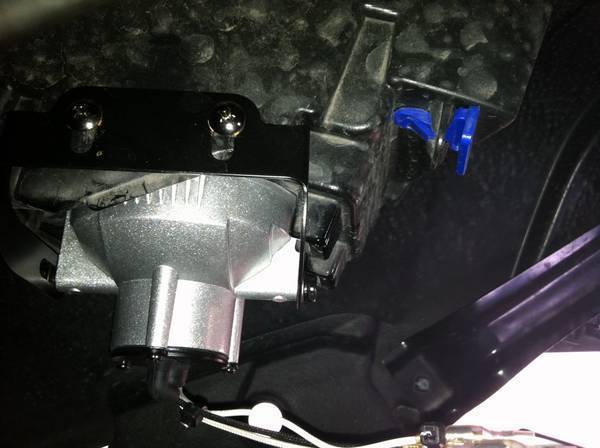

    I basically put the lights were i felt they would be flush and then taped them up from the outside using a few strips of clear tape so they wont move and began to figure out how i was going to mount them.
    No pictures sorry. :(

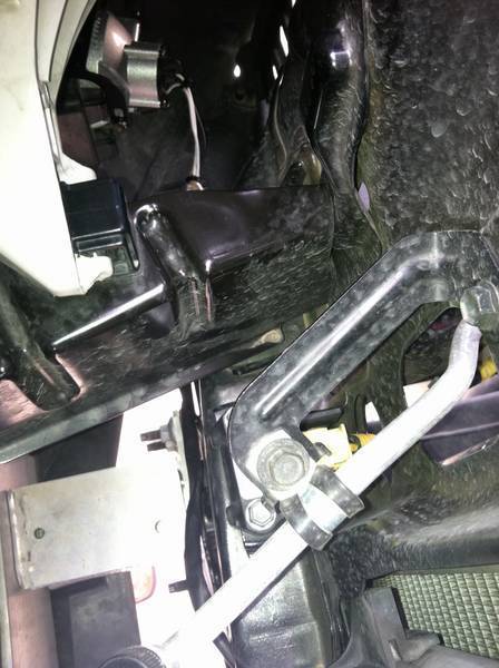

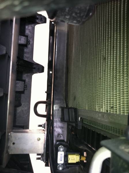

    But once i was able to see them from the back i figured doesnt look bad at all and with my drill began to drill to holes were the screw for the mounts would need to be placed and simply drilled the screws in. It was not easy getting my drill in there but i managed. and after i drilled to small holes where the screws would go i was easily able to use a screw driver to screw in the 2 screws that were provided to mounts the light.
    Here are a few pictures of behind the light to show how easily they mount.
    The light on the passenger side basically has a long connector which goes straight to the drivers side light and is perfect in length and easily hidden.
    Pics might seem confusing but its basically theway i routed the wiring through a bracket that is in front on the radiator and secured it with some zip ties.

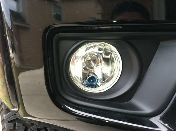

    The light also has a small blue light inside of the housing that can either be switched from the fog light to the blue light. I chose to have them both on at the same time and ran it all direct straight to the headlight wiring.So once again no switch was used.

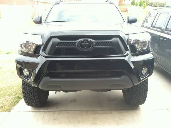

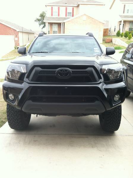

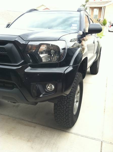

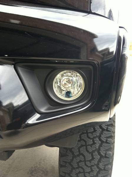

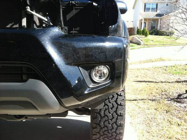

    Here are random shot of how the lights look after install.
    Final review:
    Im happy. 9/10. Great price. You even get a free hat. Wiring and housing is very sturdy and secure.Fit is great.I would recommend the kit to anyone with a 2012.
    So why a 9 and not a 10. switch is cheesy looking and mounting tabs could possibly be a bit better but work and get the job done.And final reason for it getting a 9 out of 10. Its simply not factory.
    Get the kit and enojoy these lights.Like i said you truly have nothing to lose and it makse the truck look more complete obviously.

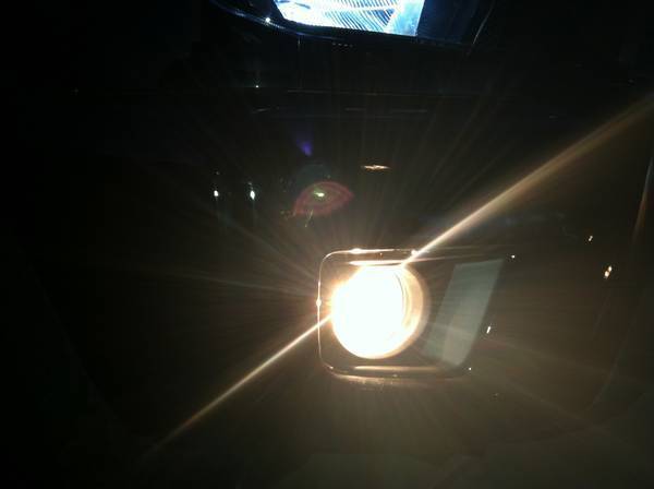

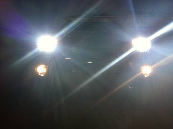

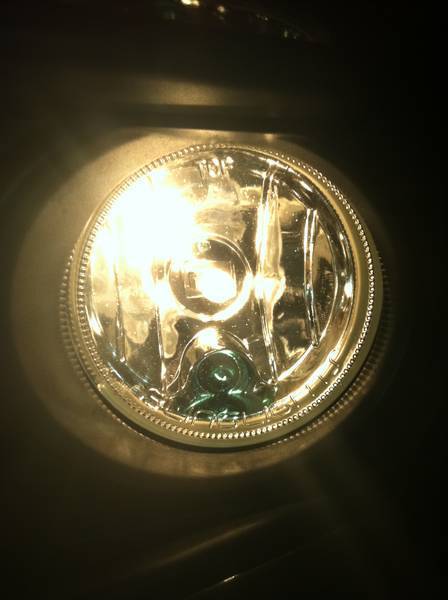

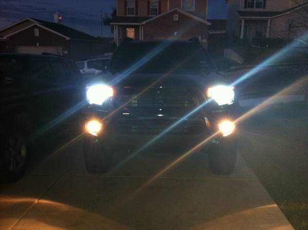

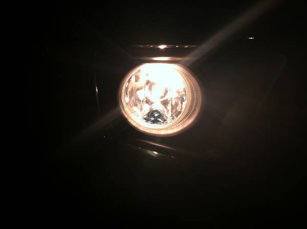

    I posted this in another thread i started - but here are pics with the lights on - this was taken a couple days ago.
