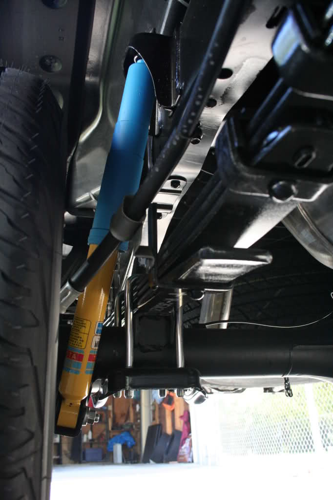

    The 4 leaf pack or ( TSB ) pack is 3 leafs plus the overload
    The US stock 3 leaf pack is 2 leafs plus the overload

    You're correct that 4 leafs are stiffer. However, for Off roading, it is better to have more flex - for better articulation and handling on uneven terrain.
    The trouble arises in that springs are like tires - it is impossible to get one set that does everything, awesomely, all the time, everywhere. You have to choose what your priorities are (load carrying, flex, etc.) and optimize for that and make some compromises to achieve those goals.
    Toyota is in a no win situation here - whatever choice they make will leave someone declaring them morons for not having chosen a different set of priorities.
    At the end of the day, the springs, like the tires, are a (relatively) inexpensive upgrade. So, if you don't like whatever came stock, talk your parents into giving you a better allowance and buy ones that do what you want. :D

    ok, ..so this means i have the 4 leaf pack on mine?.. i.e. this is TSB-compliant?.. ride is pretty firm, which i like... this is my first "truck" though, ..i'm used to harsh ride in a RWD car..

    The 4pack looks like this :
