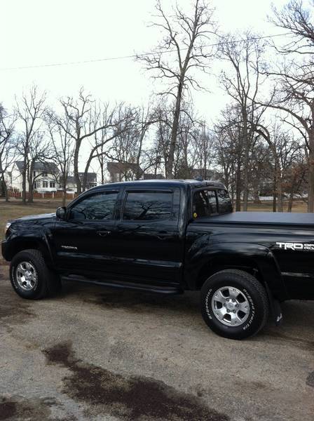

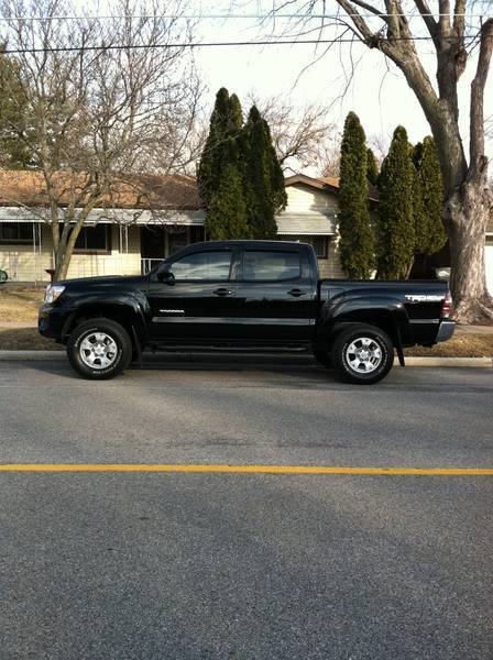

    Just got 5100's set @1.75 put on the front with a 1'' block in the rear. I like how it turned out.
