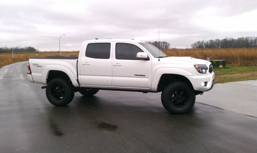

    Here is the lift! Had to add spacers to fit the wheels tell me what you think!

    Looks good! Nice job on the headlights too.

    great looking truck :thumbsup:

    Damn looks good, I also had a hell of a time with my UCAs. I think it was harder to put the damn bolt back in & hold the UCA at the right angle at the same time than to beat and cut my inner fender, but it came out nice.

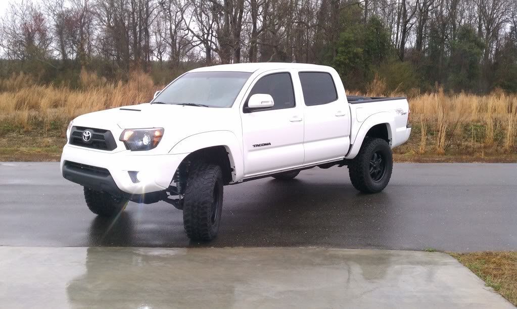

    Yeah I surprisingly haven't had to trim anything to fit the 285!

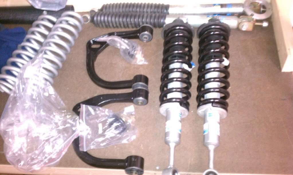

    Adjustment range: Camber ±2.00 degree Caster 0.0 degree to +4.00 degree
    Installation time: .8 hr/side
    Required: 25470, 25480 - includes Left and Right arms 1 per axle
    Required: 25472, 25482 - includes 1 right arm ONLY 1 per axle
    Required: 25473, 25483 - includes 1 left arm ONLY 1 per axle
    25470, 25472 & 25473 Applications
    Toyota 4x4: 2005 & Up Tacoma
    Toyota 4x2: 2005 & Up PreRunner
    25480, 25482 & 25483 Applications
    Toyota 4x4: 2007 & Up FJ, 2003 & Up 4Runner
    Toyota 4x2: 2003 & Up 4Runner
    Patent No. US 7,513,514 B1
    My new ball joints are stamped with the # 25480 which i see is a number applied to FJ's and 4 Runners. My Right arm are stamped 25470, which jives. I think. My Left arm is stamped 25475. A number not even listed. The quality of the welds and finish on the arms is also noticably different, looking at them side by side. I e-mailed Metal Tech 4x4 and also SPC. I think the ball joints where for the FJ/4Runner. Will see. Maybe i should have checked this before trying to install

    Ball joints stamped with 25480118, as seen in photos are for FJ's and 4Runners. The correct ones are 25470118. Just got off the phone with SPC. Waiting to here back from Metal Tech 4x4. Just an fyi.
    Hey knine00, i know you stated you got them in but they are the wrong ball joints. You should'nt have had to struggle with them at all.
