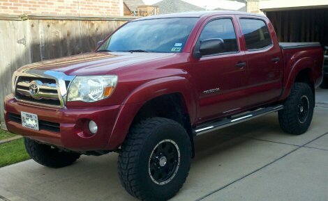

    Here she is fellas:
    First impressions... The looks are amazing and like everyone else says that installs these, the pictures really do the truck no justice. The only negatives that I have in the brief time that I drove is that I have some steering shake between 40-60 mph and I am definitely needing more pressure on the brake to slow the truck down. I am almost certain that the steering shakes is from the tires not being balanced but it was SUPPOSED to have been done. I will start there and see what happens.
    For those wondering, I have Bilstein 5100's up front set to zero with OME 883 coils on top. In the back all I have is the ALL Pro standard leaf pack. Rims are American Eagle series 140 wrapped in 285 75 16 Kuhmo MT's.
    Overall... EXTEMELY happy! Thanks again Jacob and Bob!

    Looks great!! How much lift are you leafs providing? And hard to tell but does it sit pretty level??

    I took a quick measurement from the ground when I got home but I was on my driveway which has a slight slope. It shows that I am an 1/8" lower in the front. Considering the slope, it's got to be pretty close to level.
    I will take some better measurements tomorrow and report back here. The leaf pack is supposed to give 3" of lift.

    Are you going to put spacers on the back wheels to match the front?

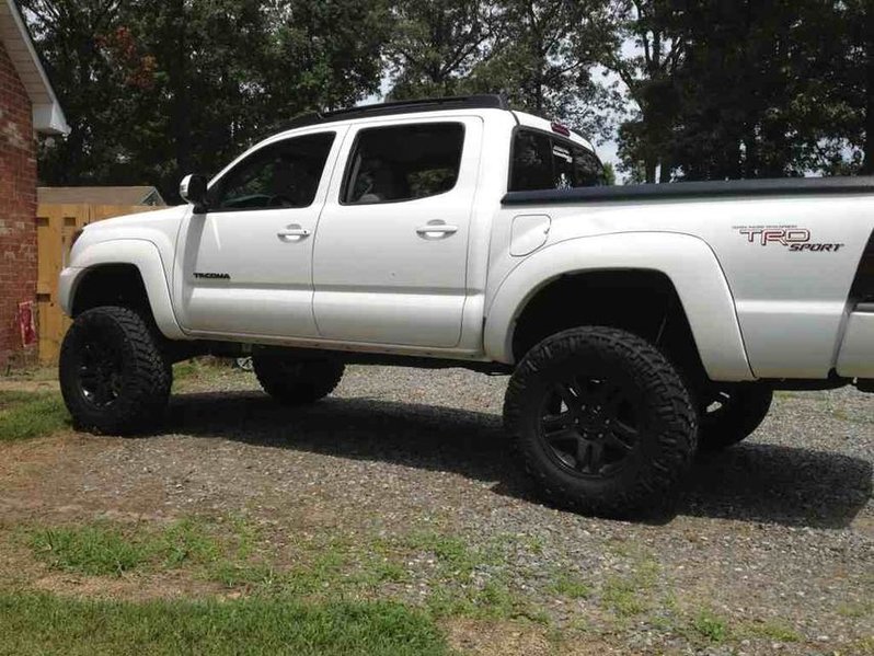

  14. Jul 24, 2012 at 6:33 PM
    #774
    YotaMatt
    YotaMatt Livin Low, Ridin High
    Mar 8, 2012
    #74448
    5,185
    West Point VA
    12 PreRunner DC TRD Sport
    Spidertraxx 1.25" spacers in front and rear, 4" Maxtrac Spindles,Billy 5100s at 0", OME 885 Springs, 1/4" top spacer on both sides, 1.5" AAL, 3" Block, 1.5" 4crawler driveshaft spacer, 17x9 XD Spys with 35x12.50 Nitto Mud Grapplers, Magnaflow offroad Stainless Exhaust, Volant Intake with scoop,Camo emblems, BHLM, Tinted tailights, Anytime fog mod,Alpine Type R 12, Kicker 1000 watt amp,600 watt 4 channel memphis and all memphis components, 35%tint front all the rest at 5%, Hella 500s with sylvania zxe bulbs, sylvania zxe headlights, sylvania zxe fogs, Weathertech digi fits, flyzeye blue/white, LED map dome license plate lights, Redline hood struts, Tailgate EZ Down, Custom TRD Camo Browning Edition Bedsides, Camo wet okoles, Ridgid Dually bed lights, SOS Concepts Tire Carrier
    Will post more tomorrow...

    Haven't really decided yet. To be honest, I didn't even notice the difference (wasn't paying attention).

    I thought that the 885 was for double cab why did you go with the 884?

    Actually I went with the 883 coil. From what I gathered, this spring gives the best ride (least amount of stiffness). 884's and 885's are more geared to having a lot of weight in the front (big bumpers, winches, etc...) which I don't plan to do. Finally, the 883's only lift 1.5" while the other two are 1.6" and 2" respectively I think. I really didn't want to go much higher than the spindle lift height.
