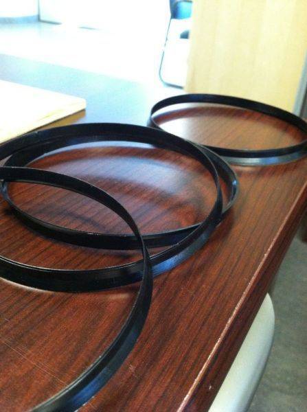

    Thank you for that! I believe my are caused by the wheels as well, I actually read a case where a guy with the EXACT same truck as me and the EXACT same wheels had steering shakes and once he put the rings on they went away. I am pretty confident that the rings should do it for me. I bought mine on Amazon for 12 bucks. So They should be here Thursday and I will prob put them on that day. Ill let everyone know how it goes.

    I didnt get them for whatever reason they didnt come in when they said they would. Ill post up my results once they are installed. I am hoping they come in tomorrow...

    Well they came in
    These things are really thin and are made of what feels to be hard plastic..... I dont see how these will help much but alot of guys say they do. So Ill post up my results when I install them after work.

    That's definitely them...no worries.

    Lol...they just center the wheel to the hub...no biggie.

    I know thats why Im not to worried about it. Hey I wanted to ask you because theirs alot of people saying they they put them on the hub and some say they put it on the wheel. Which did you do because I guess its easy to break these things.

    Wheel. They should fit snuggly in the wheel without falling off..mine did..then just mount the wheel carefully ensuring the ring stays in place....
