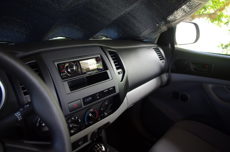

    somebody had a pic on here of a 2011 kit in a 12. It was off and didnt look good. Would it hold you over until the 2012 kits came out, sure.

    I planned to replace it once the new kits come out, but I doubt I will. I don't even notice it when driving.

    ^I see, so the mismatch is caused by the higher fan grille surrounds in 2012s.

    Thanks for posting the pic, eight08. From that view it looks like the upper-right corner of the dash kit is recessed and the lower-left corner is raised. Is that a Scosche kit? It looks like trying to fit a DIN with a motorized screen might be a tight fit.
    I think I could live with that, at least for a while. Thanks again!

    it's a metra turbokit (99-8214tb). the kit contains parts for either a double din or single din install. the top of the kit is a little recessed and near the bottom is indeed a little raised. otherwise the kit is secure to my dash, and the radio is secure to the dash kit... the kit just doesn't align visually.
