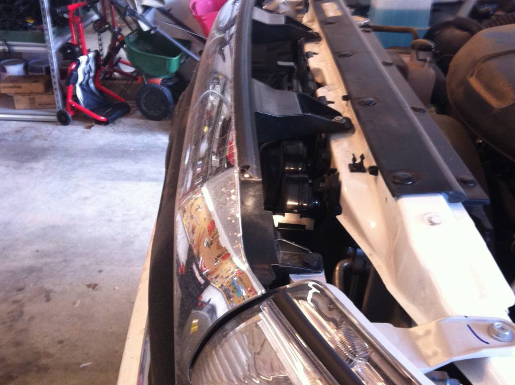

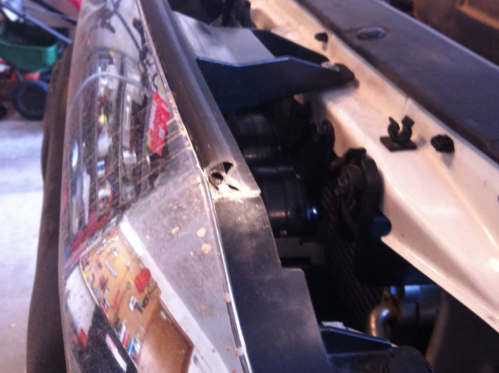

    We fixed the wind noise by shoving a 1/4" sprinkler drip line through the weather stripping at the front of the hood. Other than the rugged fails that come on the truck, this is the same great truck as always.

    1.4" plastic drip line. Just shove it inside the weather strip and presto.

    I just finished up the same mod using a soft clear 1/4 tubing... bye bye wind noise! Thanks TW for helping me cure this annoying problem with such a simple fix.

    Thanks for the photo's, I installed the tubing today and it is a fix!!
