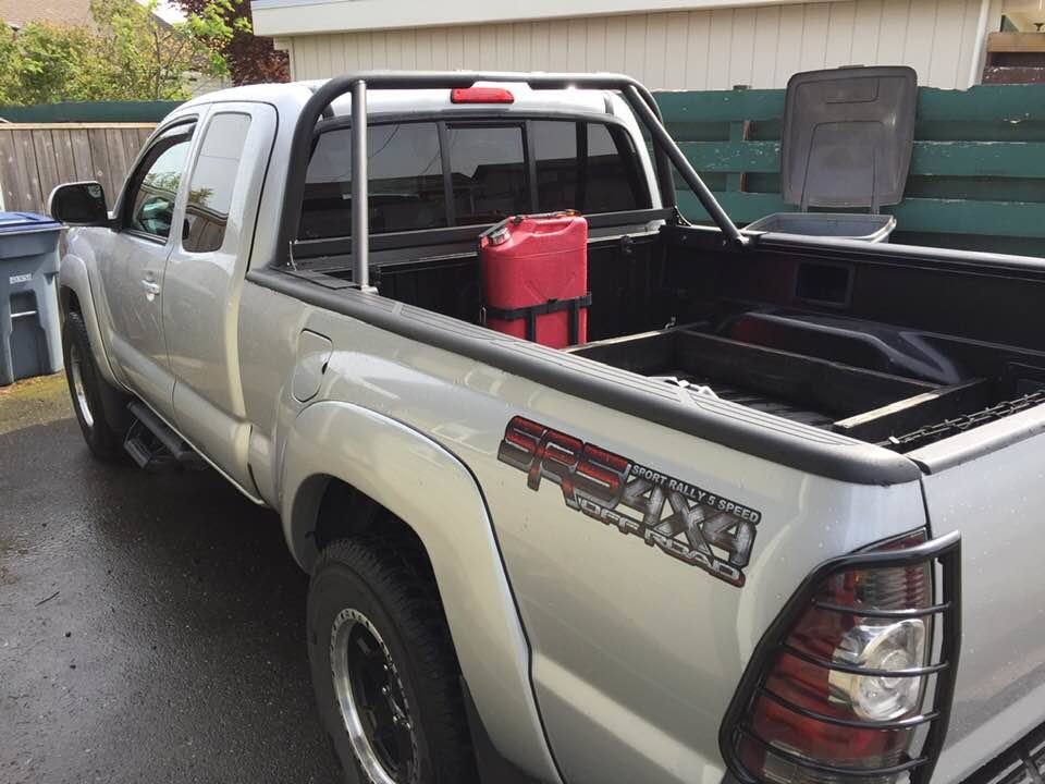

    Ended up painting the bed rack with Rustoleum Bedliner

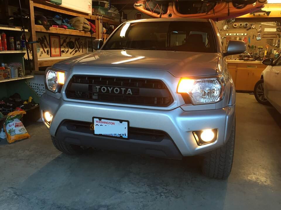

    After 2 years finally got around to wiring up my fog lights

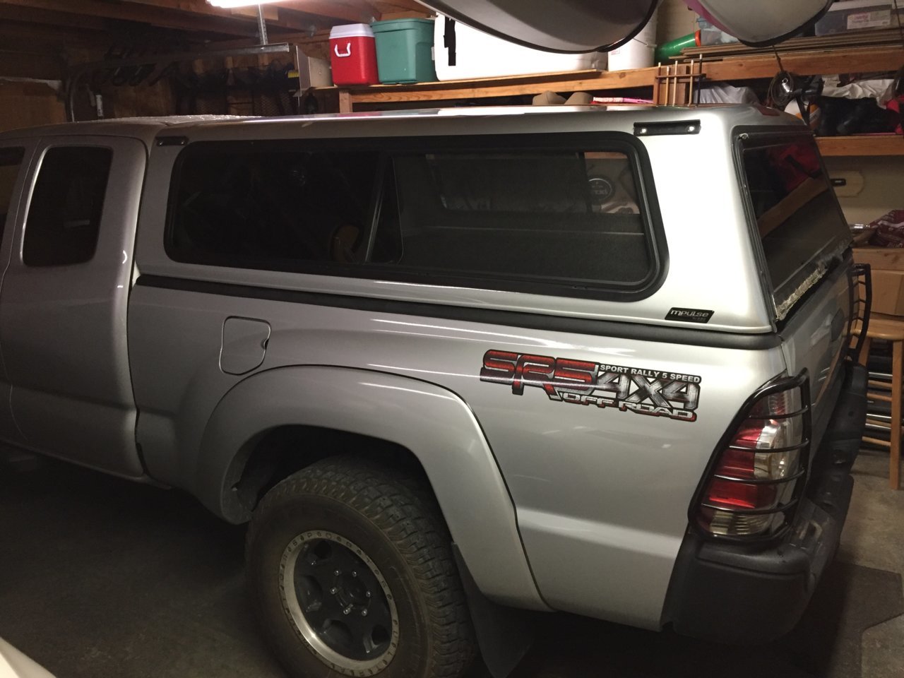

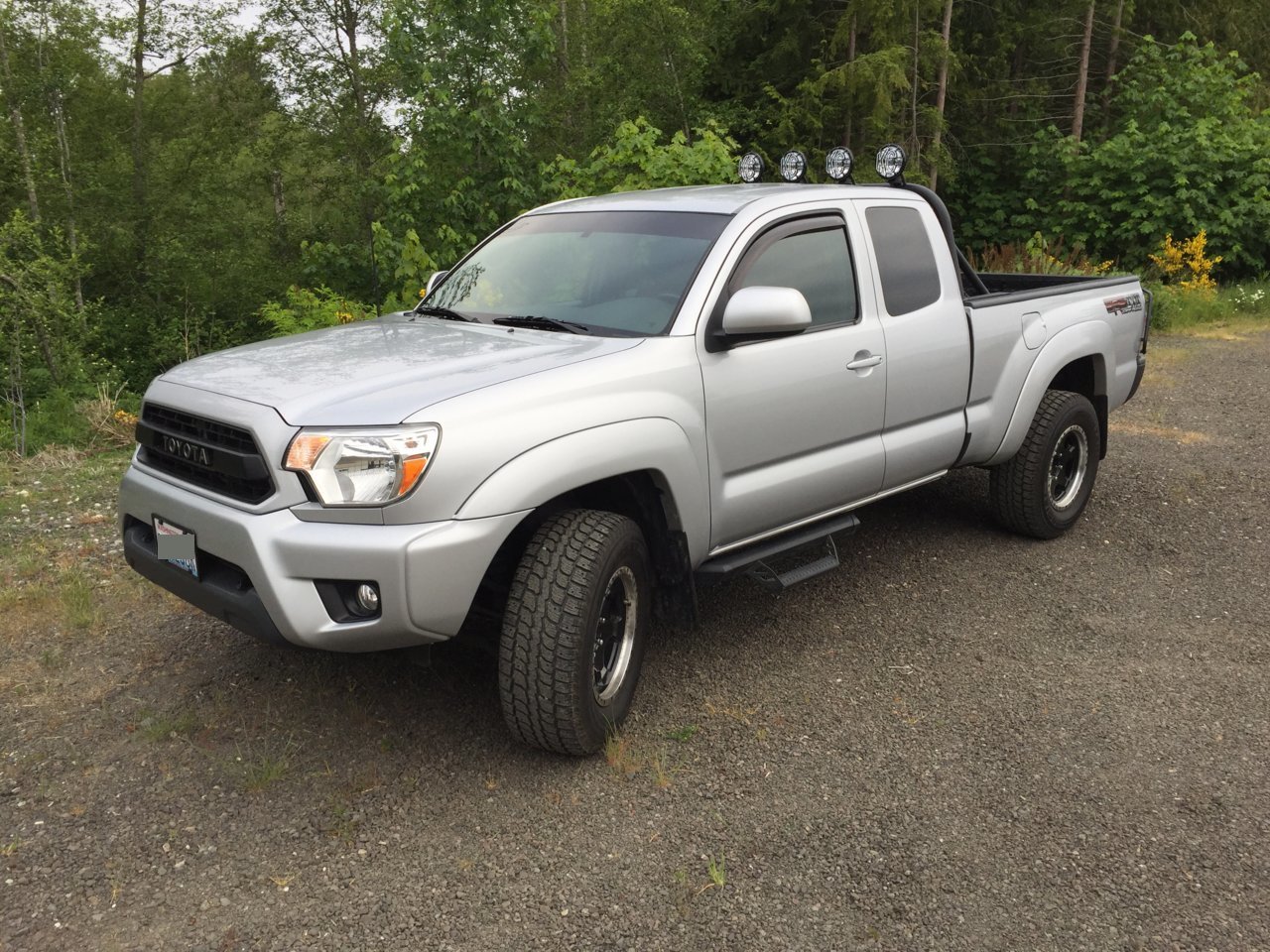

    Final product before wiring installed

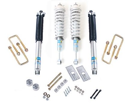

    Truck needs to be lifted theres no way around it now... :ballchain:
    Option 1:
    2" OME full suspension lift
    Option 2:
    3" Bilstein 5100 all around with coil overs in the front and a spacer in the rear

    I'd go with the OMEs. That leaf pack will be smoother than a spacer and will increase your hauling capability.
    I'm currently regretting my decision because my coils are too soft. I need to upgrade to 700lbs spring rate OME 886s, and those don't work well on Bilstein 5100s.

    I like the idea the coils and leafs were all designed for the shocks with the ARB kit.

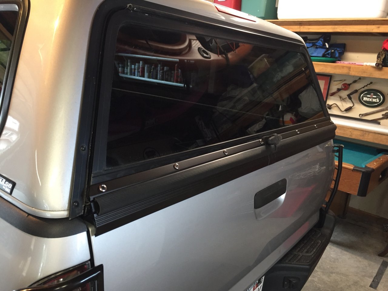

    Fixed up the door on the topper

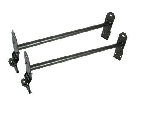

    Ordered these guys, :playball:

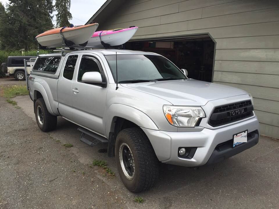

    Boats are back in operation
