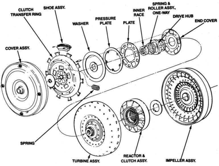

    to eliminate the torque convertor lock up as a potental source of vibration apply the brakes as you accelerate through the vibration zone. Applying the brakes and sending a "brake signal" to the various modules will unlock the torque convertor or not allow it to lock.

    I'm confused. The torque converter it's a viscous coupling, is it not? I thought locking up referred to the, "fan blades," inside the torque converter no longer being able to slice through the atf inside.
    TCs are controlled electronicly now? Htf do the do that? Inquiring minds want to know. Lol

    yes the torque convertor is a fan blade type viscous coupling but there is also a friction disc inside the torque convertor that locks the unit so that there is zero slippage. The image is a general picture not necessarily Toyota.
