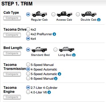

    ok, i'm beginning to think i'm crazy here. but i swear it seems like my truck has a 5 spd Auto. According to toyotas website, you can't configure a truck with my specs (2012, reg cab 4x4, 4cyl) with a 5spd auto, just a 4spd.

    cozmo,
    It is interesting that you have a 2012 regular cab with an automatic transmission. I was under the impression that the automatic was no longer available in the 2012s. I have a 20011 regular cab with the automatic. It was difficult to find.

    a buncha fuckin toyotas
    Howd you get the builder like that? When I try to build a Taco it looks nothing like that.
  13. Apr 6, 2012 at 7:52 AM
    bjmoose
    bjmoose Bullwinkle J. Moose
    Aug 31, 2010
    #42529
    6,009
    Steve
    San Jose CA
    '11 Std Cab 4x4 5sp
    OME suspension, ARB Air Lockers, CBI/Relentless/Pelfrey armor, HAM radio
    Plug in a different zip code.

    This is the answer.
