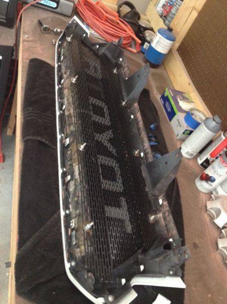

    here is the back of the grill, hope you dont mind me posting this knine

    very nice and clean. do you have any close ups? did you just glue the threaded studs on then put the grille on and secure it with a nut? also when you cut the factory grille out did you separate the painted surround before cutting?

    I used plastic weld and fiberglass to attach the studs to the grill. I took the cover off the inner peice when I started and didn't install it back on tell I was done. You run the risk of damaging it!
