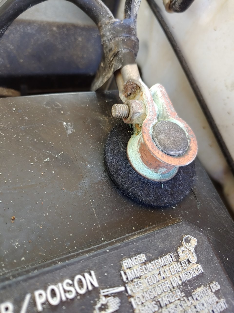

    I'll do that this evening. It seemed to drive fine this morning on my way to work. And no I didn't remove the wire on the chassis

  3. Sep 5, 2019 at 5:35 PM

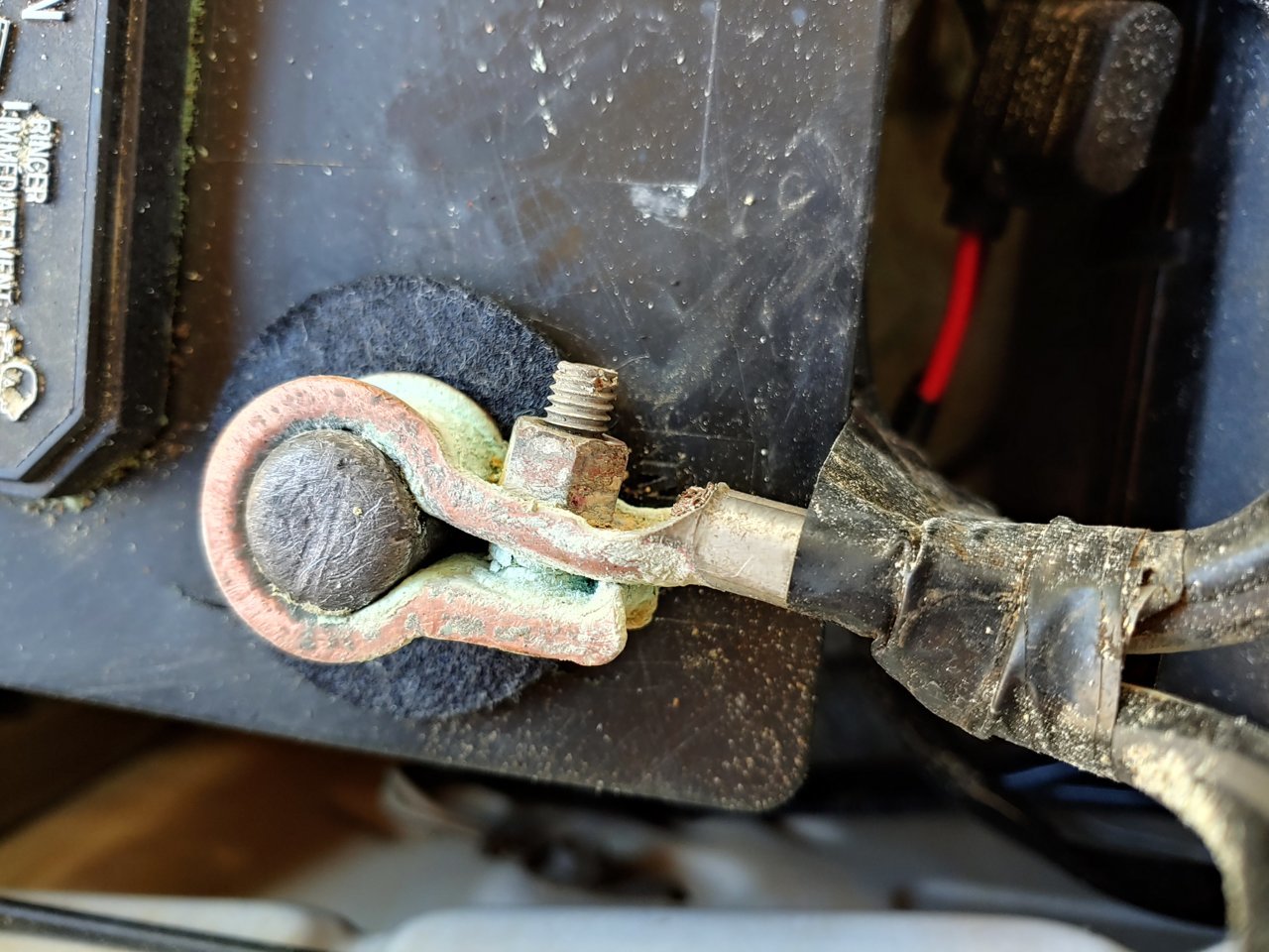

    Cables and posts are NASTY Get some baking soda and clean them up! Where you have that tape around the crimp area, you may have corrosion in the cable end itself, if you do, get new posts and strip the cable until it is clean, and use heat shrink over the crimp. If you are in any area that has snow and uses mag chloride on the roads unless you have good solid crimps and heat shrink and some anti corrosion stuff on nice clean cables your problem will repeat.

    Sounds good. Is there a special tool for crimping that big of cable?

    They are expensive, but you may be able to check with some local shops to see if they have a crimp set with proper terminals. There is a crimp tool that you hit with hammer but I dont reccomend that.

    The negative cable looks pretty bad. Did you clean the terminals and battery posts with one of them battery cleaning wire tools? 100 grit sandpaper should work also. Dont use a screwdriver or knife or other similar tool as that will create uneven surfaces.

    All I had was a wire brush

    You did a pretty crap job of cleaning those!

    Thanks man. I used what I had

    The cleanup could be a little better, but it should've been adequate enough to not make it run like crap. However, if you sprayed the terminals before you connected them that could create a bad connection. I believe that spray is usually a non-conductive sealant.

    Exactly. Clean first then reconnect. Then spray some fluid film or whatever battery terminal spray to keep corrosion away.

    I sprayed then connected dammit

    I agree that you should spray the corrosion inhibitor on after making your connection but if your connection is good and tight it shouldn't be a problem. Cranking the starter is going to be about the biggest current draw your gonna have so if that's working ok then don't worry about it.
    I do think it would be a good idea to mix up some baking soda and water and try to clean more of that corrosion off. Some claim that CocaCola poured on the terminals will do a good job of cleaning also but I, personally, have never tried that.
