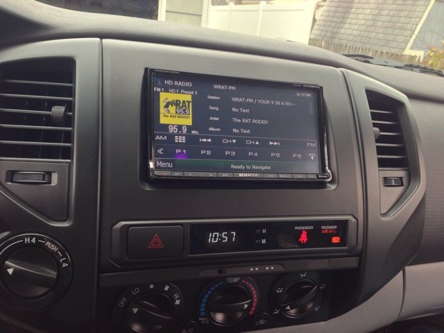

    I'm sorry, but i really don't like the flat black, and it looks by the picture there are some gaps. The kit paint doesn't match the AC controls on the scosche kit. I'm happy with my metra kit. Had to do minor widening of the hole for my radio, but it fits perfect and looks stock and used the factory metal brackets. for only $25
    However I do understand that there are different trim levels in the new trucks. Flat black or glossy. Mine is glossy. If scosche made a glossy I would think about it just to try the look.

    lol i implore you to point out said 'gaps'... you're seeing a shadow made by two concave surfaces.
    the finish on the schoshe kit matches the matte OE trim, including the AC controls. AC panel is shadowed because its recessed forward :rolleyes:. Putting a glossy metallic kit into trucks fitted from the factory with matte black trim isnt an option.
    The surround cut out around the DNX9990HD is even, and with less than a 1/16 or 1/32 at the top, its just enough for allow the face to auto tilt without any interference (unlike the 2011 kits), no trimming required.

    I have the same HU and the Metra kit. Tried using the metal factory brackets but the angle of the HU was wrong (too upright). Not happy with the fitment with the plastic brackets - I can't get it to fit exactly straight, but at least it all went together.
    If you have a photo of which holes you used to mount the brackets to the HU can you share?

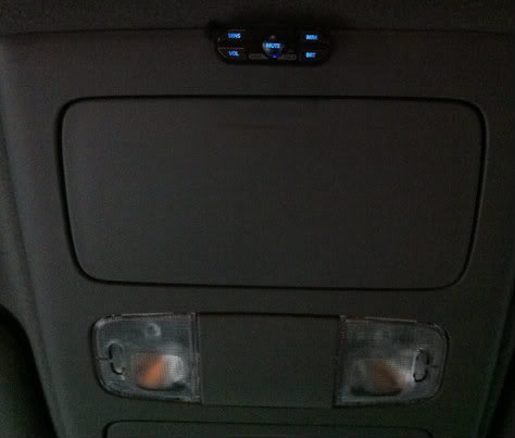

    Question! What is that bar in between your clock and the A/C controls? The one with the switch and 4 white lights?

    Nevermind, I am a dumb dumb. Its the flyzeye thingy right? I though it might have been a hidden radar detector switch or something.

    it is flyzeye :)
    radar control is on the overhead panel (9500ci)

    Nice install B737! Looks really good! I hope to get mine in this weekend.
    I prefer the Flat Black! I am not a Bling Bling type person. Not too big on chrome either!
