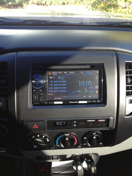

    Here is my head unit, Pioneer AVH-P3400BH. The Scosche kit in flat black worked great, glad since I paid $60 for plastic. I have a 2012 standard cab base non-trd 4x4, only two speakers left and right front door. I added Pioneer 3 way TS-X150s behind the seat, space is limited. No sub, just wanted a well rounded sound. The three ways work well and sound good in a small space. Still need to run the speaker wire through the carpet.

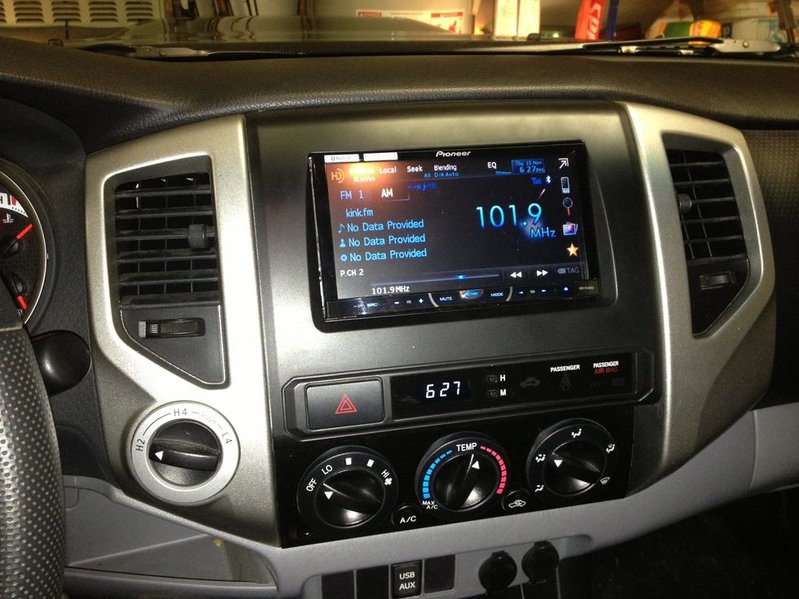

    Install done. Removing factory bezel from dash was a lot harder than removing scosche unit.
    First mistake - mounting brackets to head unit instead of to the scosche dash kit first. Prevented head unit from sitting far enough forward, much confusion.
    Second mistake - somehow 3 of 4 screws cracked the Scosche dash trim when screwing in. Dunno why, dunno how - made sure they were straight, went slow, from directly ontop. Didn't overtighten. They still hold strong, but when you hear the crack - I can't imagine it's preferred.
    Third - included trim around double din unit still never fit around the headunit and between the scosche screw terminals on back of trim. I had a large gap beneath unit, found some black window air conditioner spongey foam to stuff in there and trim to fit.
    Fourth - dash illumination will not control pioneer avh1400dvd. Screw it.
    Fifth - removing the stock clock sucks. I got it popped mostly free and learned there was a screw somewhere beneath stock radio. Tried to remove stock radio from stock trim, there were clips and some rivet things. I unclipped everything and tugged, no dice. Broke clock out of factory radio bezel, broke some wimpy trim piece in process that was not required with scosche install. Whatever.
    Conclusion: Should have been drinking the entire time during the install. My caveman intuition would have resulted in a more barbaric installation, same results, less time invested.
    Sounds F'N awesome for stock speakers. Did parking brake relay mod, mainly because I had the relay AND didn't want to even fuss with parking brake in the dark. The instructions for that part are horse shit, no way was I going to disassemble more of my dash for a stupid parking brake. Took ten mins to wire up the spoof, haven't tested with DVD and likely never will but followed instructions online with standard radiosack relay (85/86/87/30, part number 275-001)
    Thought about leaving pigtail for remote on for subwoofer amplifier, my next planned mod. Tested on stock speakers before pushing everything in.. Sounds so much better. When I install my component system i'm sure it'll be adequate, skip the problems of sub install in reg cab (and save $!)
    Closing notes: Remember to plug everything in. I put my AC/heat knob panel back in before putting those 4 bolts in. Derp. Took back out, put four bolts in. Realized I forgot to plug in clock/flashers plug in. Doubletriplequadruplederp, had to remove everything and hook up. I don't even smoke weed anymore. Shit.
    Goodluck. Scosche kit looks great, headunit mentioned looks tits if you use some foam behind the unit. Shitty Christmas eve with a great conclusion. 1.75L Sailor Jerry at hand, will wake up tomorrow and think Santa installed it!
