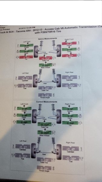

    I had this TSB done. First time around they installed the springs and steering wheel damper. I returned it and said nothing has changed. If anything it now added vibrations while slowing down. from 60-40km/h.
    Whats weird this time around he didnt write on the service report that I'm complaining about the TSB not working. They just went ahead and completed the original TSB. By changing the transmission mounts. What do you guys think, should I ask for the proper writing or wont make a difference in the long run. Say if this Ever went to arbitration or I go back asking for a newer TSB if Toyota ever releases one.
    He included the measurements they took on various parts. Means nothing to me. I swear these guys don't take things for road tests. There just stuck in there little box doing what the paperwork ses. No real world applications to what there saying or doing. Telling me things like dirt will make the driveshaft vibrate. :mad:
    I've done what I can to push this issue with this dealer, now I will be reporting everything to the 1-800 number and routinely checking back here for any progress. Because I cant debate something with people when it feels like debating creationism with evangelical christians.

    Dan, when I click on your picture thumbnail it says, "Invalid Attachment specified". Maybe it's just me?
    ETA: Or maybe you're fixing it since the thumbnail's gone now...

    caught me fixing it. Should work now.

    That's your alignment sheet which I think looks normal. Keep on them about the vibrations.
