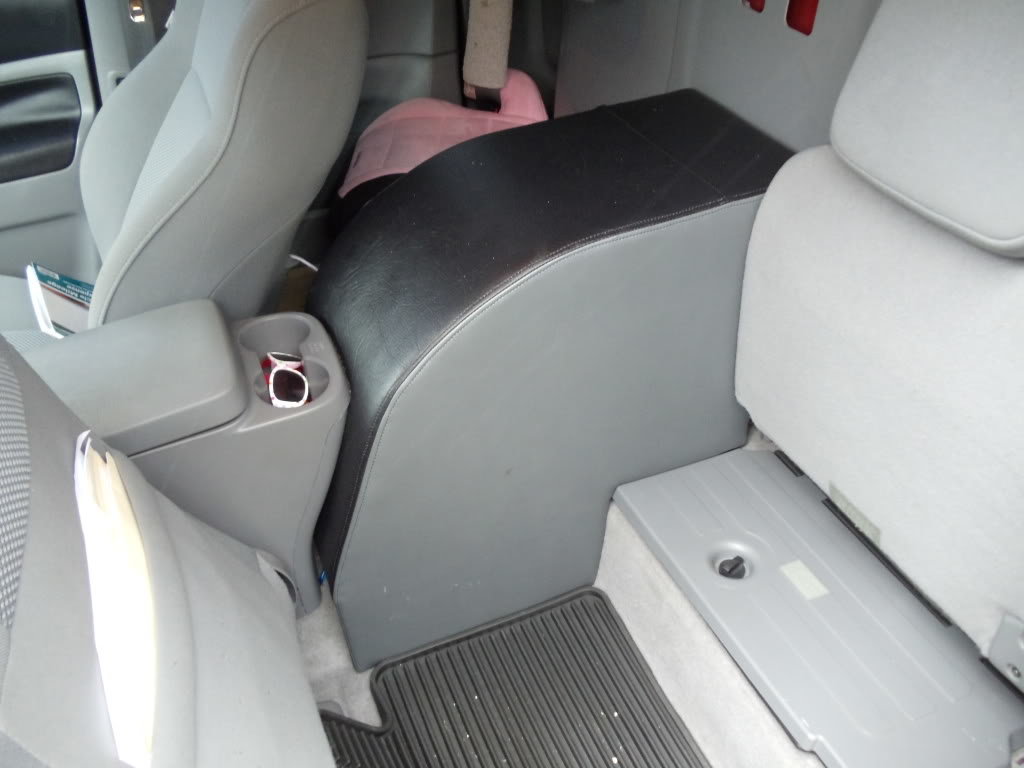

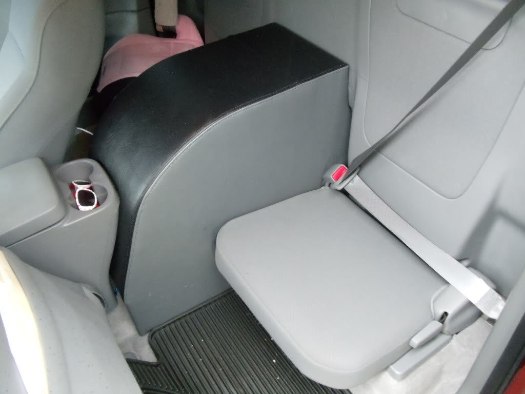

    If you don't mind taking the factory sub out then get a box made like this.
