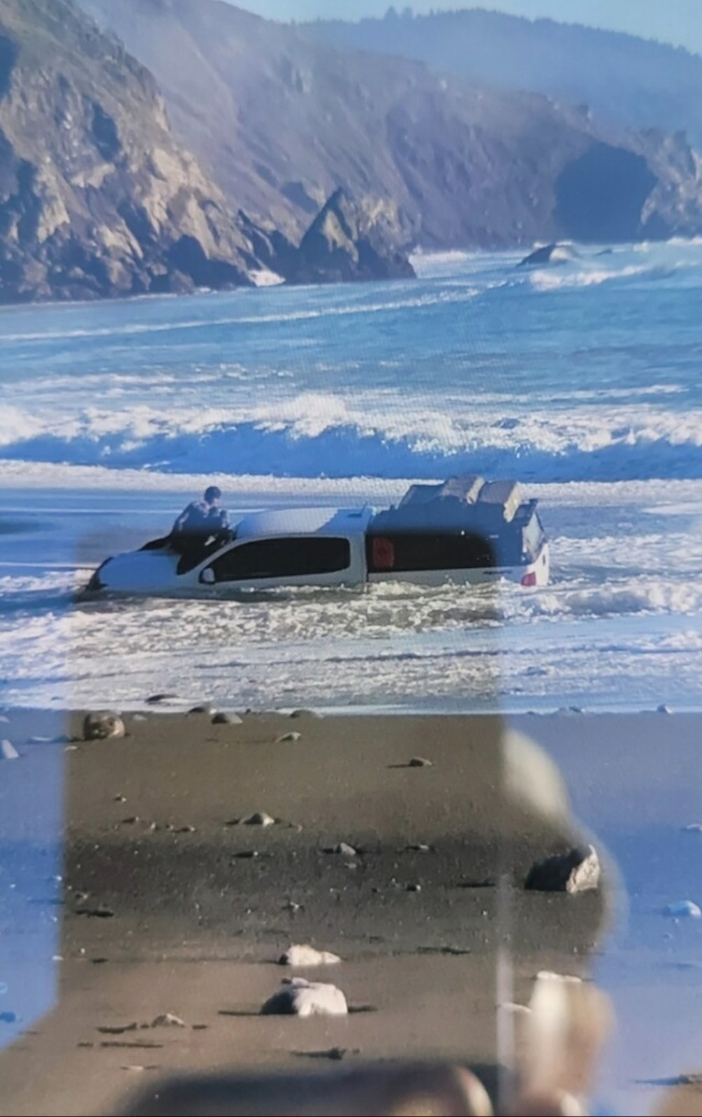

    I may be wrong but that salt prob got deposited everywhere and may take awhile to start wreaking havoc

    I don’t know how you determined is wasn’t hydro locked, and I’m not trying to argue with you, and looking at the picture I still thinking hydrolock. When you got stuck in the water did you turn the engine off while it was still running or did the engine die? If it was still running and you turned it off then possibly not hydrolock. If it died without you turning it off then likely hydrolock.

    Turned it off as soon as I was stuck, and the. Pulled all spark plugs before cranking to make sure no water was in the cylinders.

    Thank you, I hope I figure it out. I honestly think the alternator might have cooked itself. But who knows. Going bit by bit until it’s right

    Crazy part is that it didn’t start that deep. As the water flowed under the truck it sank more and more til it was sitting on the bumpers. Whoops lol. Luckily I have a few rigs

    Pull the drive belt.
    Crank the truck. If the noise goes away, spin the bearings on each component.
    If the noise doesn’t go way. You’re in for some work.
    Also, the crank sensor is not easy to get to.
    Best I remember it’s down by and behind the ac compressor.
    You “might” get lucky and get to the connector. But it’s still not going to be easy.

    Sorry about truck. Hopefully there's not a bunch of salt damage that you'll end up chasing. I'd pull the serp belt and spin the alternator. I wouldn't be surprised if it has a bunch of sand and junk in it.
    Was the ignition underwater? Not sure what would make that act up if it wasn't so it may be unrelated and just fluke timing.
