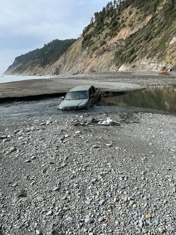

    Thanks for being so helpful. I’m just gonna break basically everything down and start from the bottom up. I don’t think I have any other choice

    I think that's the only choice. Every single electrical connector... With a visual inspection and heavy dose of something like DeoxIt D5 in each and every one.
    https://www.amazon.com/gp/product/B00006LVEU/?th=1
    From there people on here will be able to help you chase down specific issues.
    Looking at your picture again, I would definitely suspect gravel in anything that was under the water line. Alternator, bell housing, brake drums, etc.

    You have problems. Even brackish water is going to ruin your entire electrical system. Oxidation will corrode every piece of bare metal. You will have nagging electrical problems until you get rid of it.
    If we did that in Baja back in the day, we'd have taken everything and driven away.

    If you got saltwater in the bearings of the pulleys or rotating components of the alternator, they’ll rust out. It’s not an expensive fix - just a time and effort situation.
    You can also crank it over by hand with a big ratchet or breaker bar on the crank pulley bolt and see if you can hear something.

    Water that deep is considered a total loss for good reason if it's insured they will junk it.

    Salt water in the wiring will eventually kill it.
    May take a while, but it will.

    Not trying too be negative,but 2 hrs in water up to the glove box with these electric all over trucks is usually a truck killer.

    grinding when starting could be the flex plate broke?
    Salt water isnt fun, i sunk my 88 in fresh water and killed the ECU in a quarry. I was lucky to clean cab and ECU well and covered under warranty.
