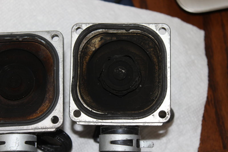

  18. Sep 21, 2015 at 2:32 PM
    #38
    jaybird222
    jaybird222 New Member
    Sep 21, 2015
    #164820
    3
    Same thing happening to my 2012 with 51K miles. It is summer here in Georgia and it hasn't rained in over a week. Garage kept, no reason water could have gotten in except for condensation. Pulled the valves and there is water in the system. The rubber pieces on the underside of the valves are falling apart. Definitely a design flaw.
    Toyota needs to recall these for the Tacoma. They did it for the Tundra, they need to do it for the Tacoma too. This is my second Tacoma, and my fourth new Toyota in the past 10 years. If I have to replace these every couple of years, I'll have to start looking at F150's. Hope the same part is not on my 2014 Avalon.
  19. Apr 20, 2016 at 4:54 PM
    #39
    jaybird222
    Sep 21, 2015
    #164820
    3
    I hope this will help others. I removed my valves and cleaned them with carb cleaner and reinstalled. I have driven it over 500 miles since without the warning light and without the stalling. You may want to try this before spending over a thousand bucks at the dealer!!!!!
  20. Apr 21, 2016 at 4:13 AM
    #40
    Alloutdrs1
    Alloutdrs1 Well-Known Member
    Feb 28, 2012
    #73780
    1,164
    Andrew
    Virginia Beach, VA
    12' Mag gray Doublecab 4x4
    Distinct Offroad light bar, Rigid E-series and amber duallys, Leer 100xq, Oem roof rack, Oem bed mat, Bullculla trailer plug relocate bracket, Rear diff vent mod, front mud flap chop, Color matched Grille w/Andres devil horns, Wet okoles and weathertechs
    That might work if they valves don't look like the picture above. When mine failed my rear most valve looked exactly like the one in the picture posted above. The valves can be had for $400-$500 with some searching and are very simple to repair, just aggravating we are having this issue on such low milage trucks.
