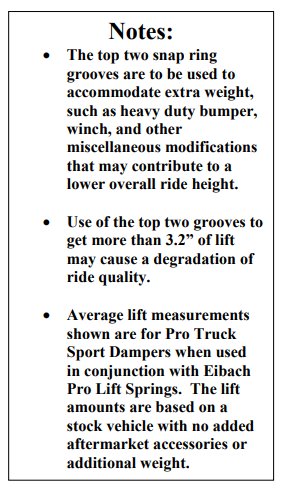

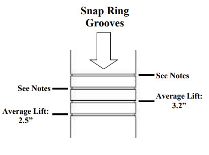

    Hello, Mark. Can you confirm the notch setting measurements achieved?

    From their website

    Thank you for that. So when they say 2 1/2 average I would assume they mean for the 4X4. The prerunner like myself would expect more?

    I have a Prerunner with this lift kit and I got a 2.5in lift in the front.

    Hey partner. One quick question. Which setting are you on that you got the 2 1/2 inches the lowest or second from the bottom?

    I'm on the lowest. Don't forget to add a 1/4 top spacer on the driver side to accommodate the taco lean.

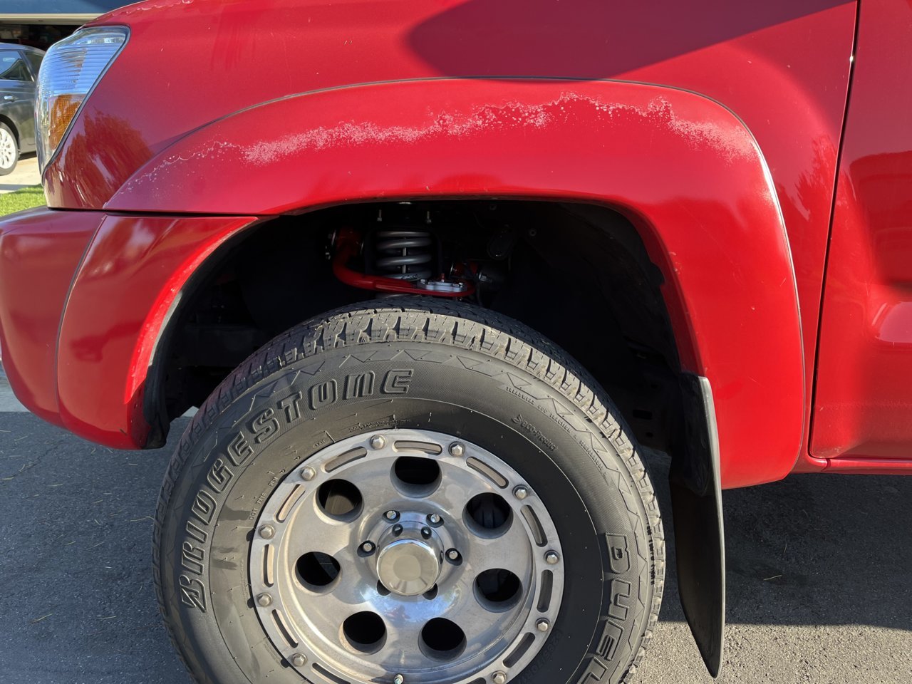

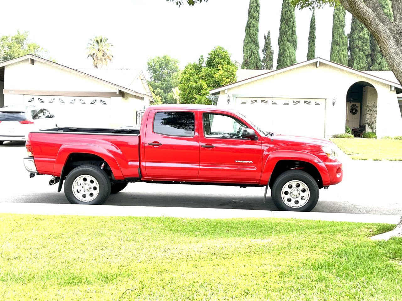

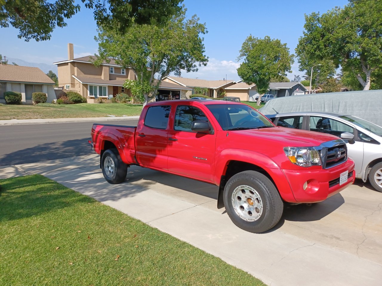

    Hi everyone, just install the Eibach Pro-Truck Lift (Stage 1 1st clip setting for 2.5") with JBA UCAs. Any recommendations on a Tire & Wheel combo?
    **The truck came with P-265/70/17 but will change the current tire & wheel set up**.
    BEFORE:
    AFTER:
