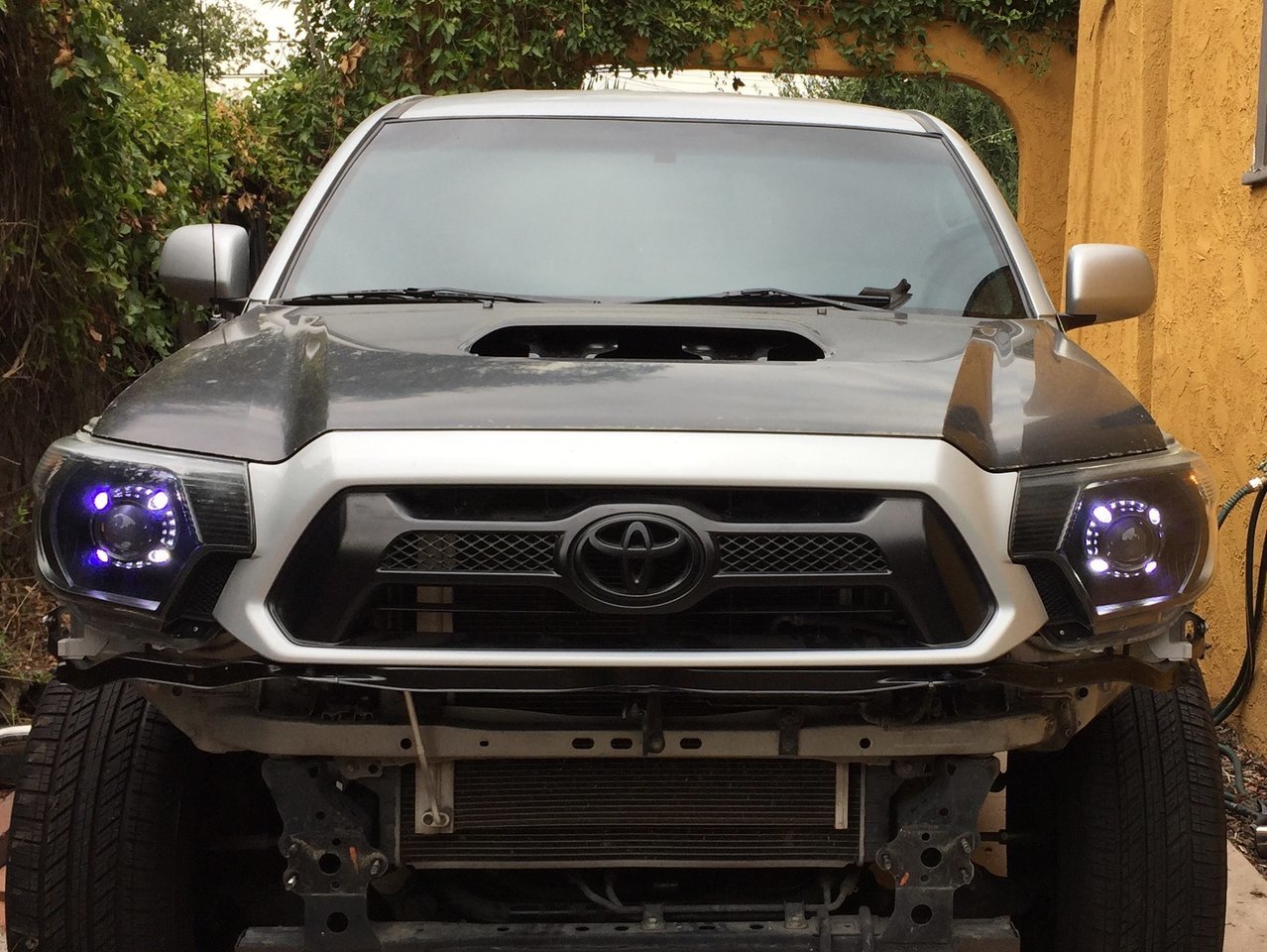

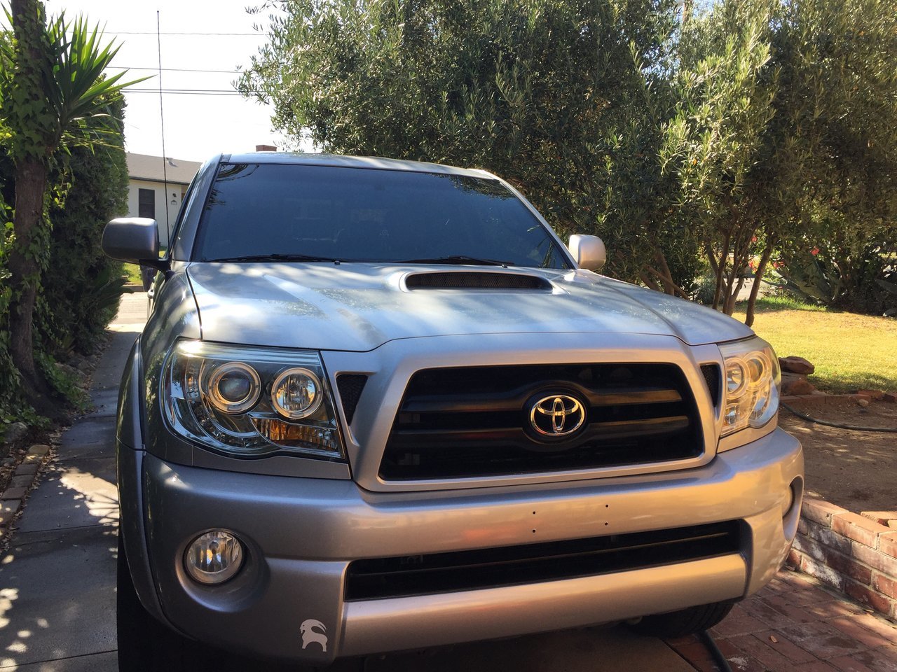

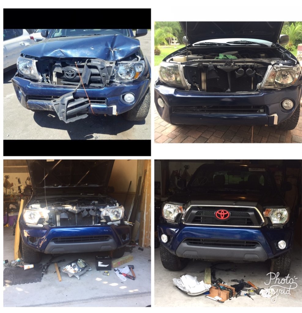

    Thought I'd cross post this.
    Well it's been a while, but I thought I'd update, got the conversion all done (skid isn't installed in the pic though), I did find a few little things I didn't see mentioned on the other threads.
    1 you need two brackets not mentioned often, they are the plastic brackets that hold the front lower part of the head lights, you also be a little bracket, screw and nylon nut that the front part of the filler below the headlight clips into (one for each side)
    2 the plugs for the fogs ARE NOT THE SAME, I got the LED projectors for the 2015, ended up getting some weather proof connectors and using them (solder and crimp) instead of the OEM
    3 noticed there are not any fog align instructions, you want to park the truck 25' from a wall, measure the height of the fogs off the ground (24" for me), go to the wall and put a mark 4" below that, so for me it was 20" up, set your cut off to that.
    4 the 4 hood bolts are tapered and center align, you're going to need new non taper bolts (per Toyota hood alignment instructions) to get things looking OEM, also smart to keep a little vial of paint from your hood and bumper to paint the bolt heads after you're squared.
    5, forget ordering ANY brackets by year, every place screws it up, find a new style Tacoma, write down its VIN and use that, for some reason parts people get it right off a VIN but it's like a monkey humping a football when you give them year and model.
    Before
    After (minus TRD skid)
    New wire connector since the pre and post facelift ones are diffrent.
    Aligned

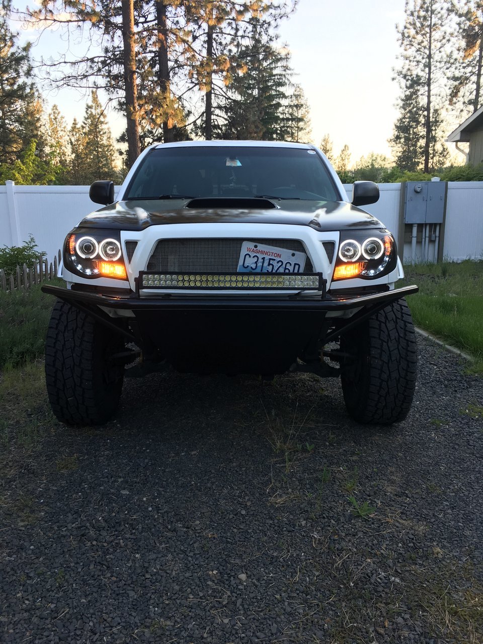

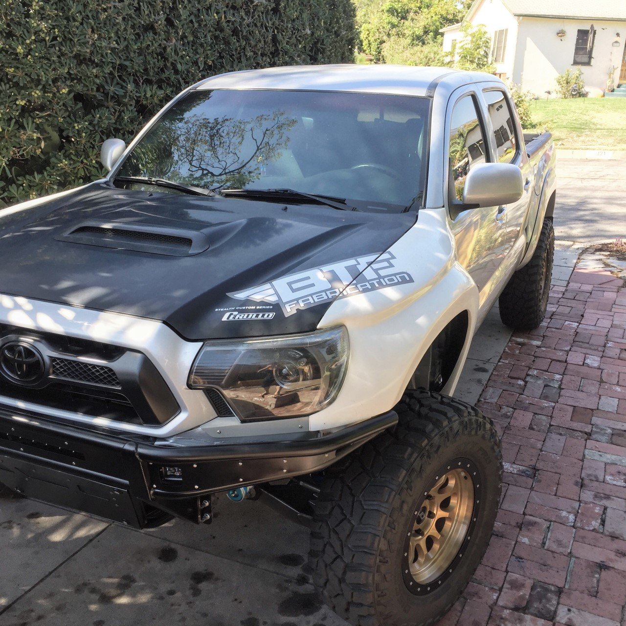

    I am attempting to convert a 2006 single cab with manual to the 2012+ facelift. Here is a pic of the single cab next to my 05 TRD OR with Prinsu Rack. Yep, I am blessed to have two TacomasIMG_4573.jpg

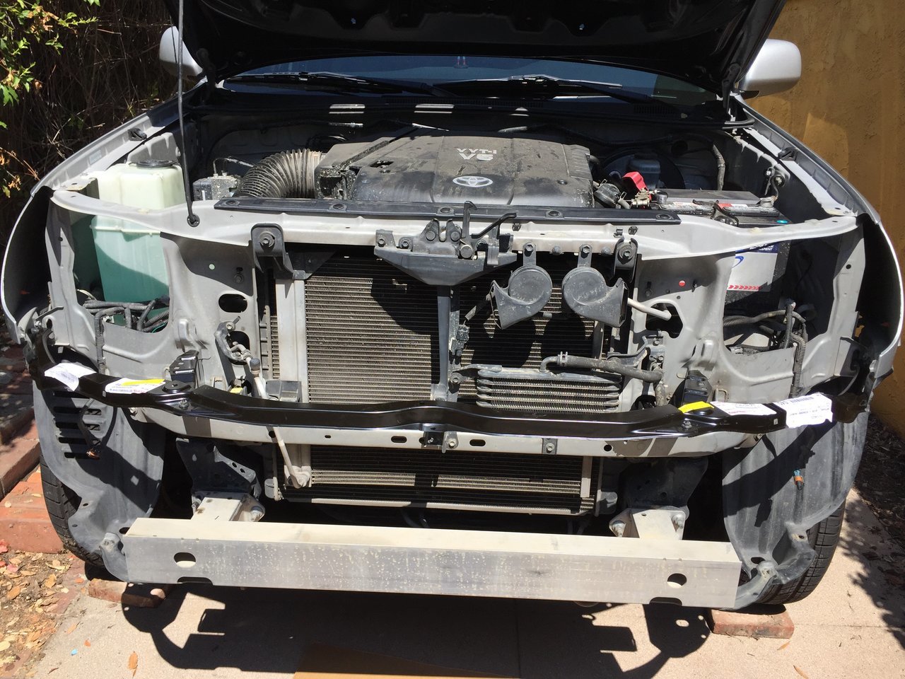

    08 Tacoma DCSB TRD LT/1999 LX 470 on 35s OME/97 FJZ80/11 Tundra Rock Worrior

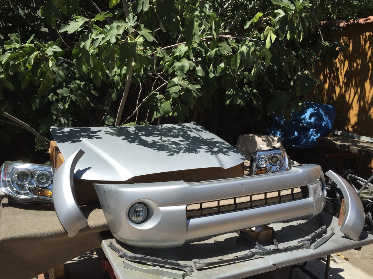

    '12-'15 Facelift. Reto'Headlights. BTF FAB LT 4+ Kings/Deavers. SCS Ray10/CooperSTT.Caliraised
    08 taco frnt end.jpg front end conversion.jpg Face lft with headlight filler tab supports.jpg '08 to '15 Face lift conversion...on the way to Long Travel and custom fab'ed bumper/skids/lights 08 Tacoma front end.jpgteardown.jpg

    Is the hood not the same dimensions on the 05-11 vs the 2012?
    Looking at the pics, it looks like they are very identical.
    Let me know because I've very interested in doing the conversion. Have a 2010 and looking to put on the 2012/13/14 front on it!

    You will need the hood, the grille rises higher above the headlights than a preface lifted truck. Looks similar but not totally identical
    Tacomaboy1[QUOTED] likes this.
  13. Oct 25, 2017 at 12:05 PM
    #233
    miseenplace

    Hood bolts right up and matches body lines-BUT as Oreo Cat says, Grille is different shape and must also be swapped out.
    *As well as frame/support structure below grille, and hood latch mechanism. Let us know if you need a thread for reference.

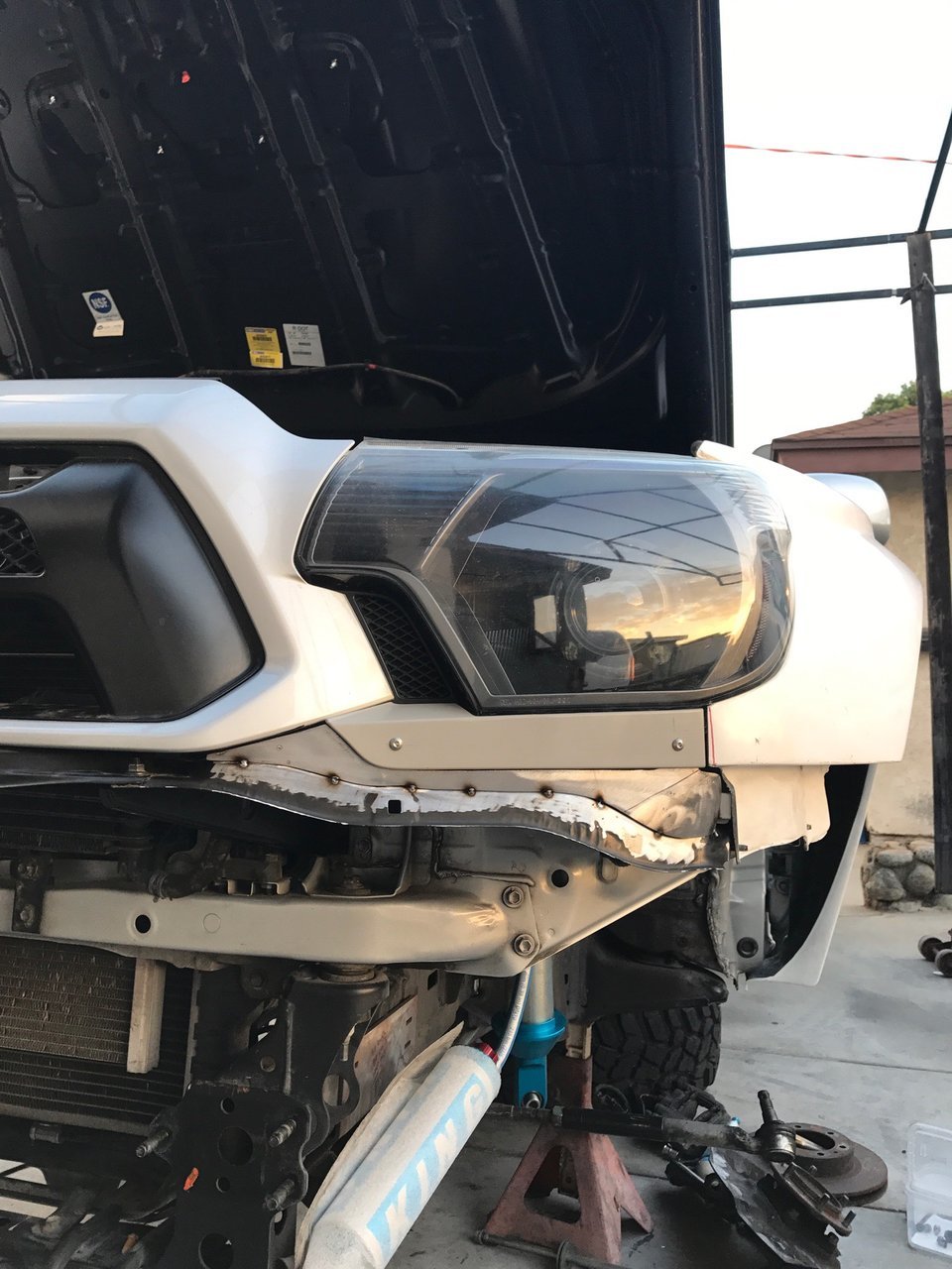

    Actually you do need the subframe 3 piece; as it supports Headlights and Grill. I also had to relocate the vertical support(lower attachment) that sits behind the grille at the bottom, to support the grille-OR ORDER that piece as well.
    Depending on whether or not you want the "headlight filler" pieces, (for fill in-cosmetic) You will have to figure out a solution for these as well...**Only If you are not running fiberglass fenders-IF NOT,this will NOT apply.
    Oreo Cat[QUOTED] likes this.
  17. Oct 25, 2017 at 12:25 PM
    #237
    miseenplace
    miseenplace Well-Known Member
    Aug 17, 2016
    #194887
    236
    Steven
    Pasadena Ca
    Some of the plate bumpers(Pelfrey) have the "ears" to hide that little area under the headlight where it meets the grille...
    We made a piece to fill in on my application

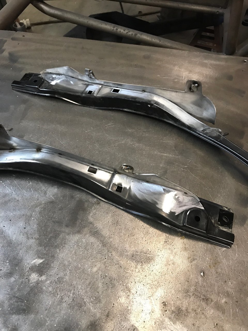

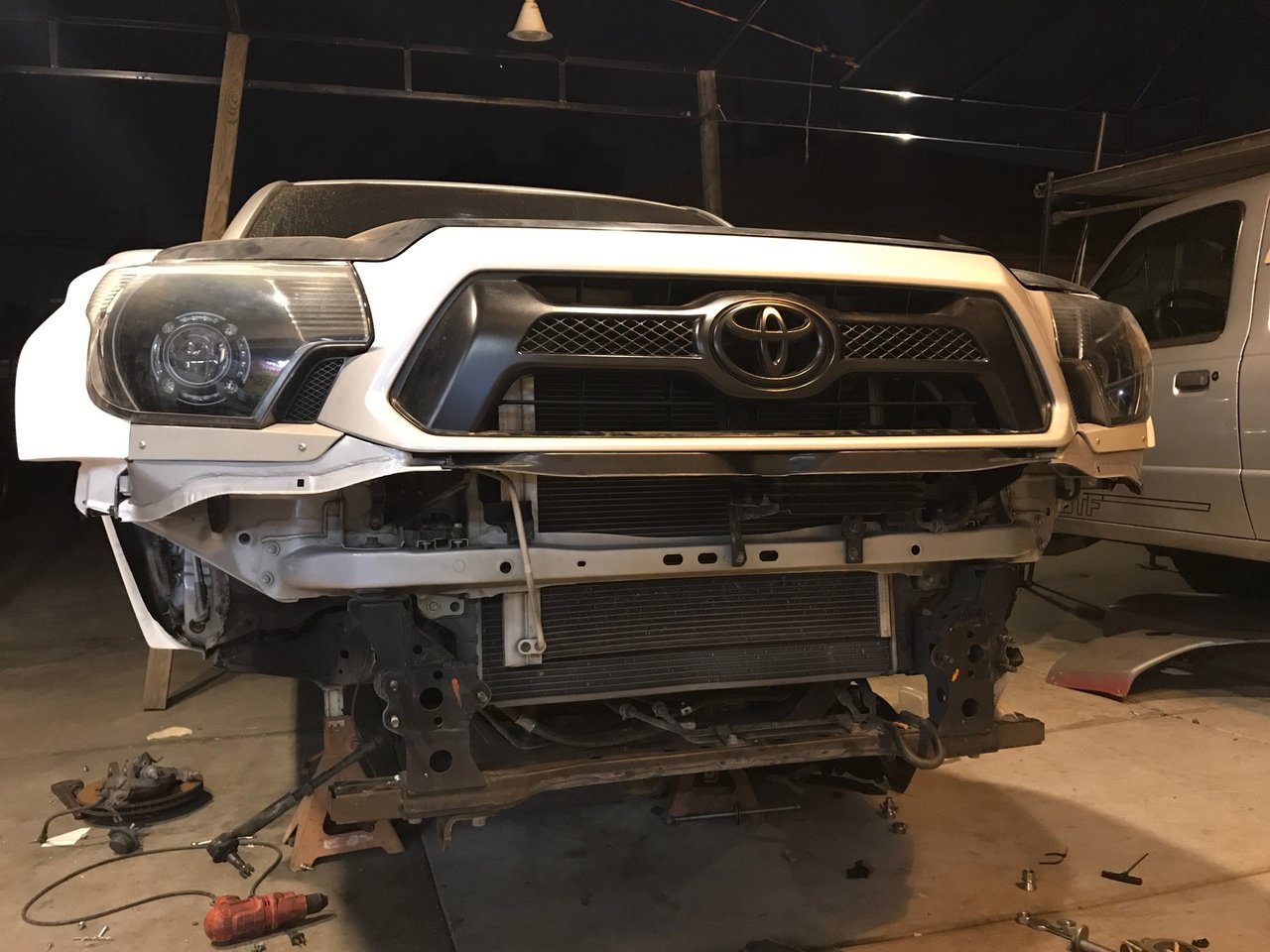

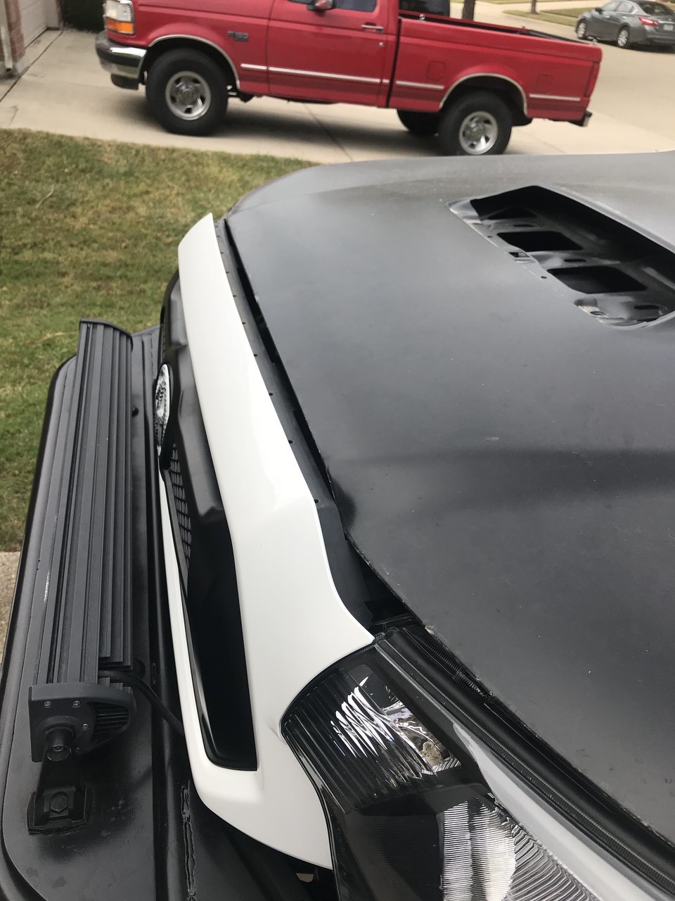

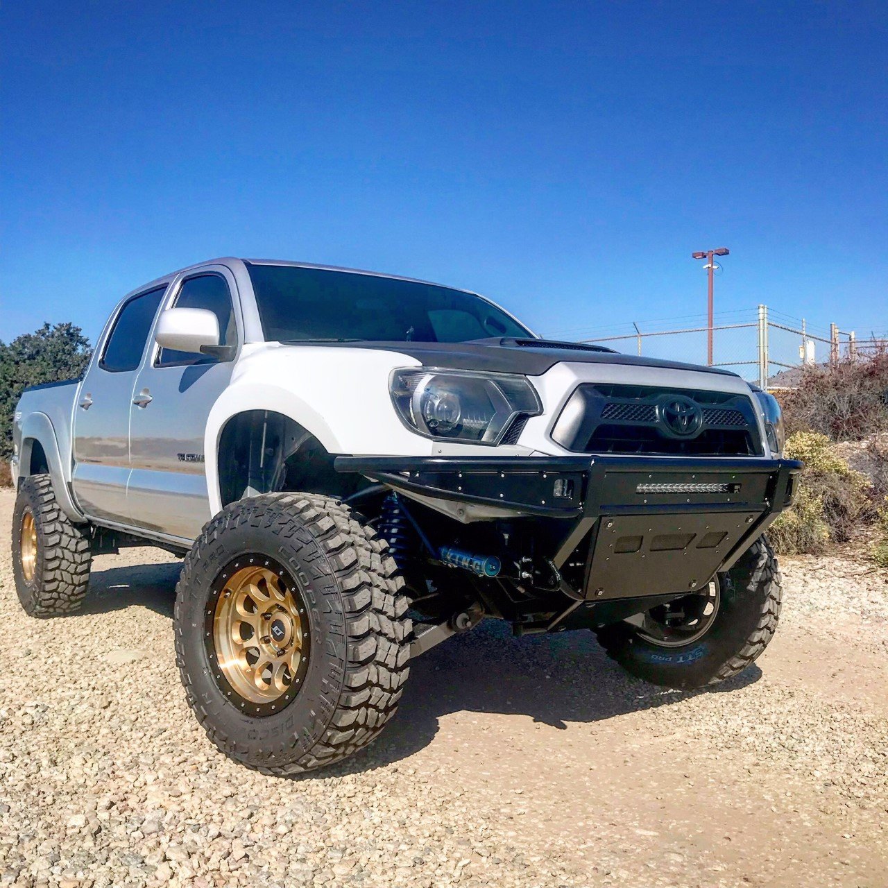

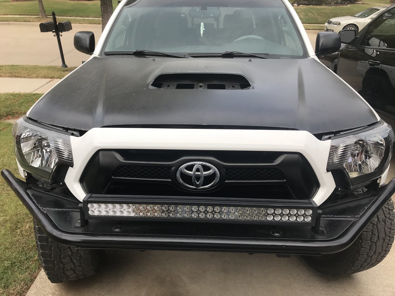

    Here’s my unfinished conversion! I used all 2005-2011 mounting points. I will have to get a 2012-2015 part for the headlight mount so that I can also install the headlight filler. Still need the hood but I’m able to still temporarily run the 2005-2011 hood with a nice little gap.
    Before:
    After:
    01D518A9-86DA-4E23-B152-FCECC6CFA7DE.jpg F749EE1B-DC46-497C-B0EF-8AE8B8C94DD8.jpg
