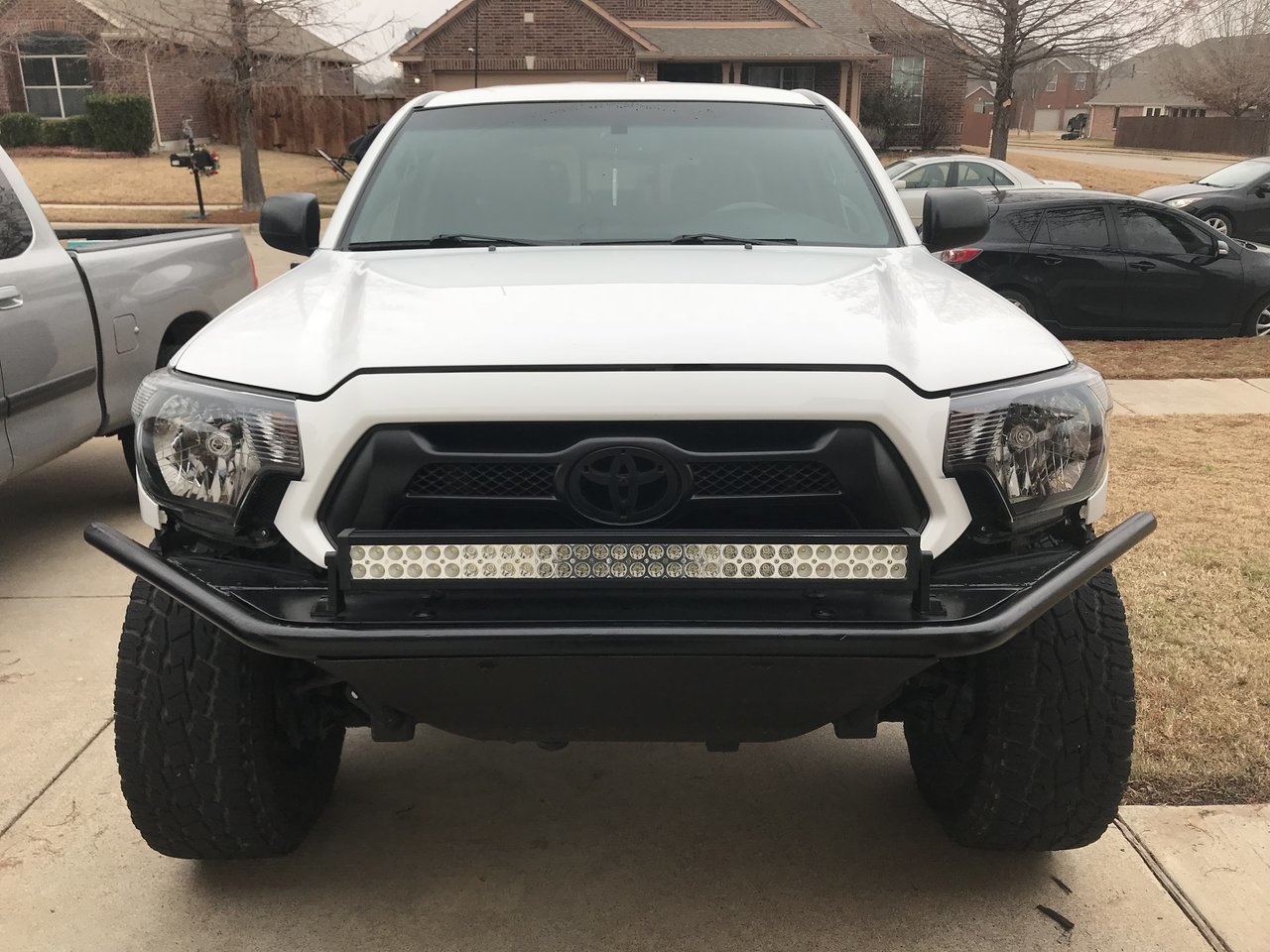

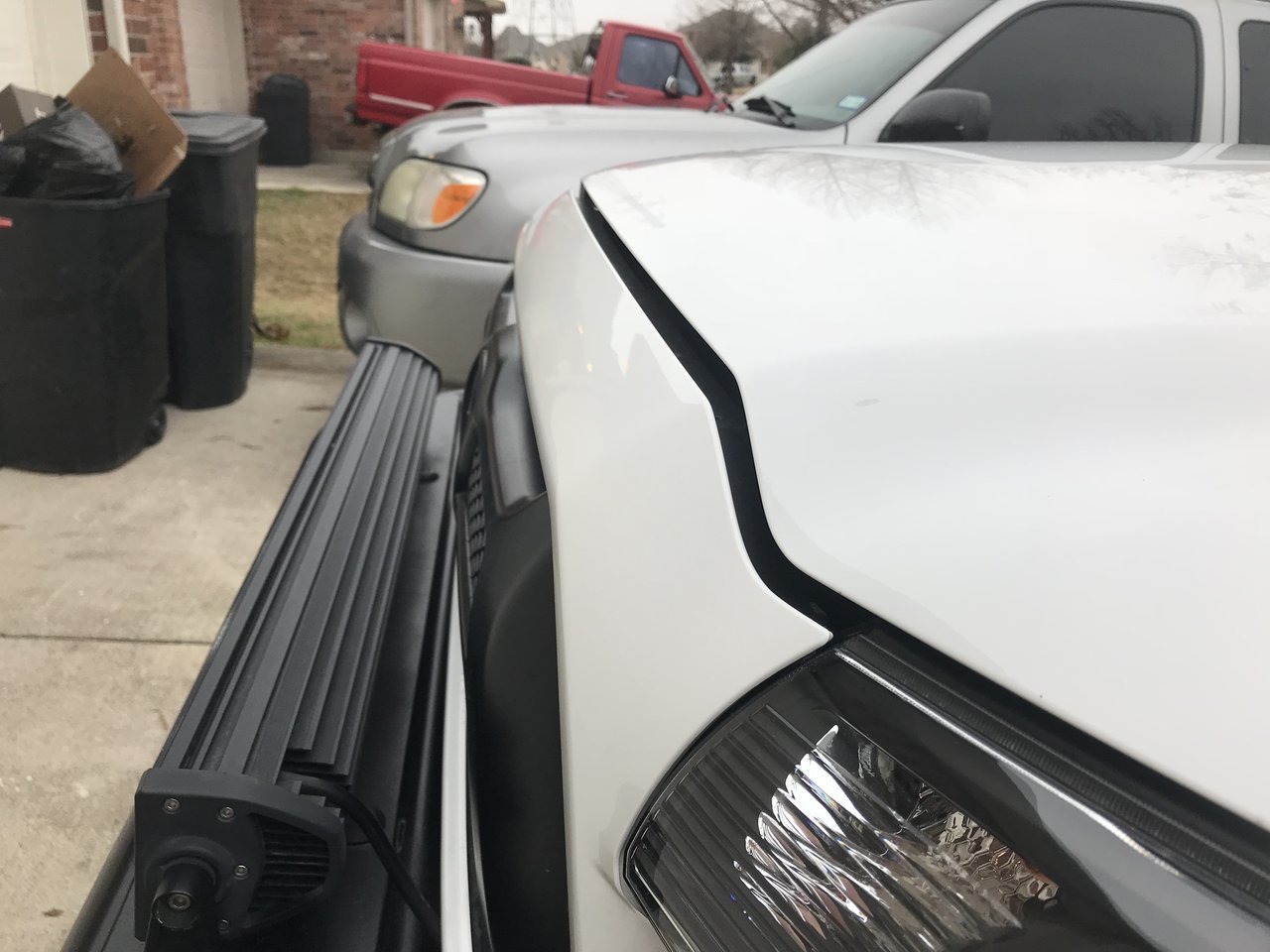

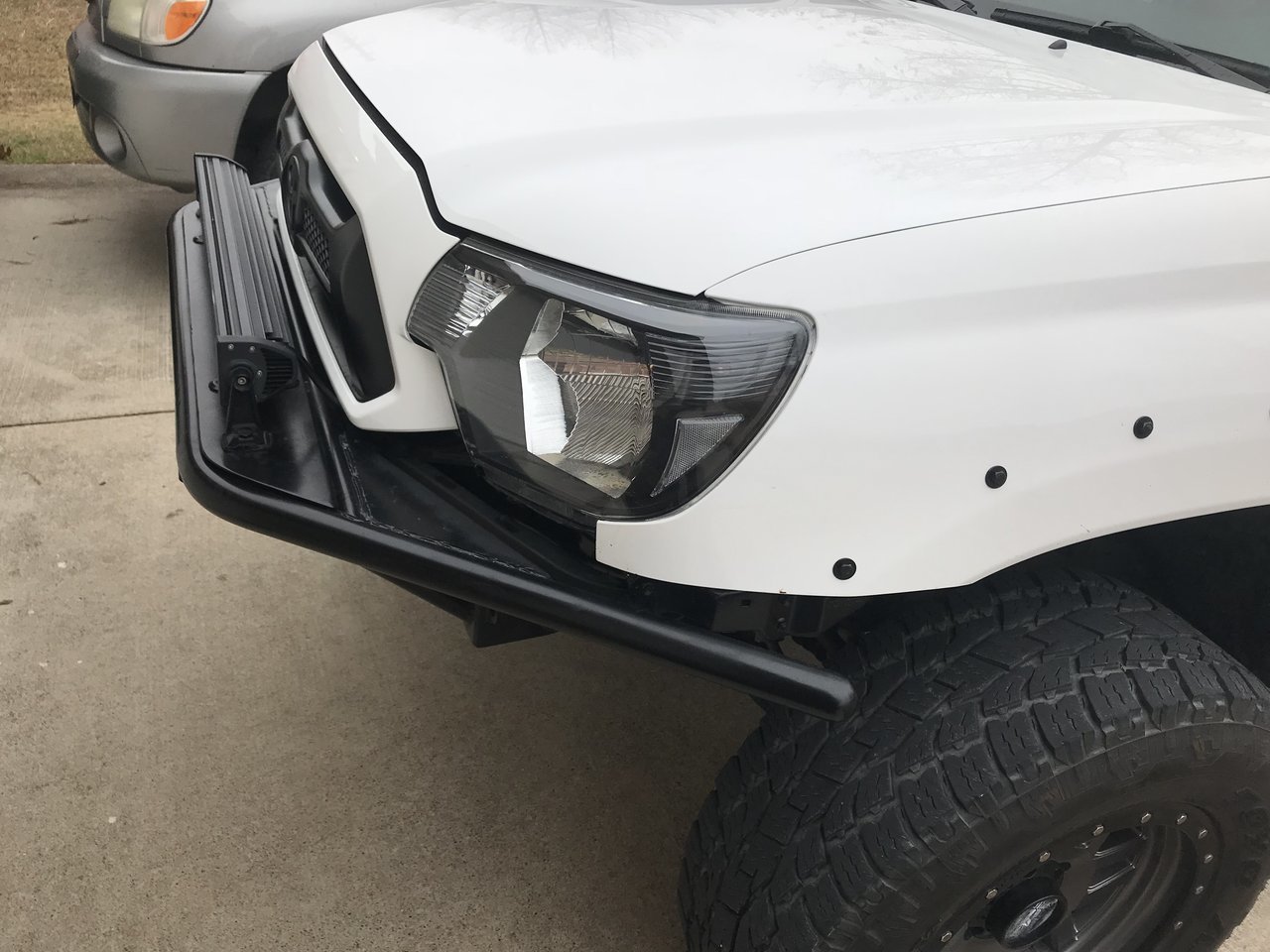

    Ok so finally got my hood and basically finished the conversion minus the filler piece below the headlight which I do have just need a few mounting pieces. My issue is I have a decent gap between the grill and the hood. I adjusted the hood, but to no prevail. It’s looking like I need the grill to come up slightly but not sure how to accomplish that unless I need a new mounting system for the grill which raises higher then what the 2005-2011 grill sat in accordance to the hood. 08C677EF-B513-4995-89A2-A3BEF9A96F63.jpg5188EB20-EEDD-434D-A013-8CE0EACD8A82.jpg 0BD88984-C3D1-4392-A60C-D1A829B104CB.jpg

    How is the bottom secured .I know with stock bumper is secures into bumper . Can you pull bottom of grill forward more, than maybe gap at top closes ?

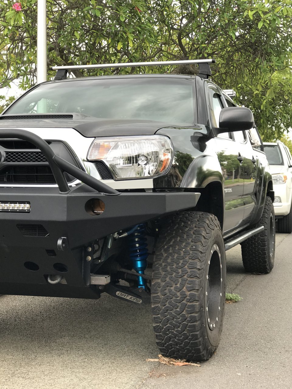

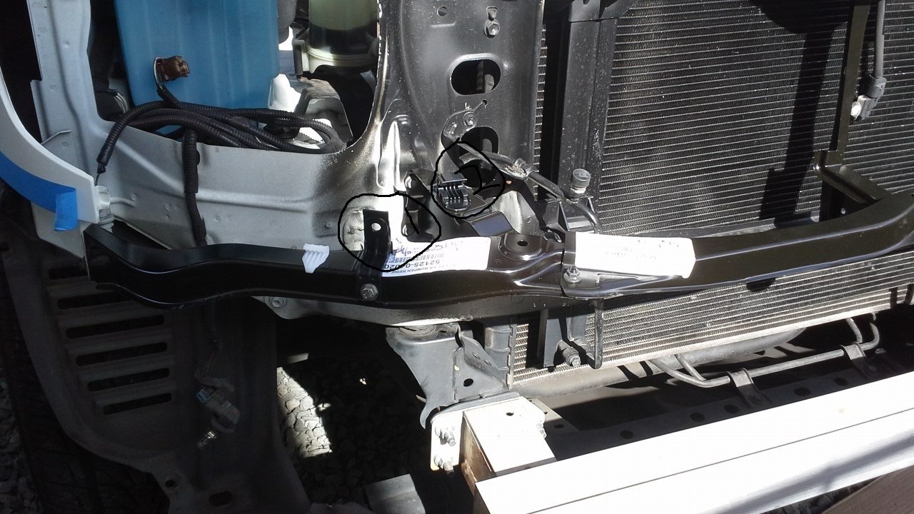

    A few
    Just a matter of remove and replace . 2 to 3 hours easy . Only needed help putting on hood .
    In pic # 1is were bumper filler snaps into #2 is bottom of headlite mount and white plastic clip by #1 is bumper cover slides into .
