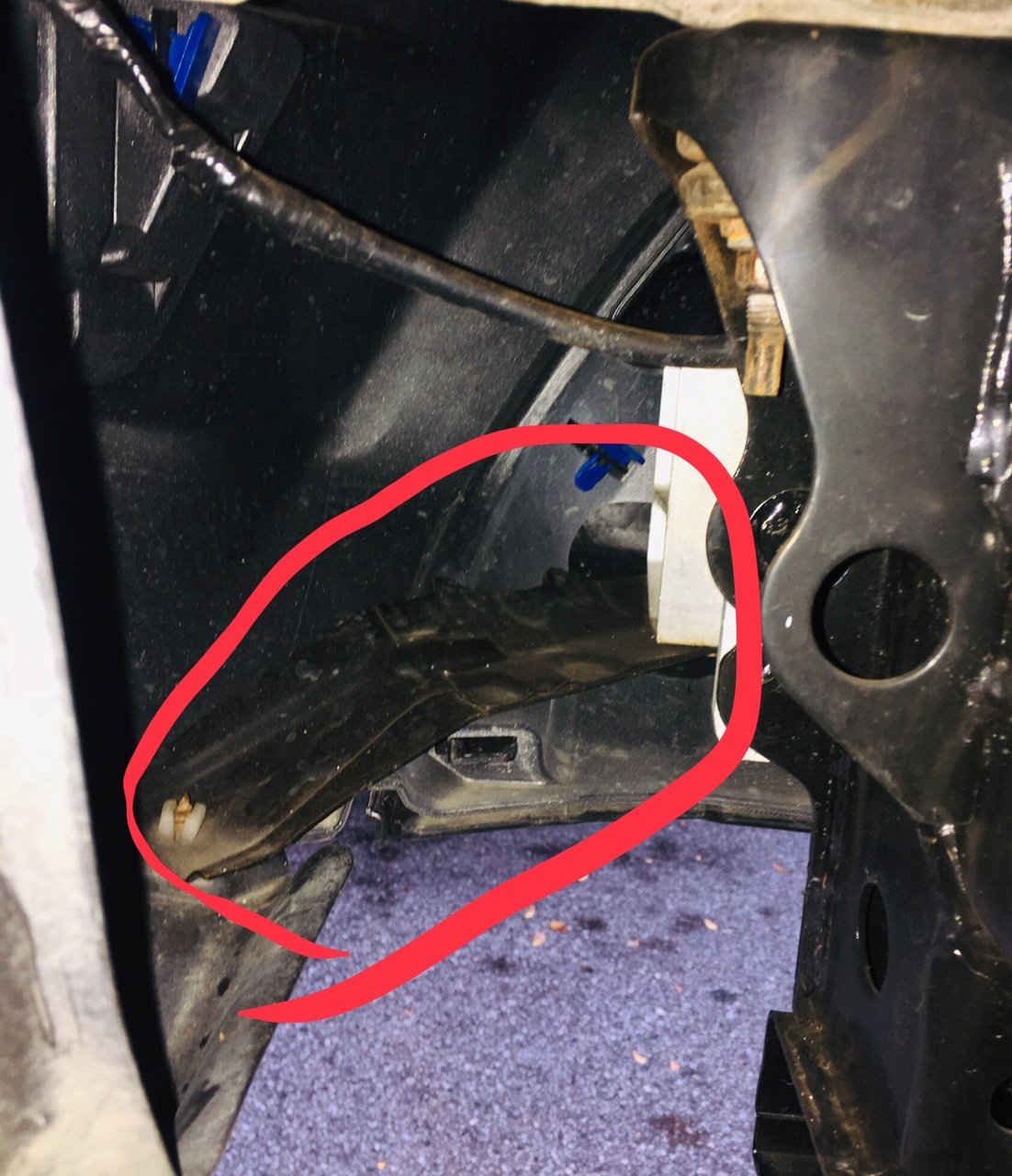

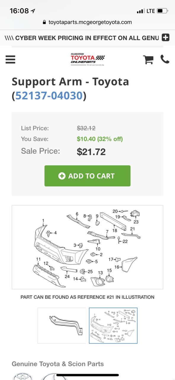

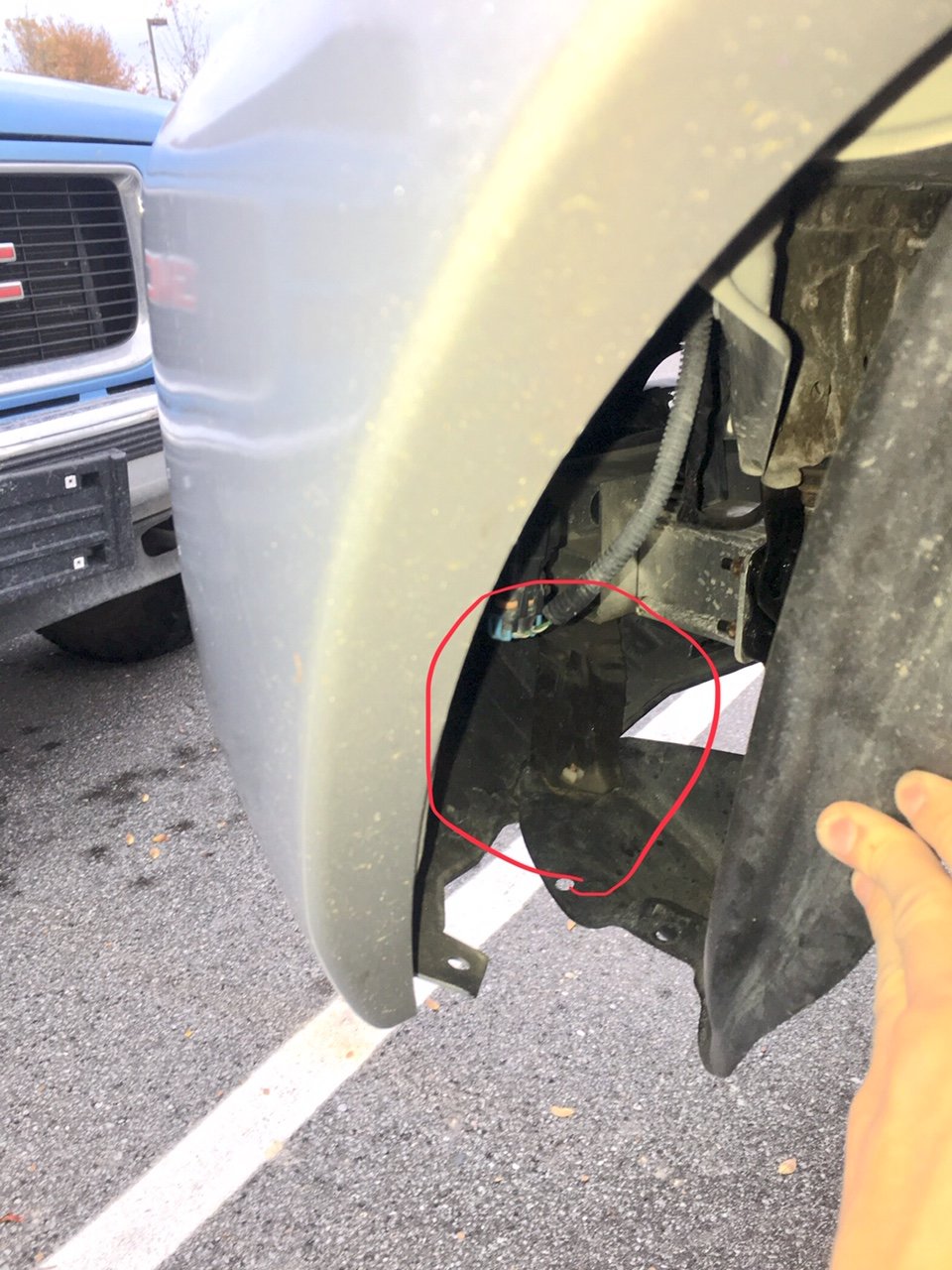

    Do I need piece 21 if I have a 2012 but accidentally got rid of some pieces when putting on my plate bumper? Can anyone show a pic of where piece 21 is actually located on their truck?

    21 is a bracket that holds on the left & right lower portion of the OEM bumper, it attaches from the reinforcement bar to the bumper and wheel liner.
    Here you can see it looking thru my front left wheel liner.

    You should be good .It secures bottom of stock bumper .If you got plate bumper your all good.
    Just read YotaProjects description ...lol Like he said

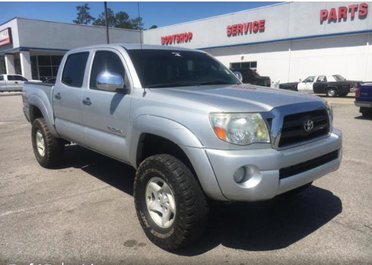

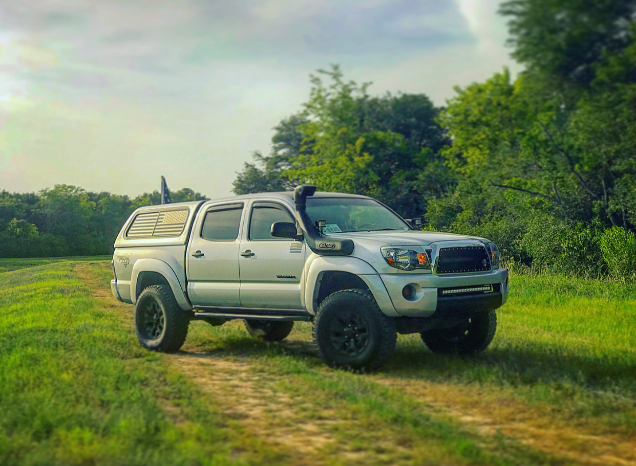

    Props to OP on this thread, I used this exact thread, some research & ebay shopping to do my front end swap :thumbsup:
    BEFORE
    AFTER
