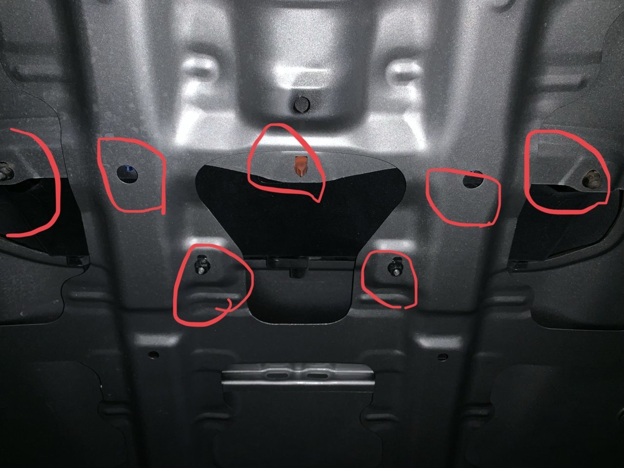

    Here is what I am ordering:
    Aftermarket steel bumper for 12-15 (ATH fab) (already have it)
    Headlights (already have them)
    Headlight filler trim
    Grill (already have it)
    Hood (with scoop and necessary hardware for scoop)
    hood latch and hood latch support
    Do I need these two things If Im using a steel bumper? Kind of hard to see from fiche:
    Thanks 11trd4x4 for the good thread, Ill try and get a pic in here when Im done
  11. Jan 8, 2019 at 5:05 AM
    #311
    Armedine
    Armedine Well-Known Member
    Nov 15, 2017
    #236072
    262
    St George, UT
    2020 TRD Sport 6' 4WD
    Quicksand
    This goes on your center upper bumper bracket support arm (protrudes out away from Radiator).
    If you removed that, you don't need those.
    excorcist[QUOTED] likes this.
  12. Jan 8, 2019 at 5:24 AM
    #312
    YotaProject
    YotaProject Well-Known Member
    Mar 12, 2018
    #247063
    484
    Adrian
    Charleston SC
    Fox Lifted 2007 Taco With Mods Here & There
    You will most likely need both of them, one holds the lower portion of the headlight and one holds the plastic filler that goes under the headlight, I don't know how it would stay in without them. Unless the aftermarket bumper does it differently, It's hard to tell for sure unless you had a pic of your exact bumper already mounted on a truck.
