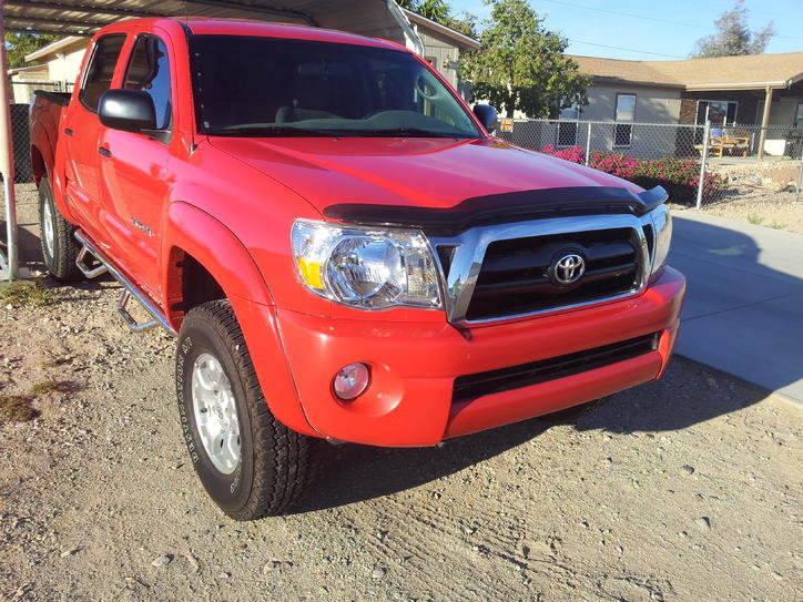

    Hello RG11,
    I'm in the planning stages of this mod. I have found a lot of the parts at RockAuto but I'm also going to look into your suggestions for suppliers.
    If I have any questions, is it still OK to pick your brain.
    By the way, I have a 2006, Pre-Runner. Red. It has a leveling kit on it and some cool nerf bars. I put slightly over sized tires on it to give it a bit more aggressive look. I'll try to attach a picture.
    Hope to be able to get your help as I go along. Thanks.
    Steve

    06 Pre-Runner Quad Cab Rad Red
    2014 nose conversion in Radiant Red, Raceline Raptor wheels w/ 265/75R16's, Go Rhino chrome nerf bars, Pioneer AVH-X3600BHS stereo, leveling kit 2 1/2" and 1", tinted windows, color matched grill, Dynomax Syst-Ultra flow cat-back,
    I personally like the high polished chrome look. Of course my truck is a Pre-Runner, not a 4x4. It doesn't see the off road very often. I like to try to keep it clean shiny. And that's just how I am.
    I know what some will say, why put on a leveling kit and aggressive looking tires then? My choice, my personality. I think the chrome will look good with my bars and wheels. And since we live in Arizona, we can get away with some pretty dark window tint which looks great with the red and chrome.
    Just my 2 cents.
    From the quick research I've done so far, I think it could be done for considerably less than that. Most likely under $1500. That's using mostly aftermarket parts and the necessary OEM stuff.
    Like RG11 said, some parts are best if OEM is used. And I happen to work with a guy who does paint and body. And modifying or fabricating a part or two wouldn't be the end of the world for me.
    So I think I'm going to look further into it. If you folks like, I'll post my results.
    Thanks for listening.
