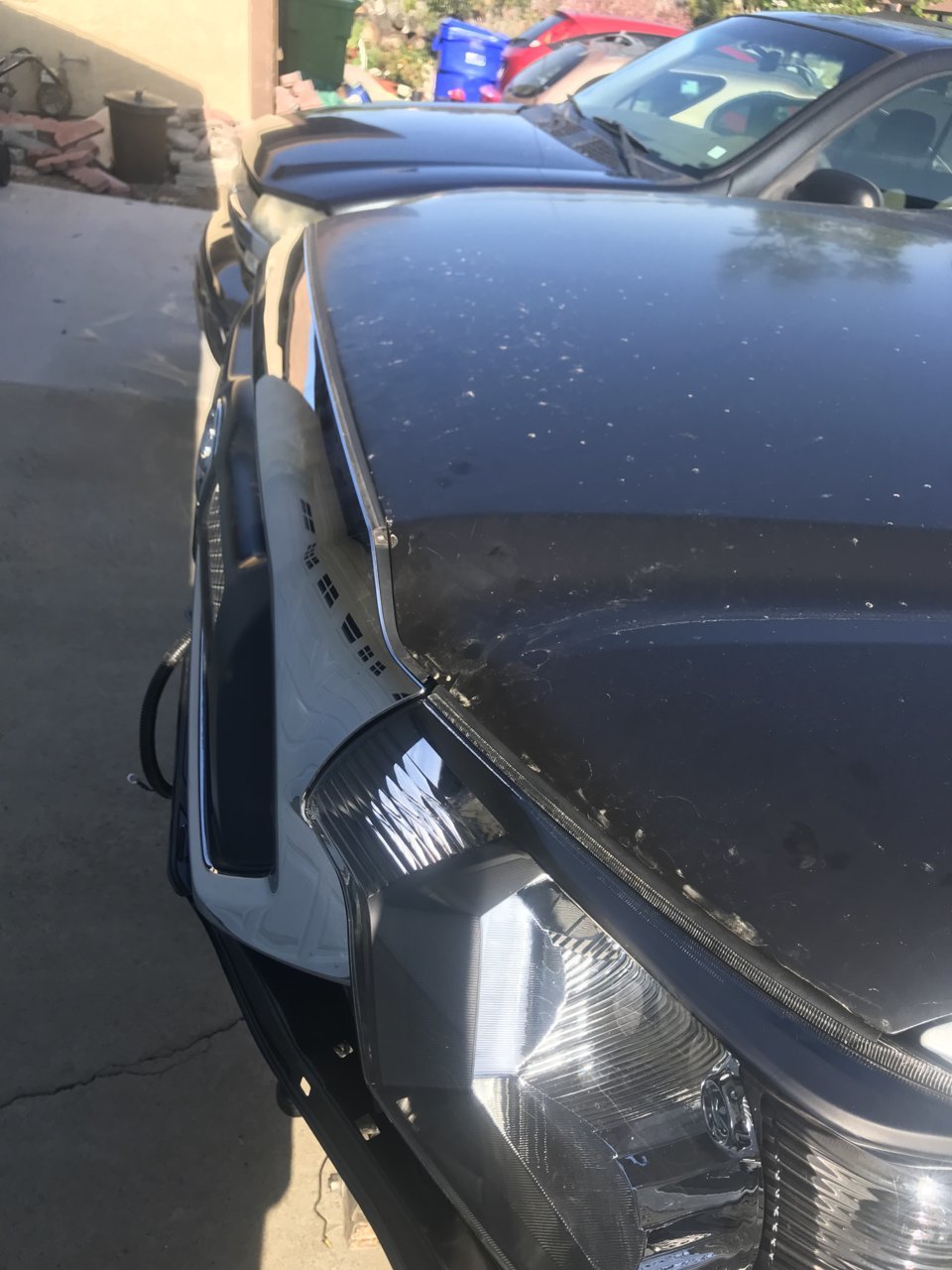

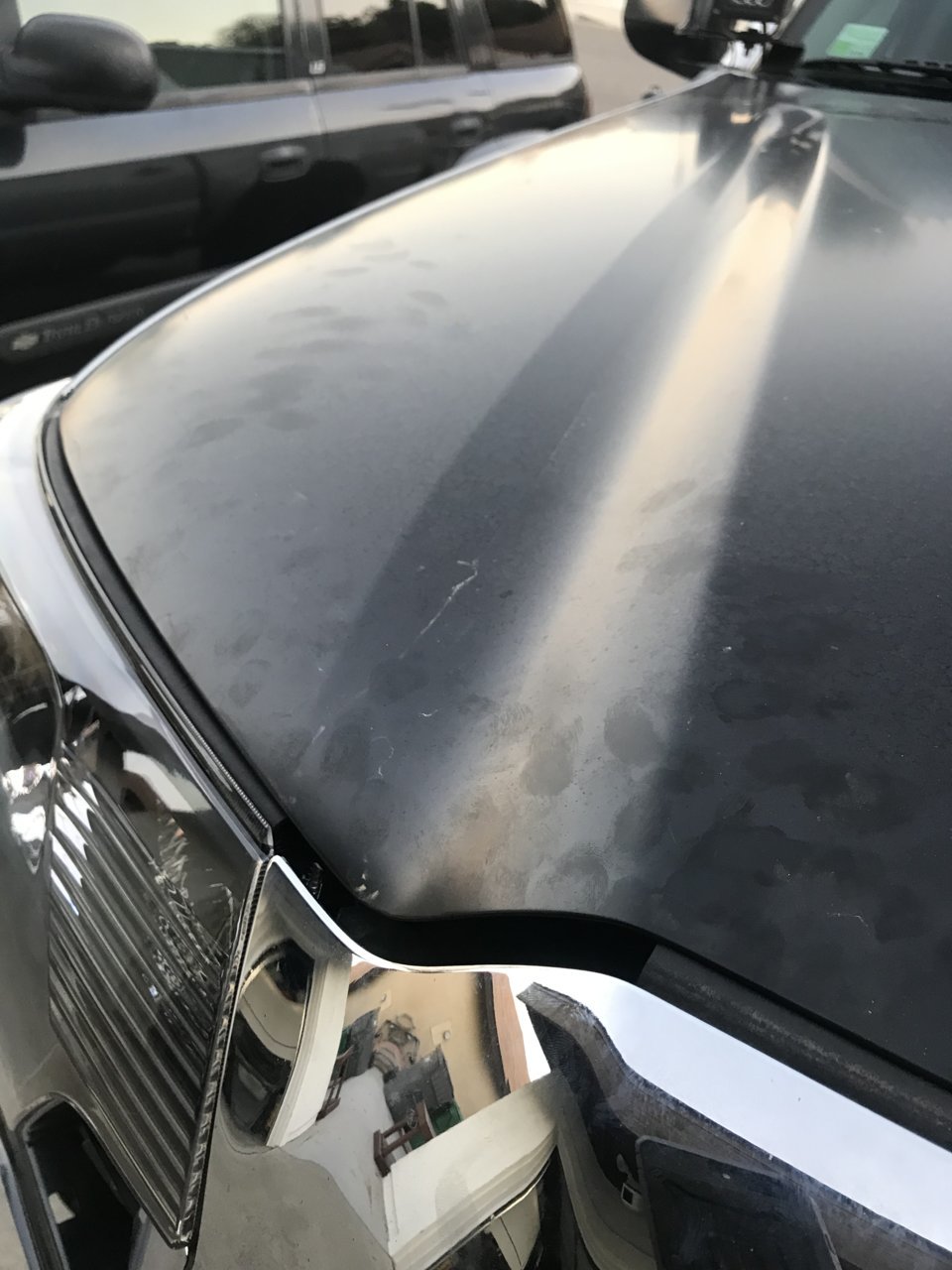

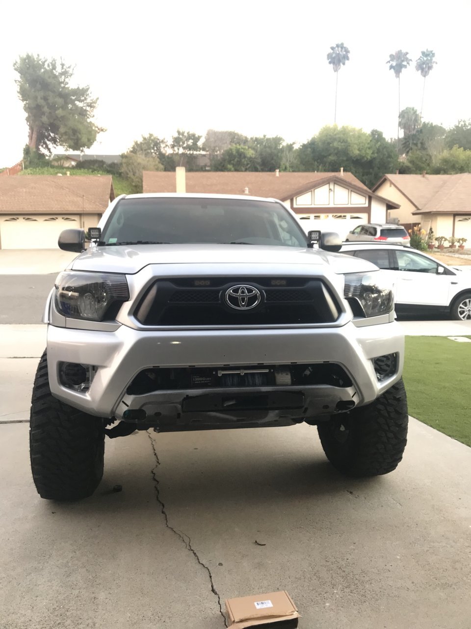

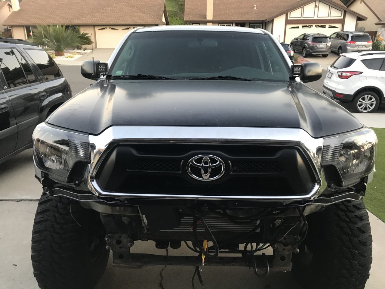

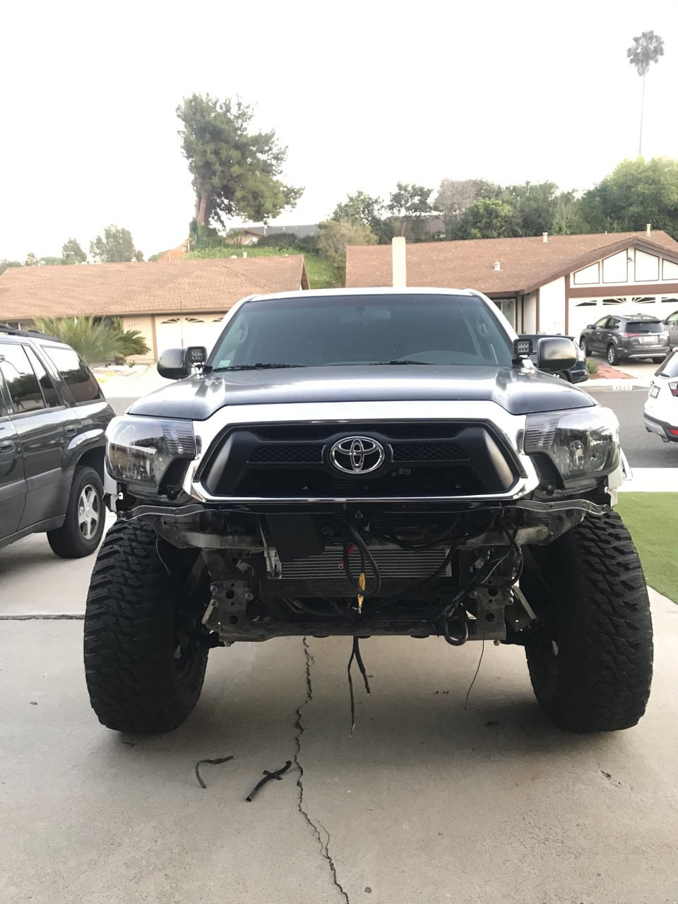

    Anyone else end up with a gap similar to mine?
    It’s not too terrible, but the lack of weatherstrip between the headlight and grill bothers me. The hood cannot slide forward anymore

    Gonna try using regular bolts for the hood instead of the self centering ones.

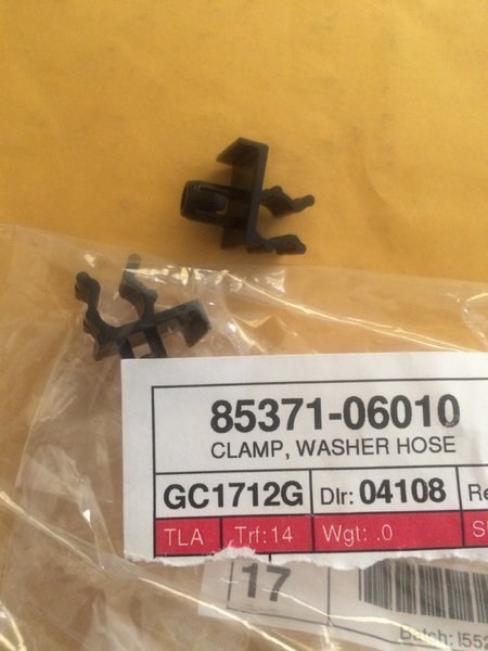

    Anyone know how to remove the clips from the hood that hold the washer hoses down?

    I assume you pinch the underside and push up?

    I can’t get out the ones that just hold the hose to the hood. You back side has no access at all.

    I misread that. I thought about the nozzles. They're most likely gonna snap if you pry them off. I'm sure the replacements are dirt cheap.

    Yup , broke all mine .Used nylon insert to secure but found this part# on here a while ago .

    A few
    Noticed only people with after market bumpers seem to be having problems. Factory bumpers secure lower part of grill. Maybe bottom needs to come out a little to close the gap on top :notsure: .

    Obviously not done yet, but the gap isn’t bad
    Also my fillers and grill are painted with duplicolor
