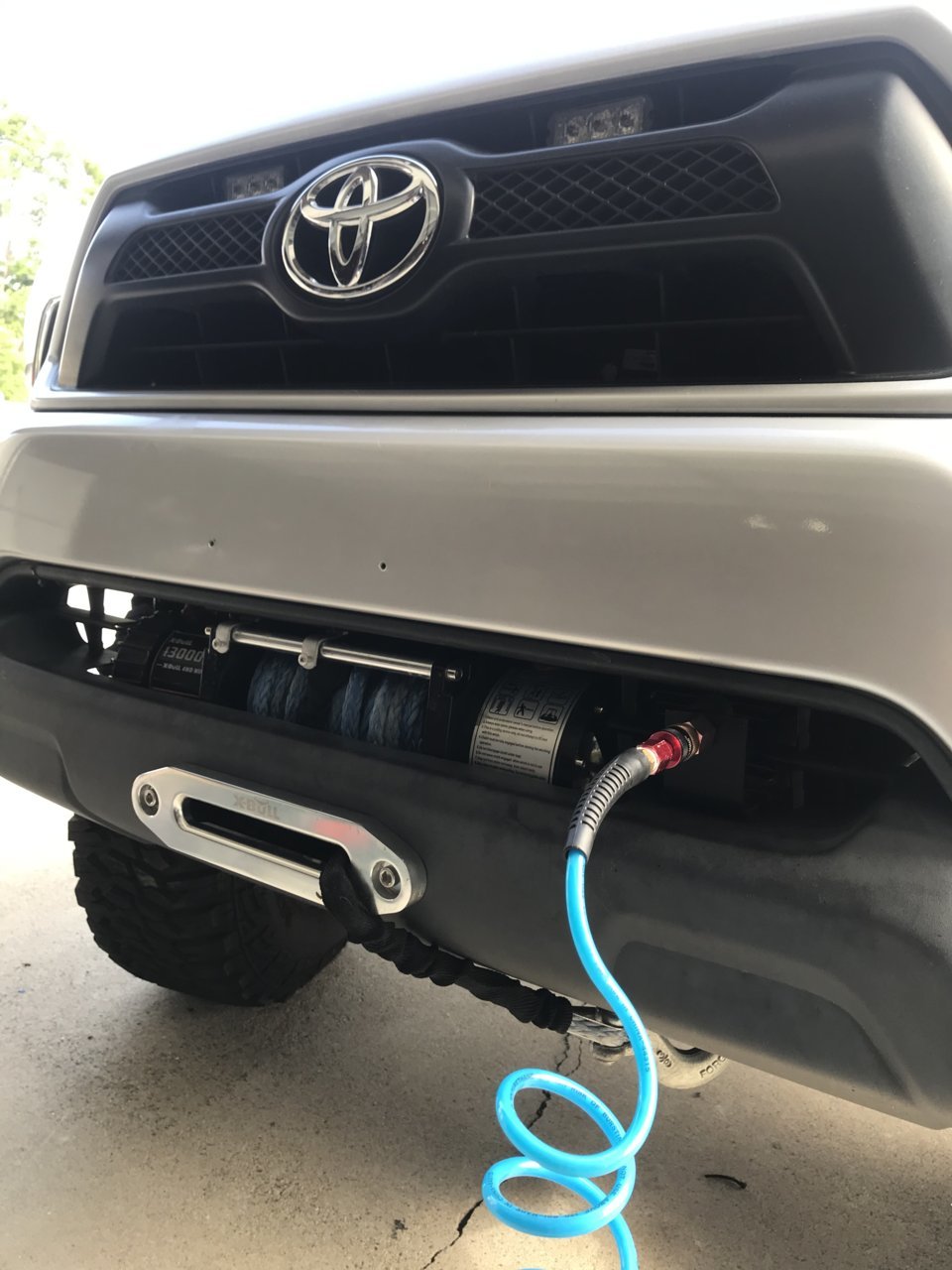

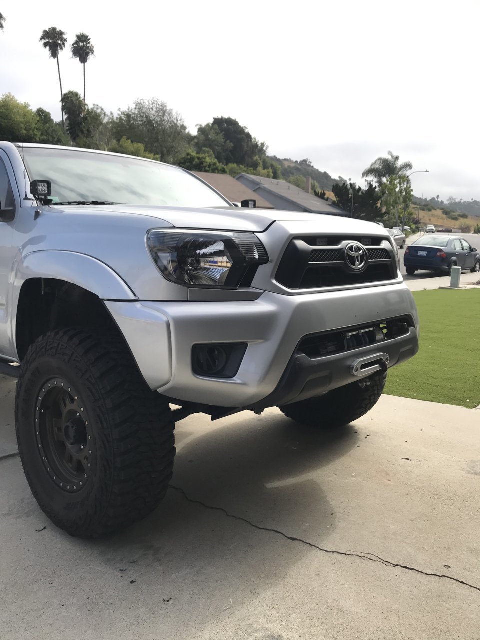

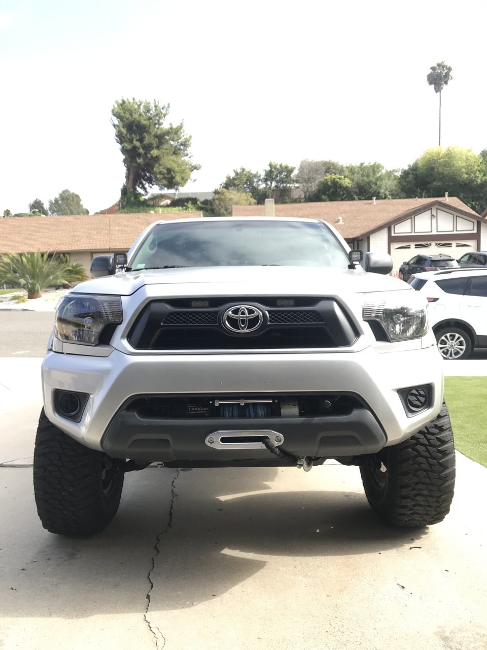

    Alright the conversion is done minus fog lights!
    F335C0D0-FAB3-4688-8D11-B5B0259AF85B.jpg 1F06A2D7-85A2-4D87-BAED-6F4AC21A896C.jpg BA0FD86E-7CAF-4CE4-80E2-719D5F9085E4.jpg 65BF1E78-F7F5-42EF-B7C3-C5F1423F9BC6.jpg 8FCFB42E-F1F1-4BB5-AAFB-305BC1A06C42.jpg

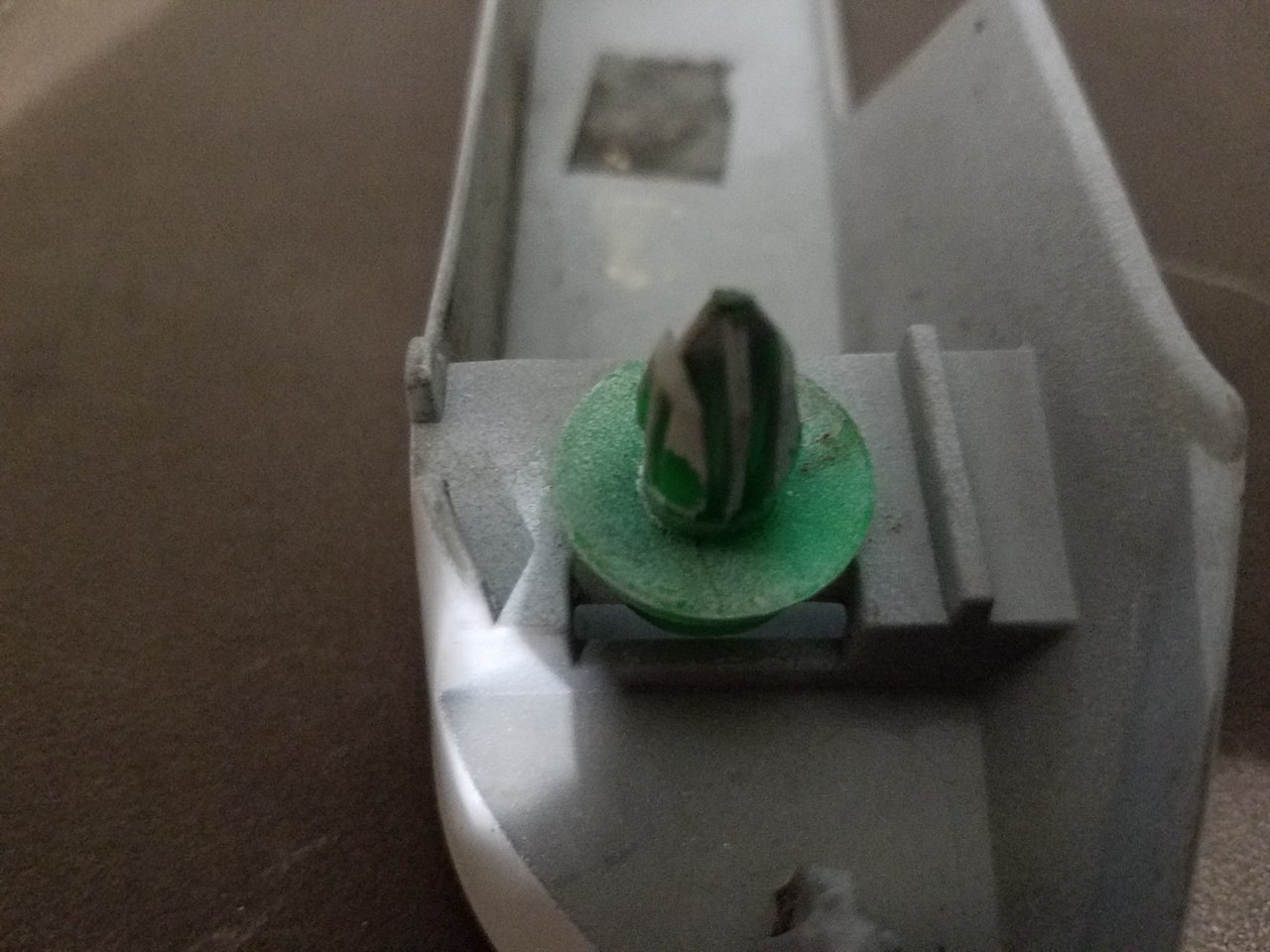

    Finished most of my conversion today. Had a couple of questions for folks that have done it:
    1. Did you end up replacing the plastic wheel well portion? Or just remove it?
    2. My headlight fillers are a little loose, but can't figure out what I may be missing. Anyone else experience this?
    3. What does the impact bar retainer bracket attach to? Right now, its just attached to the aluminum crash bar (middle of the bar)
    4. Would someone be able to send me a few pictures of the underside where the bumper attaches to the sides? Not sure what screw/tab I might be missing but it doesn't seem right to just use a plastic push-pin connector.

    When people put on bumpers they need to trim linner . If you can score trimmed piece just cut yours and fit newer piece in .Bumper filler you got black plastic retainer ?

    My headlight retainers don’t fit that great either. They popped out when I hit a huge dip lol

    Ok, interesting on the liner. It had some extra holes on the bottom for the previous year, so I wasn't sure. I can take a look at that.
    The fillers for me had a slot on one end, that fit into a tab under the headlight. The green piece was also there.

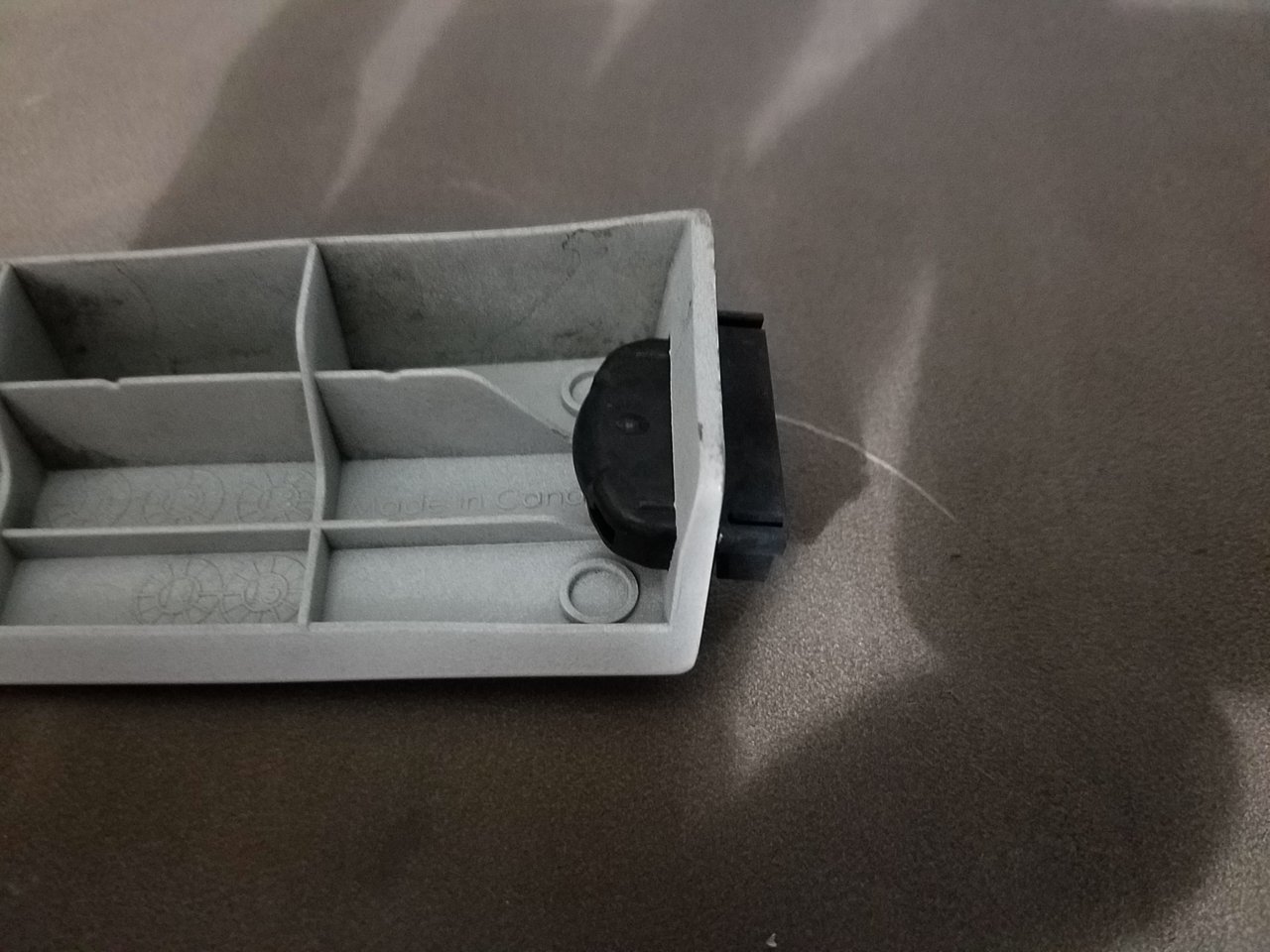

    Do you have the black clip shown in pic ?
  10. Aug 11, 2019 at 11:25 AM
    #430
    Foxtato
    Foxtato Well-Known Member
    Jan 24, 2014
    #121385
    404
    Puyallup, WA
    2011 Tacoma 4x4
    I do not. Whats the part number?

    I can look . Will post if I find it . Some were in this thread -I think .

    Bumper filler retainer 5393504020 . Need 2 . Got # from my invoice of parts I ordered

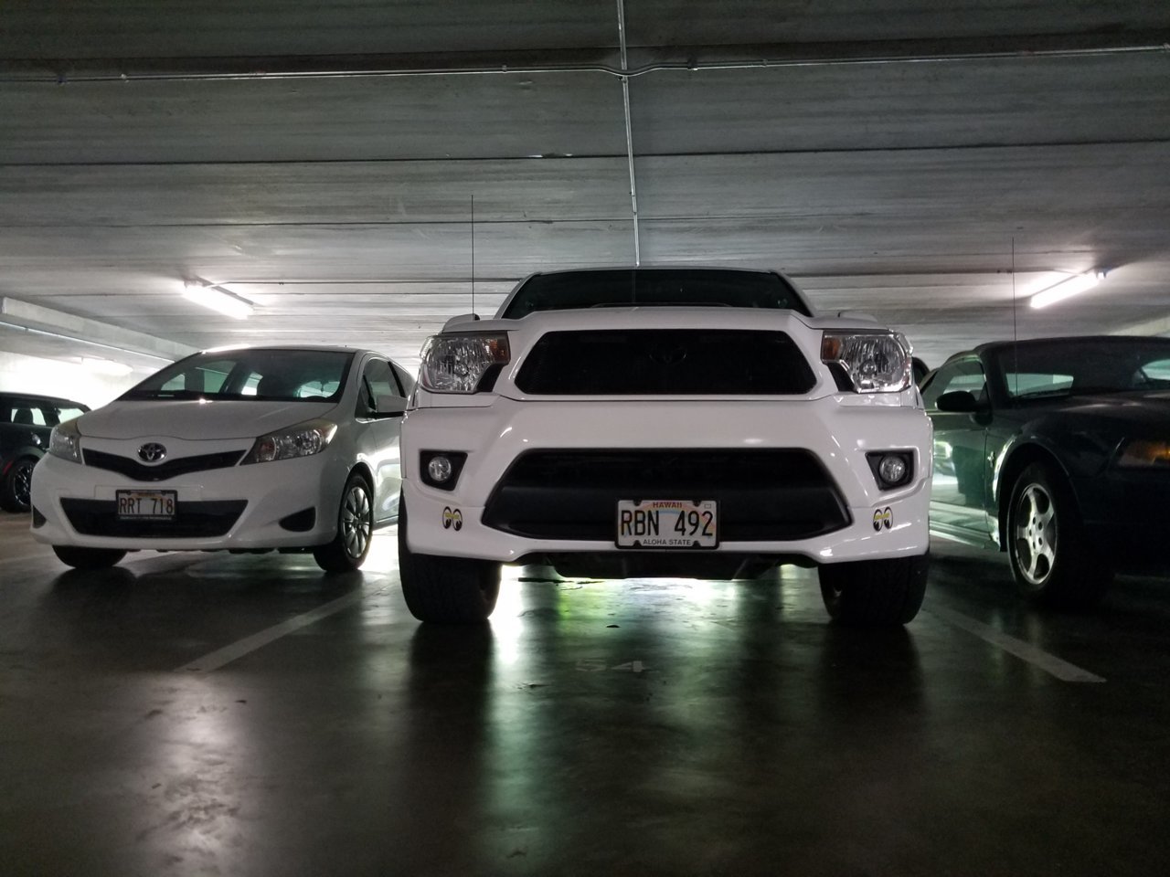

    Now time for to put a second coat of opti seal on my truck lol. Seems like good stuff
    I went a little different route on my conversion

    Awesome. Yep, just found them in the box of a few extra parts I didn't up needing. Time to take off those pieces and cram 'em on!
    Thanks for pointing that out!

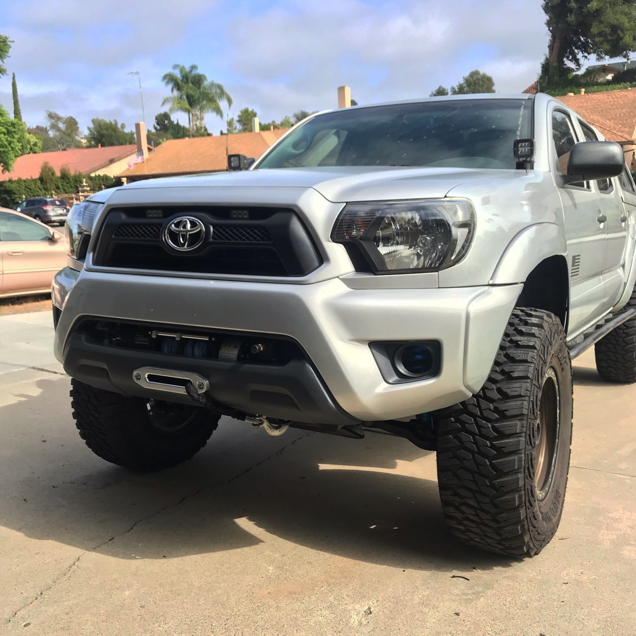

    Put the finishing touches on today and got some better pictures of the finished result.
    [​IMG] [​IMG]

    Ive been wanting to see an Xrunner frontend on a 6 lug! any more pics? thing looks unique!

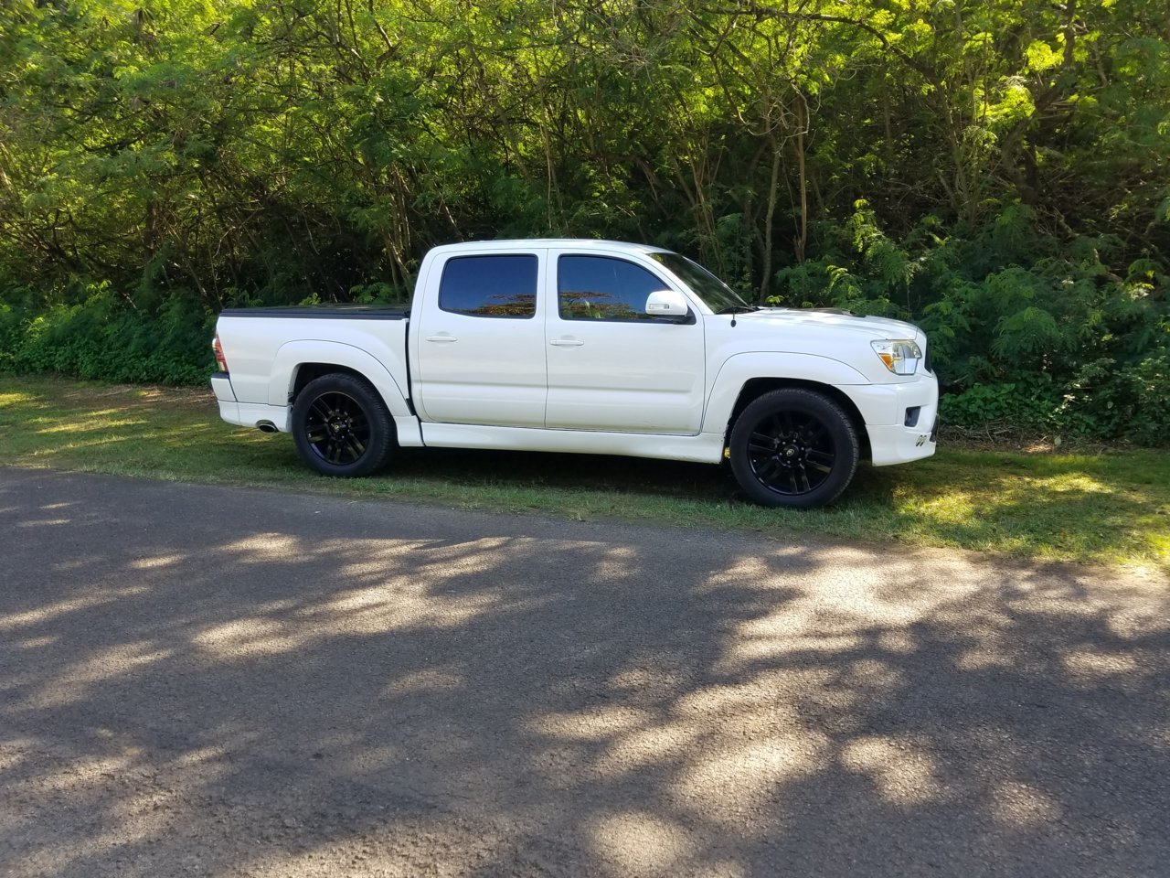

    Also went a different route on suspension .Lowered with Tundra Racing kit.
    Started working on this project last Nov then stopped . Kind of burnt out working on cars (retired from mechanics couple years ago) So haven't finished yet .Still debating if I want to.
