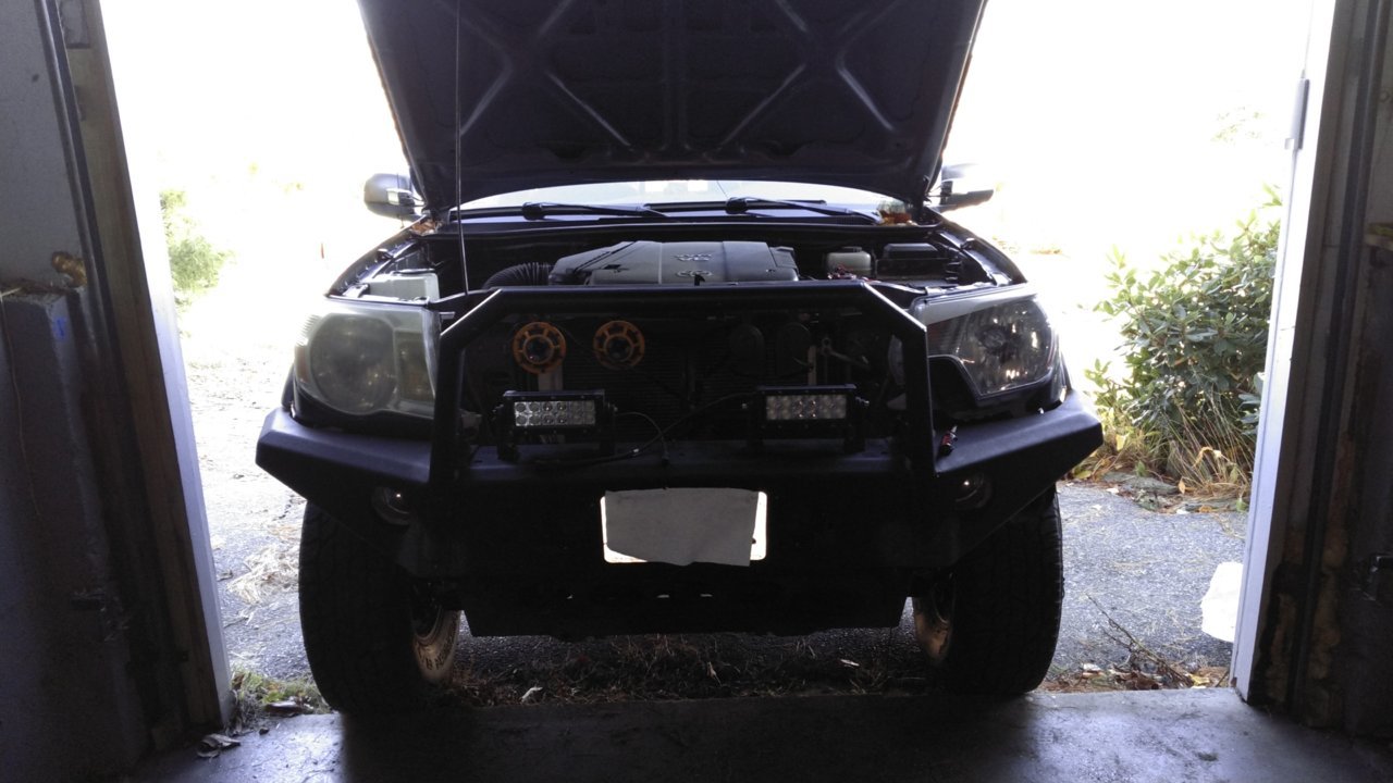

    I just did mine this weekend. I'll toss some pictures later.
    You need a new hood, lights, grill, bumper, bumper supports.

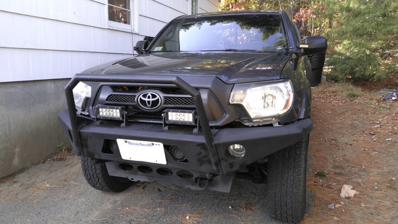

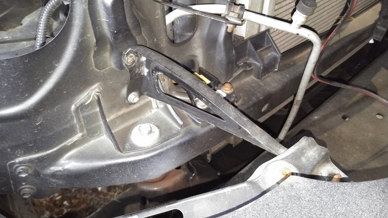

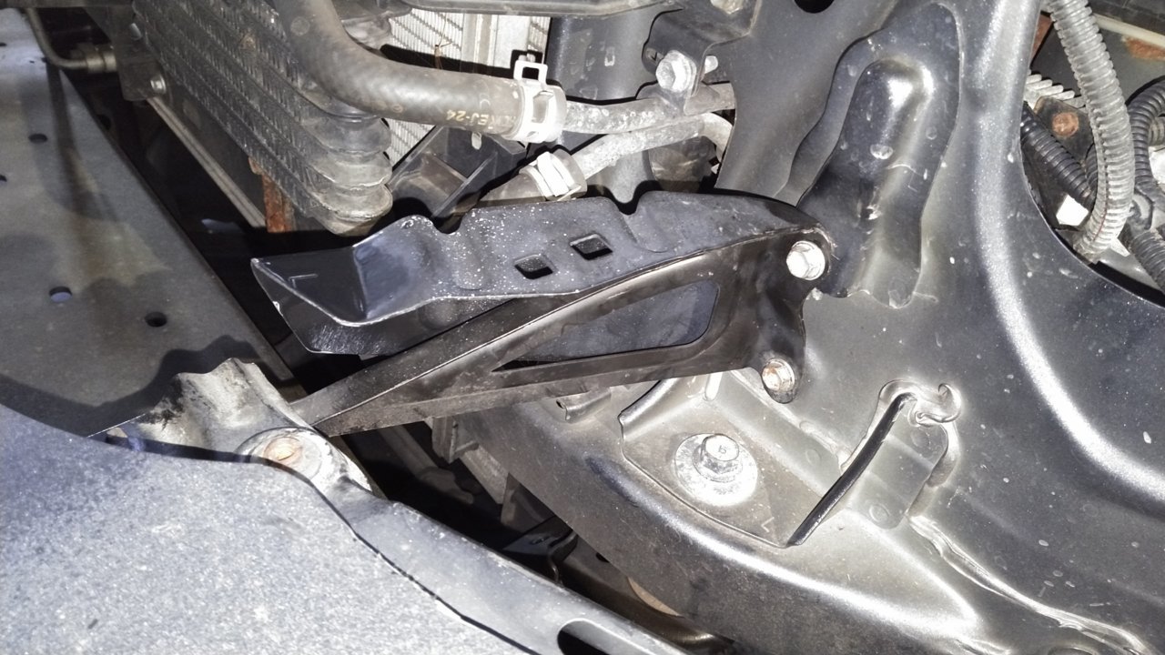

    Did mine over the weekend. Need to add fillers under the headlights, secure the bottom of the grill and color match the grill surround.
    Since the I still had all the 05-11 bumper support and an after market bumper, I just bobbed the two bumper support precipices that have headlight clips and bolted them under the current ones.
    For anyone interested, the last picture shows the fit of the 05-11 hood with 12-15 grill/lights.

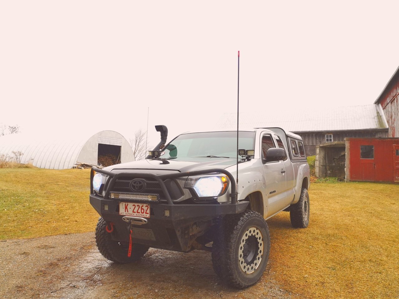

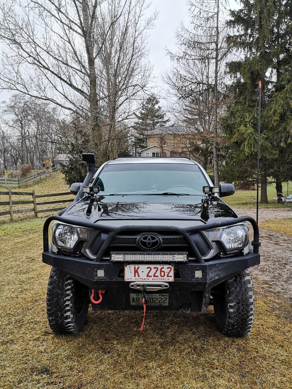

    Did you guy all have to swap out the hood latch for a 2012-15 one? Wondering if there's a way that I can make the 2008 latch work.
