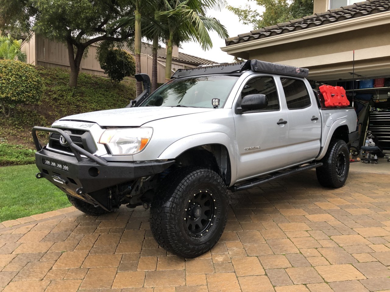

    Finally back from the body shop and I couldn't be happier. I also installed new wheels and tires so, I feel like I'm driving a new truck.

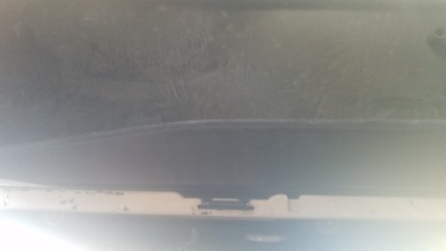

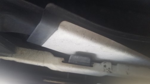

    The factory bumper is what secures bottom of grill. So guess if using aftermarket bumper would have to make some kind of bracket if you want to secure bottom . I'm guessing many have .
    Tabs on grill slide into top of bumper

    Oh cool. Thanks for that pic @hemitruk Gives me an idea of how factory connects to steer my custom jobber.

    Better pic
