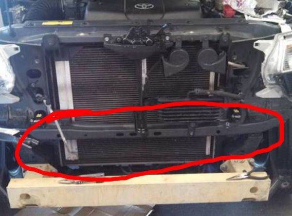

    Quick question, does the part underneath the grill to mount the bumper need to be replaced?

    If you not using stock bumper nope.
