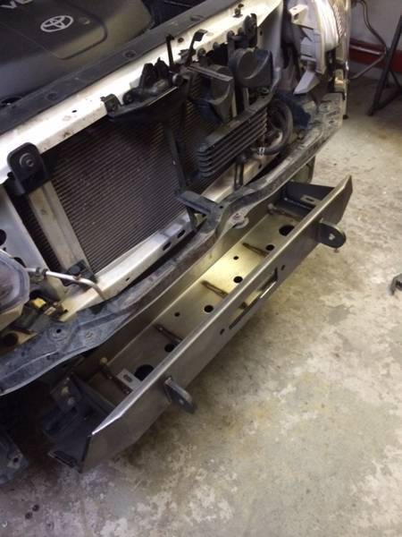

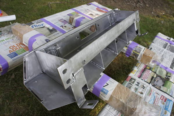

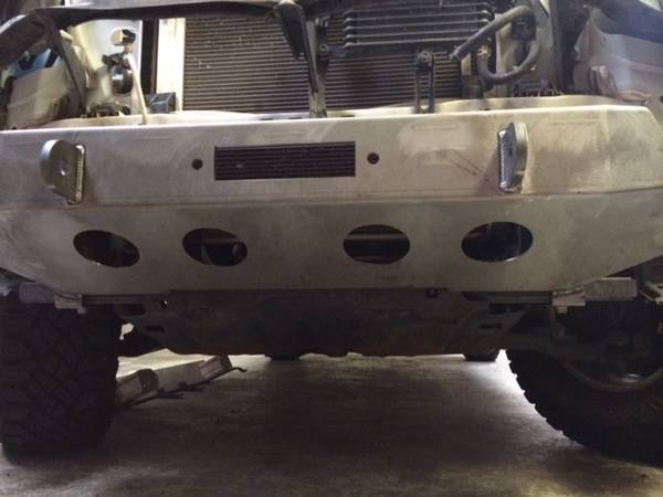

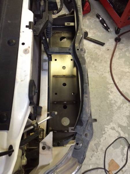

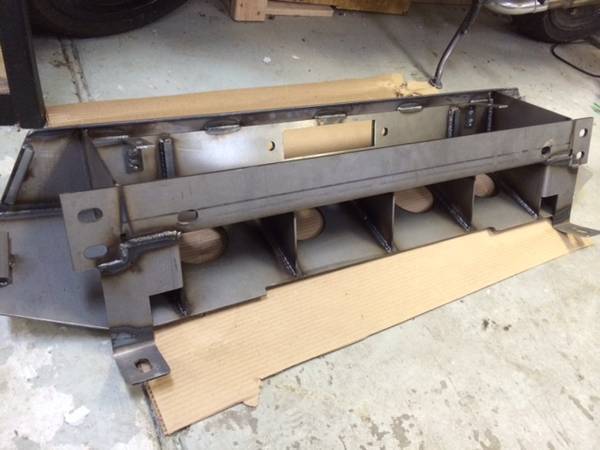

    Here are a few pictures of my test fit. It's off to get coated, then wait for the winch, then final install. This thing is extremely well built.

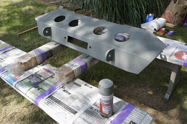

    Sanding and grinding complete
    2nd coat primer
    Painting Complete: Maybe mounted Labor Day weekend

    The measurement that is important from a winch fitment standpoint is the vertical space of the bracket in the center (just to the driver's side of where you are measuring) AND it's decreasing radius as it heads rearward.
    Looks good guys and thanks for the compliment. As I stated early in development I tend to over engineer a bit but I'd rather be guilty of that than build a flimsy POS. ;)

    Yeah I noticed that bracket, definitely going to be the limiting factor. With a winch like the Warn 9.5 (7.7" height in the middle) which has the solenoid off to the side I may not have to remote mount. Will find out soon enough!

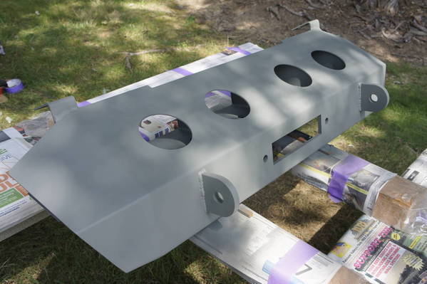

    Got it painted. Went with Rust-Oleum bed liner.

    Same stuff I used on mine. Looks good, wears well and easy to patch when you scratch it.
    Very nice!

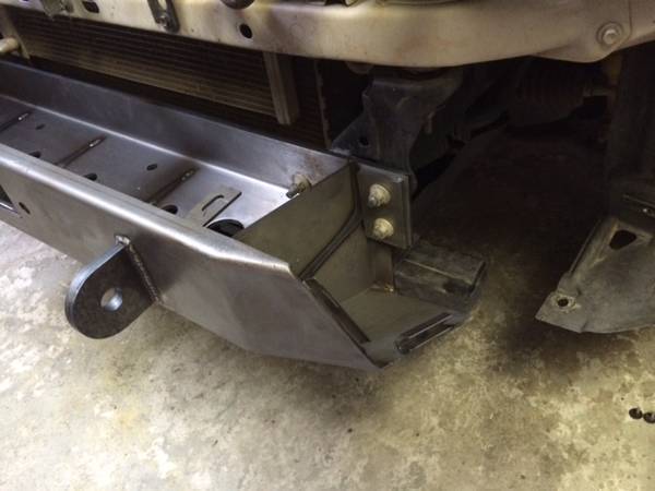

    Mine came in last night, but it was too dark to mess with. Took some pictures today. The packaging was only holding by a single bit of the tape. All the staples had come out. There were also a bunch of holes in the box and you can see the one large hole. There must have been an impact directly on that spot because it is right by one of the mounting tabs, and that tab is bent almost completely back. Not sure if I can bend it back without weakening the metal. The green pin shackles were also loose in the box and had obviously been bouncing around for a while.

    I'm reporting all of these to UPS. There is just no excuse to these being handled in this manner. The tab will be ok if you bend it back, it's mild steel and pretty forgiving. I hate that some of these are being damaged but if you feel like it's not something you want to mess with then I'll file a damage claim and get you another.
    I've shipped out plenty with zero damage and have made some changes to the packaging to compensate for their rough handling.
