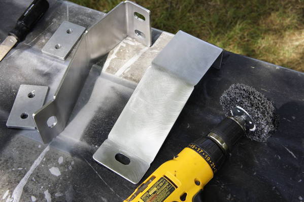

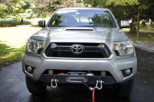

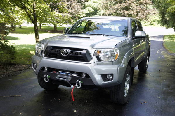

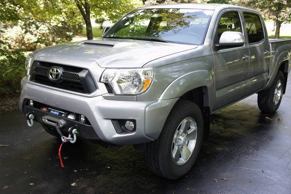

    Finished. Engo 10000S, Van "Beast" Shackles, Sirius light (1 spot, 1 flood) and US Off Road winch mount bumper.

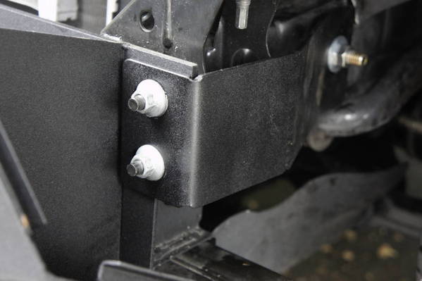

    The stock Toyota bumper mounts bothered me, they are made for compression not tensile force. I added bumper braces.

    Nice! Did you make the bumper brackets? Also, is that the stock suspension on the front? If not, what exactly are you running up front.

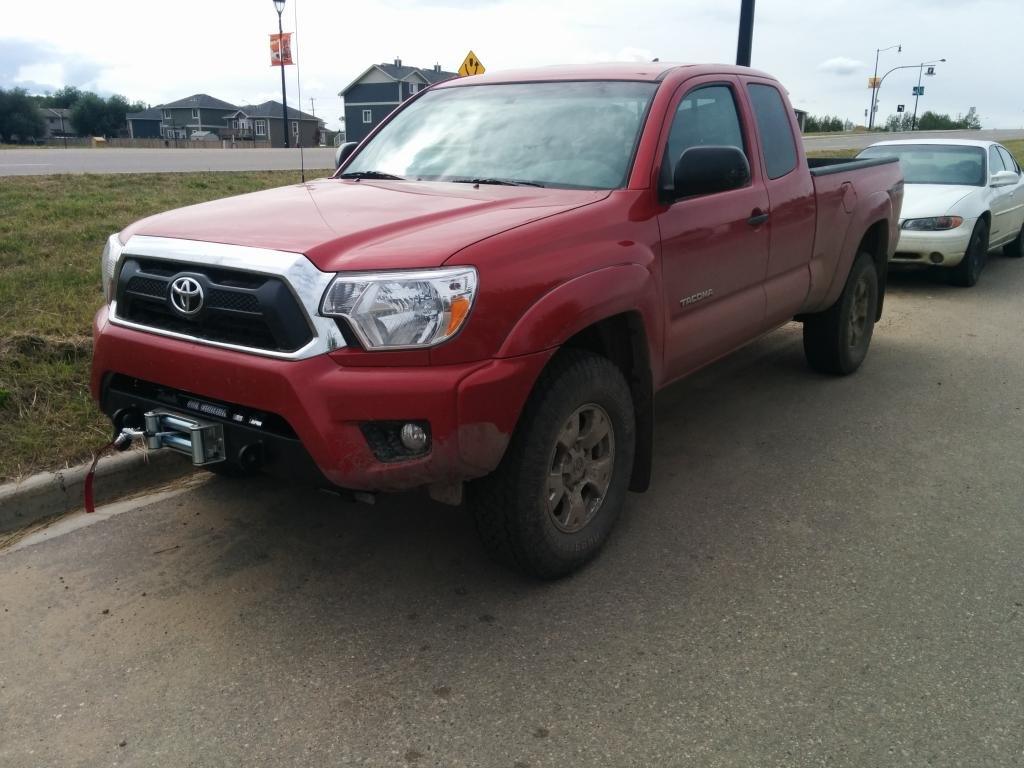

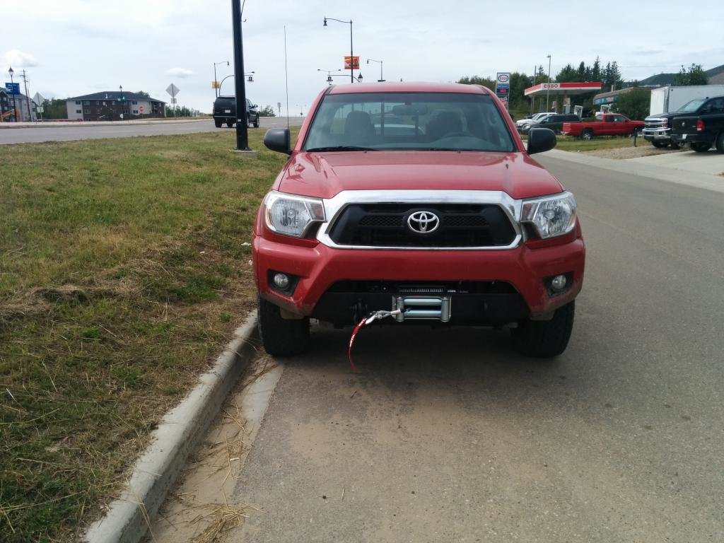

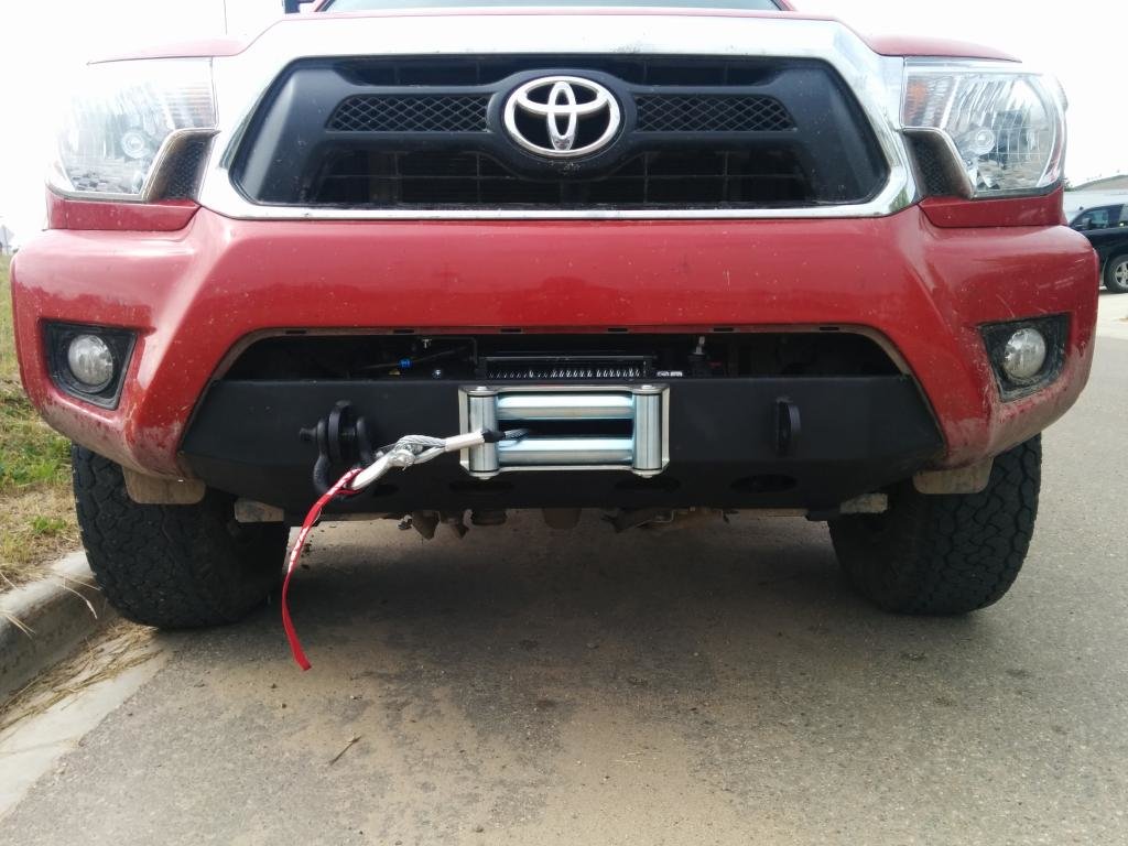

    Bumper all done and mounted.
    Currently sitting on the stock TRD Off Road suspension. Just got to get around to putting the skid plates back on now.

    A fellow cold laker!!! Where'd you pick up your shackles? Diggin the black but they are tough to find here, or did you have them coated yourself by someone? Hoping to put my bumper on next weekend.
