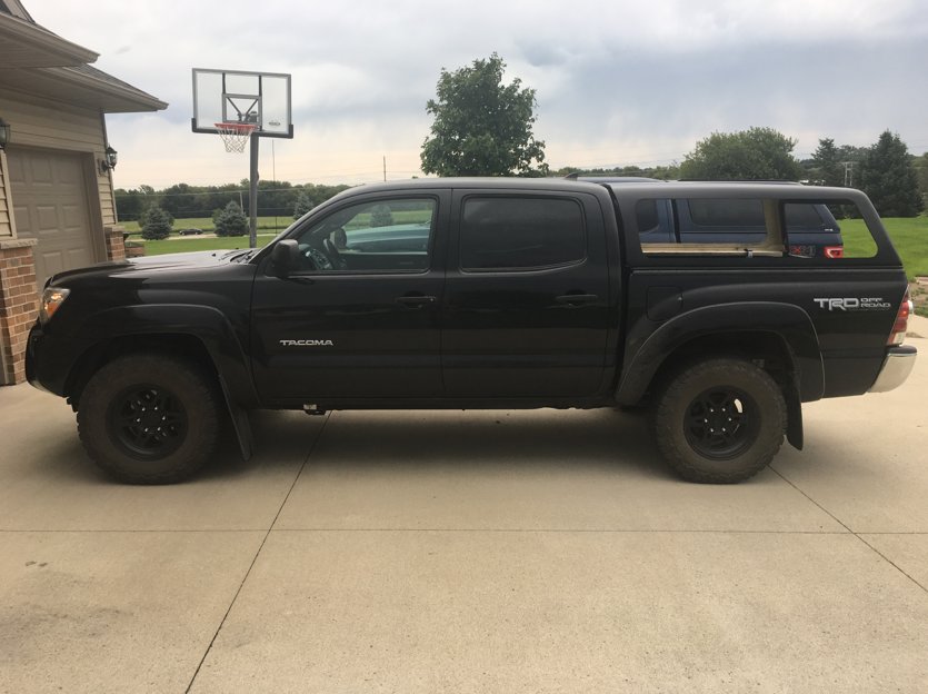

    2012 Tacoma TRD offroad
    OME lift, ARB bumper, topper

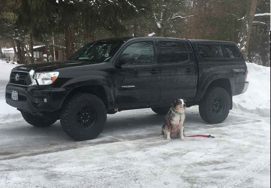

    Finally posting a build thread for my 2012 Tacoma TRD Off Road. Little late to the game as this is almost 5 years into the build but I would like to document the modifications and track it better.
    Current state:
    Wheels/Tires:
    • Recline renegade 16"
    • BFG K02 265/75/r16
    Suspension:
    • OME Nitrocharger 90021 soft ride
    • OME 887x coils in the front
    • Deaver single add a leaf in the read
    • SPC Adjustable upper control arms
    Armor:
    • ARB bumper
    • Stock TRD off road skid plates
    • Rok Blokz mudflaps
    Lighting/Electrical:
    • LED ARB fog light upgraded
    • Cheap ditch lights from Amazon
    • Cheap 9" driving lights from amazon
    • Auxbeam 6 gang switch panel
    Bed:
    • ARE topper
    • Yakama tracks
    • Bed rug
    • High lift jack bead mount
    • Unknown bed drawers
    • Unknown roof rack
    • DIY mounts
    • Maxi track awning from Napa
    Interior:
    • DIY phone mount bracket with ram mount phone holder
    • Husky floor liners
    • Center council divider
    • Carhart seat covers
    Coms:
    • Midland 75-822 CB radio
    • Firestick 3ft fiberglass antenna
    Camping:
    • 23zero double swag

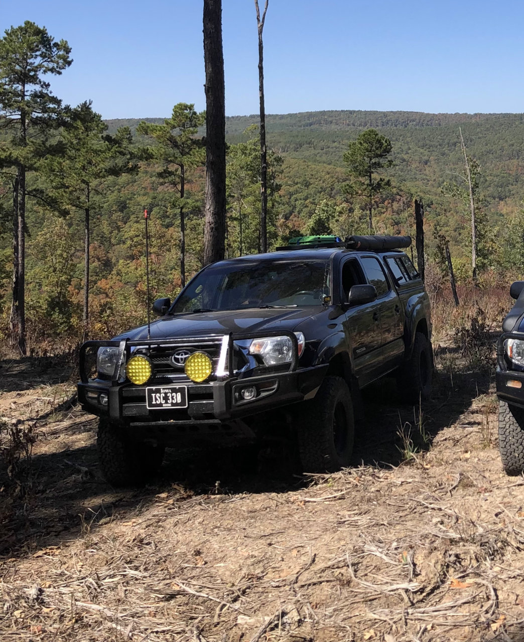

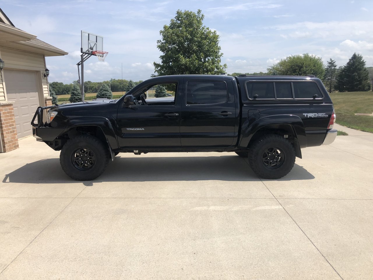

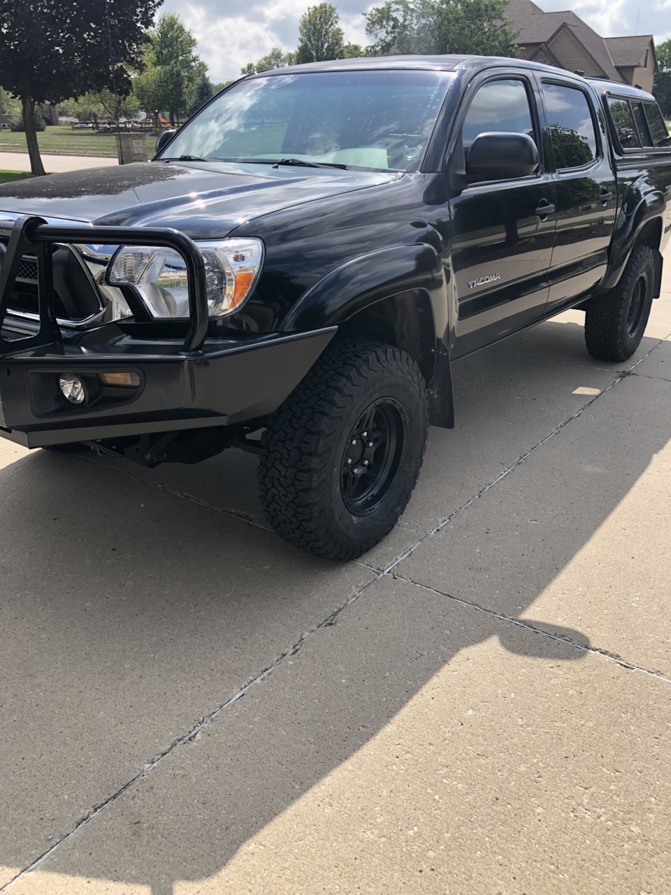

    Current Pic

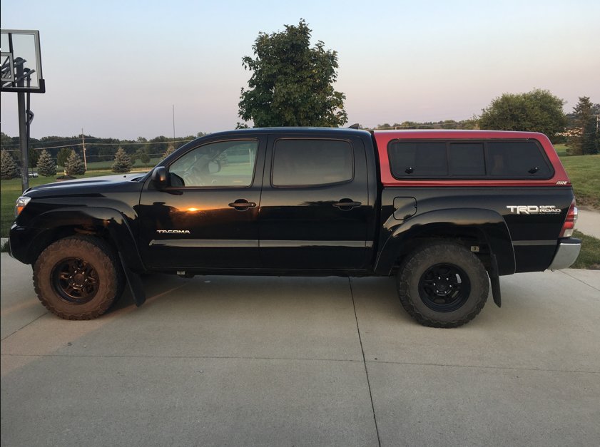

    Starting point:
    Road_Warrior likes this.

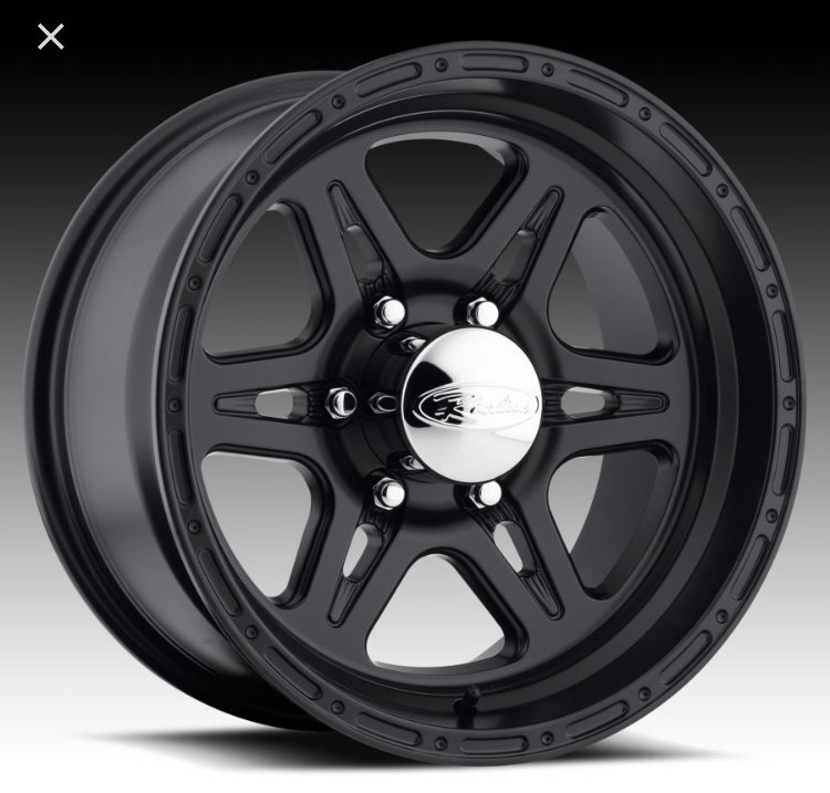

    Wheel upgrade: Raceline renegade 6

    Topper: Marketplace find
  6. Mar 18, 2023 at 2:11 PM

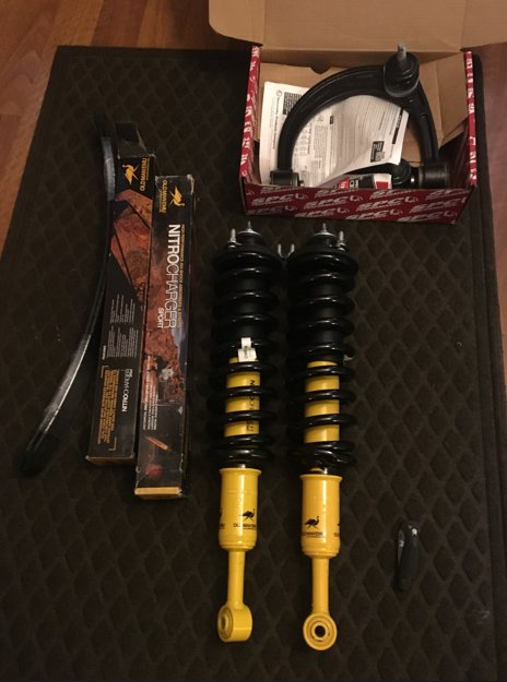

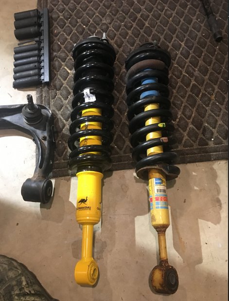

    Suspension upgrade:

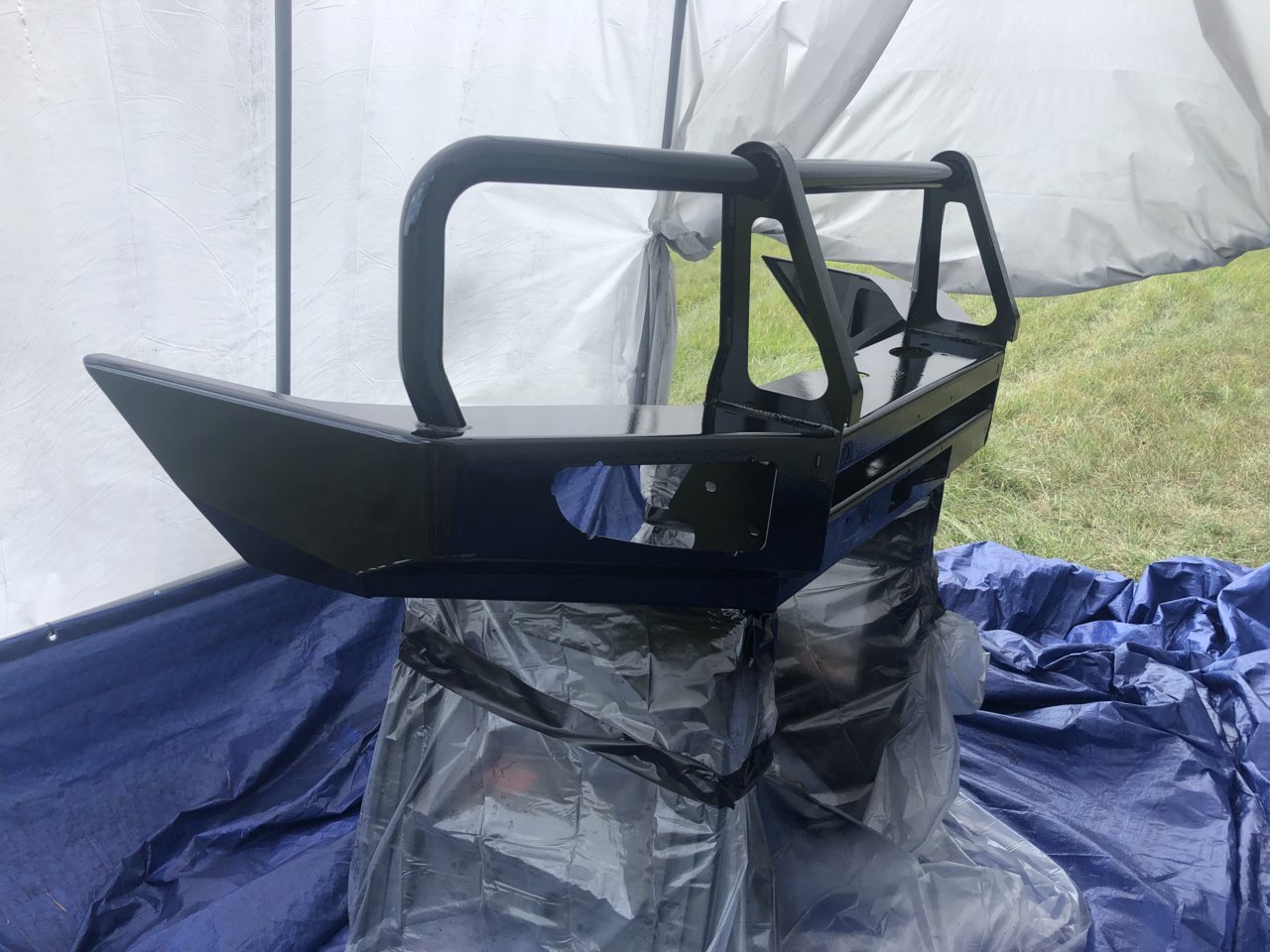

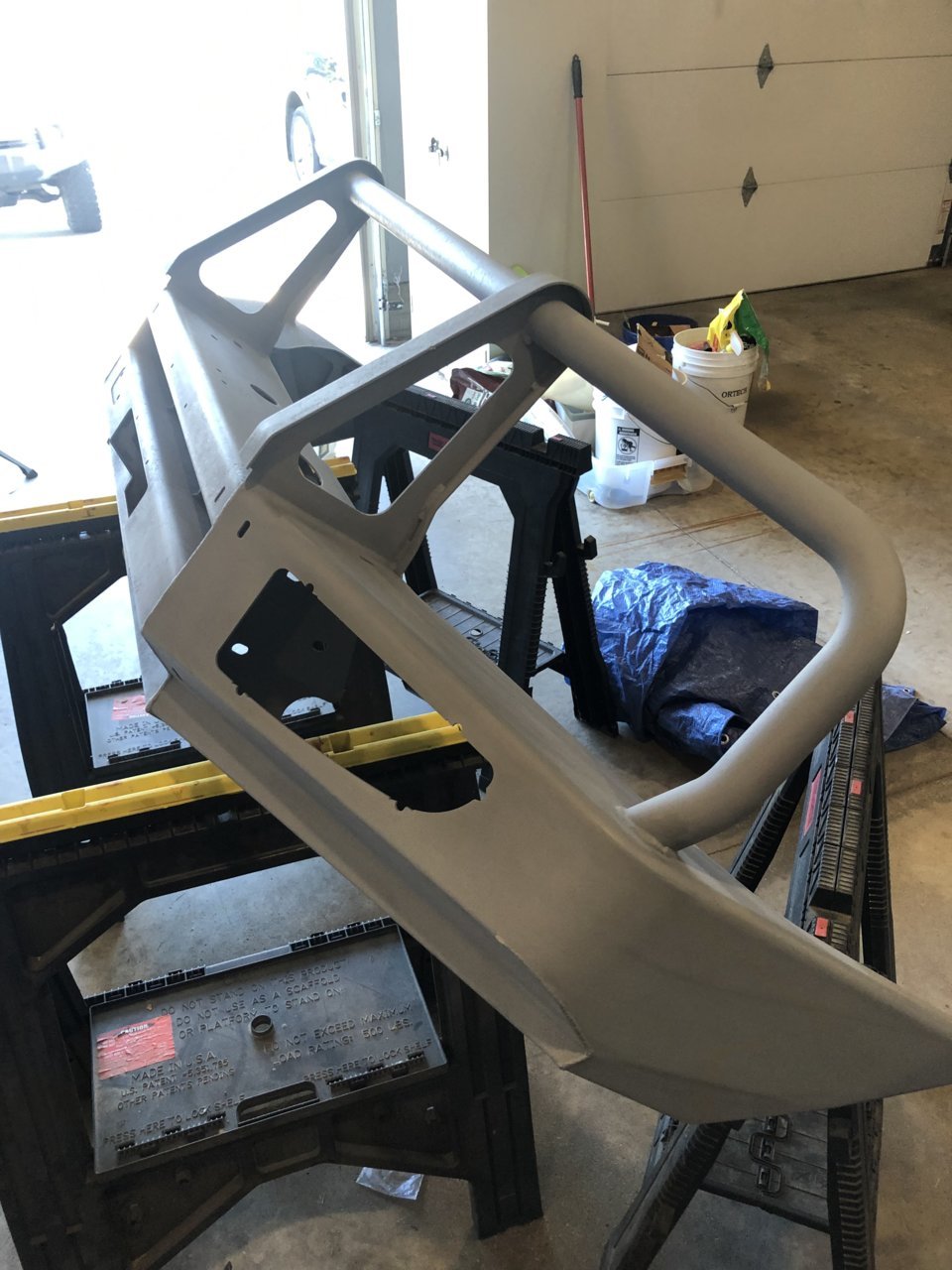

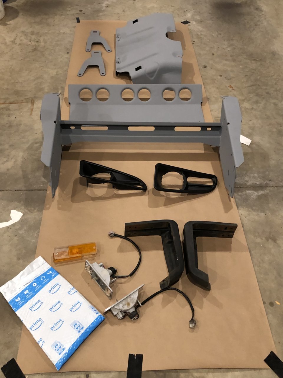

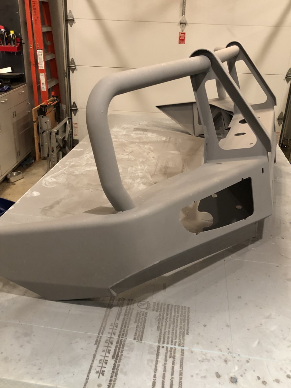

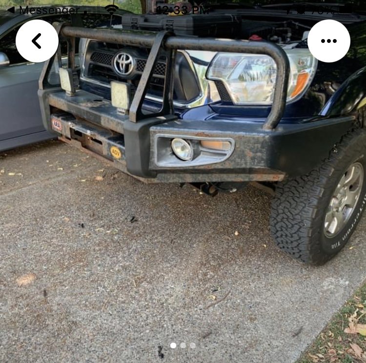

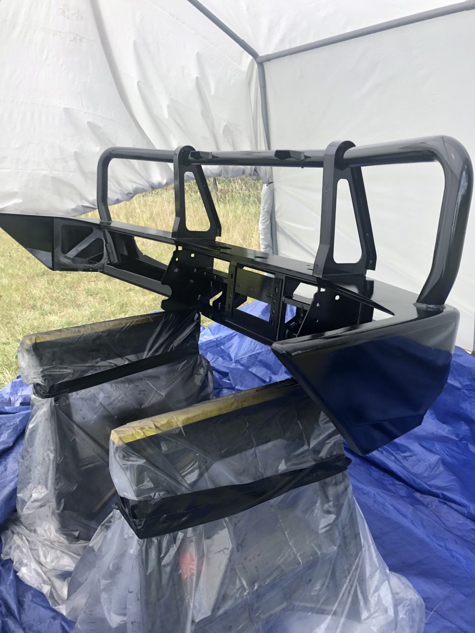

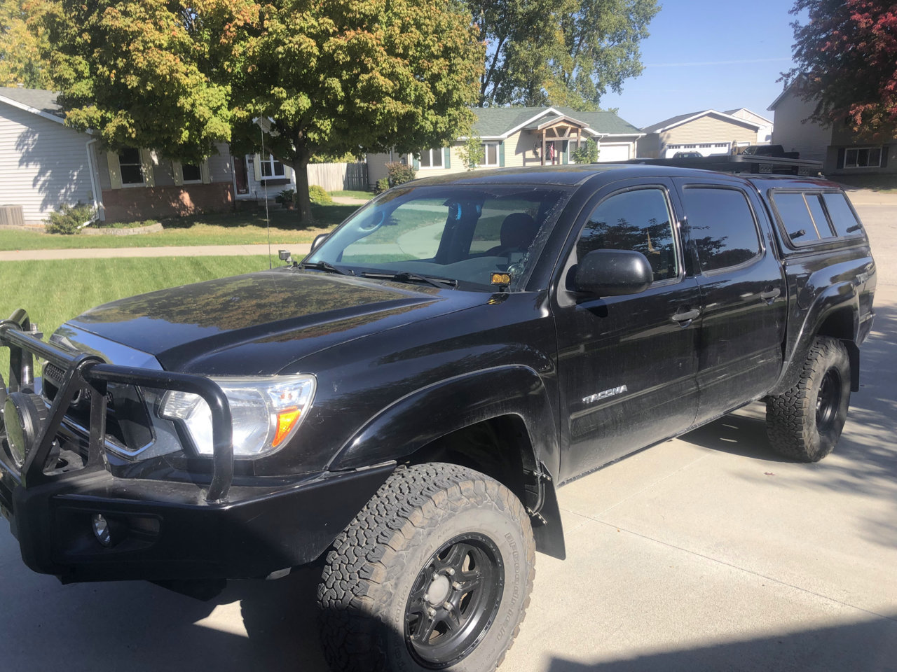

    Bumper: Marketplace ARB find
    Self etching primer used on all metal components
    Gloss black implement paint on the bumper
    Bed linner on the brackets
    Trim paint on the plastic housings
    New LED arb lights
    3M headlight restoration on turning signals lights

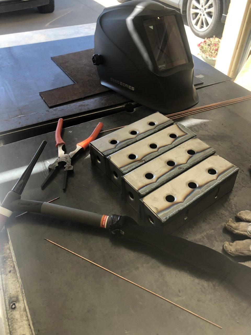

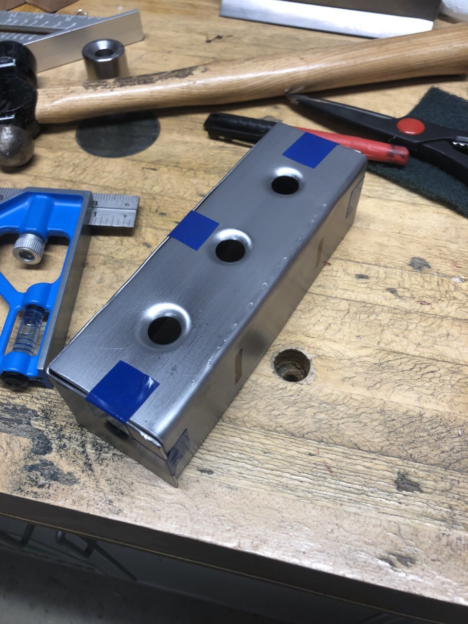

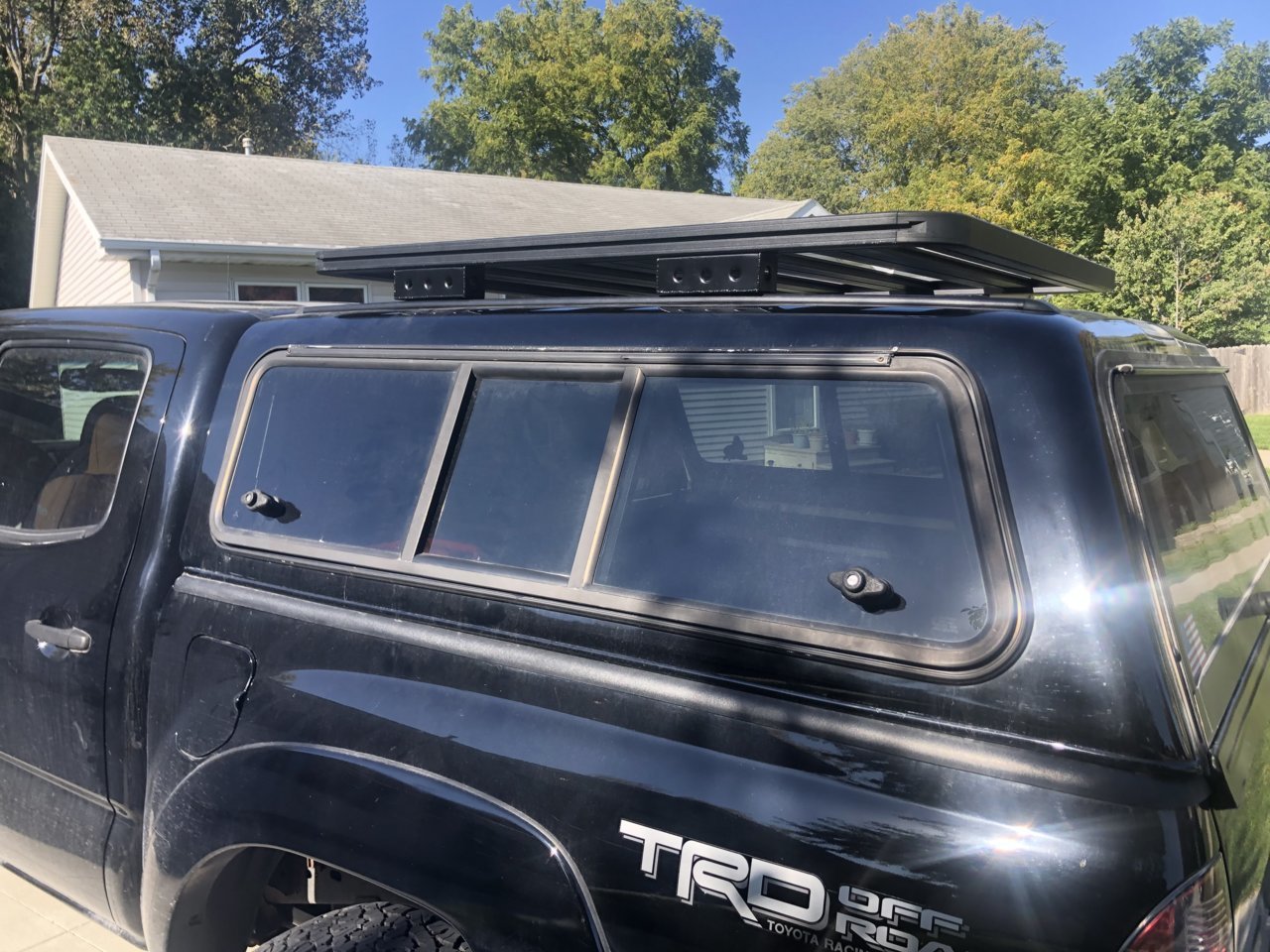

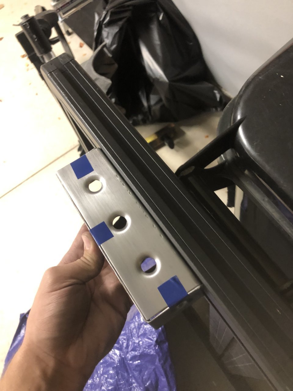

    Roof rack: Unknown platform rack with diy mounts
    Acquired a platform rack and needed to make mounts last minute before a trip to the Ozarks.
    Used Amazon dimple dies and bent them in a vise.
